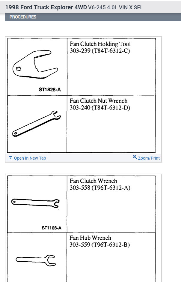

How do you remove the clutch fan?
1998 FORD EXPLORER
CRAZYJAY

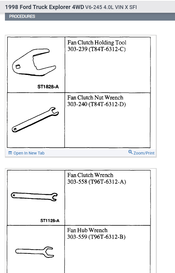

Jan 2, 2010 at 10:25 AM
SQM
  • 6,383 POSTS

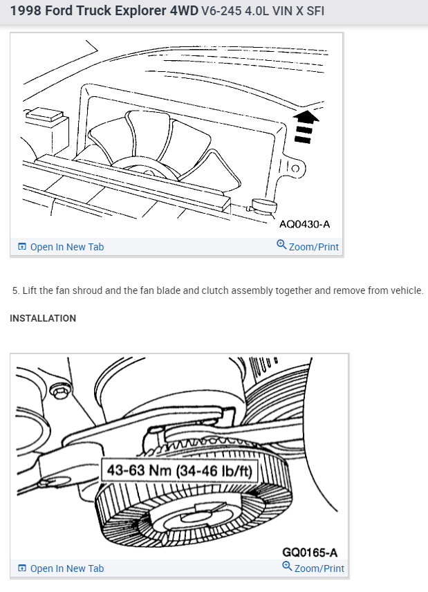

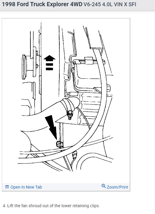

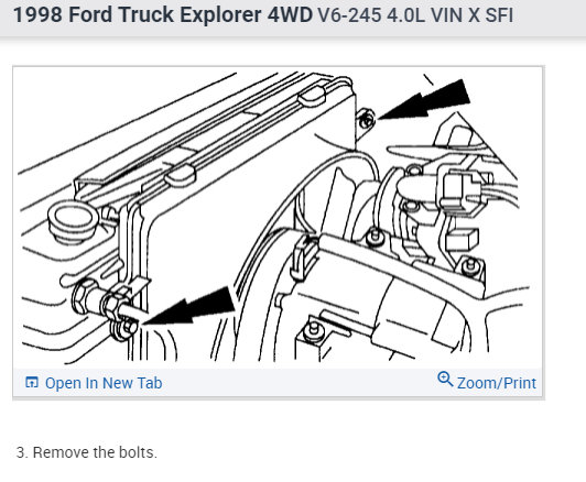

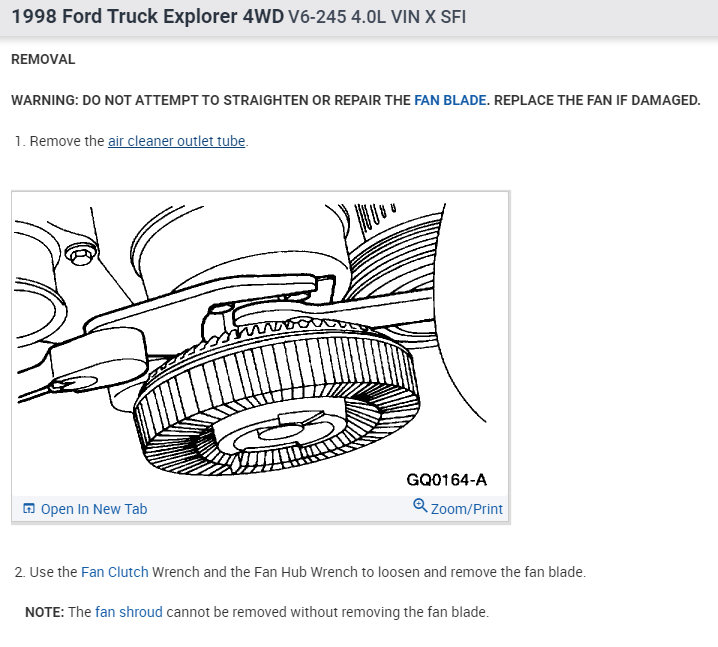

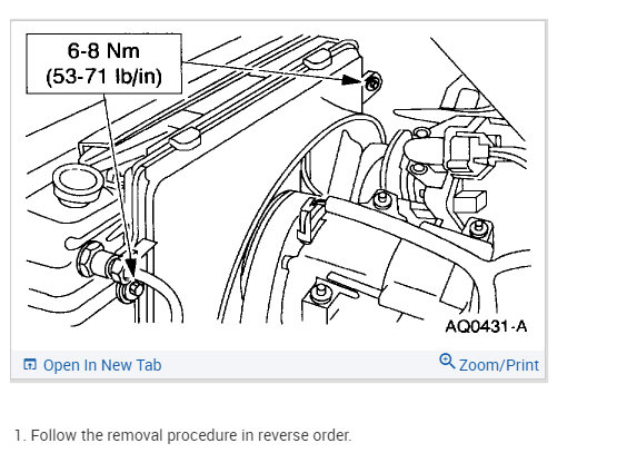

In order to replace the fan clutch you will need to use a fan clutch tool.
Here is a helpful guide:
https://www.2carpros.com/articles/fan-clutch-removal
I have attached diagrams for the replacement procedure below.
