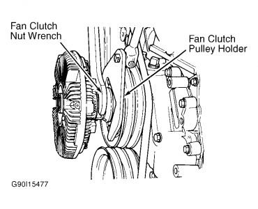

1996 Ford Explorer 6 cyl Two Wheel Drive
I have the removal tool for the clutch fan.I do not see where the (pins or screws go to hold the shaft from turning, while I loosen the collar nut. Help me if you can. Pictures are nice also.

Hi there,
Thank you for the donation.
Looking at Mitchell 1 data base, on this model there are 2 tools required to unscrew the clutch, the thread is Left handed as well see pic for a better idea as to what is needed.
