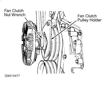

I need to change my water pump and I can get the clutch fan off. How do I get the fan off?

WATER PUMP
Removal
Remove negative battery cable. Drain cooling system. Disconnect lower radiator hose and heater return hose from water pump. Using Fan Clutch Pulley Holder (T84T-6312-C) and Fan Clutch Nut Wrench (T84T-6312-D), remove radiator fan and clutch assembly. See Fig. 9 .
CAUTION:Fan clutch nut has left-hand threads. Remove nut by turning it clockwise as viewed from front of engine.
Remove alternator drive belt. If equipped with A/C, remove alternator and bracket. Remove water pump pulley. Remove water pump bolts, and remove pump. Remove gasket.
Installation
Clean all gasket surfaces. Apply sealer to both sides of NEW gasket, and position gasket on water pump. Install water pump. To complete installation, reverse removal procedure. Fill and bleed cooling system. See COOLING SYSTEM BLEEDING
https://www.2carpros.com/forum/automotive_pictures/266999_exp_4.jpg
