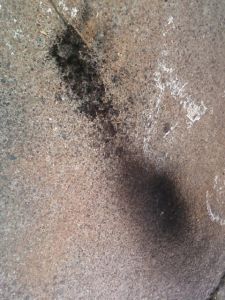

my 94 ford explorer when started will idle low 200 - 600 for a second then turn off if i keep my foot on the gas in netural it will stay running then will run fine for a few then start back to running rough around 200-600 rpms then die unless i keep my foot on the gas in netural idleing around 900- 1500 rpms when idleing but not all the time black smoke (siut) out of the exhaust ?? plz help!!!!
https://images.2carpros.com/forum/automotive_pictures/521213_smoke_1.jpg

Is the check engine light on? This happens when cold? Or all the time, even after re starting a hot engine?
May 30, 2020 at 4:37 AM (Merged)
DREAMER81080
yes the light is on when the problem occurs it does it most the time cold or hot it will restart right after it dies . this problem just started a few days ago

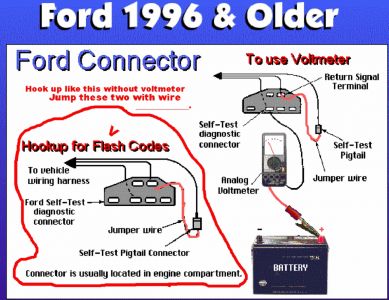

First step is to read the codes, Autozone does it free, then post codes found here. Or try to read the codes yourself: Jump the two termnals shown together and turn key to "ON" and count the flashes... a 22 will flash as 2 flashes then a short pause, then 2 flashes, if more than one code is stored, the pause will be longer. The codes will display three times and end with 11 or 111. Write them down and post here. First do this with the key on engine off, then again with it running.
https://images.2carpros.com/forum/automotive_pictures/62217_OBDI_Connector_1.jpg
DREAMER81080
okay i will try that .
