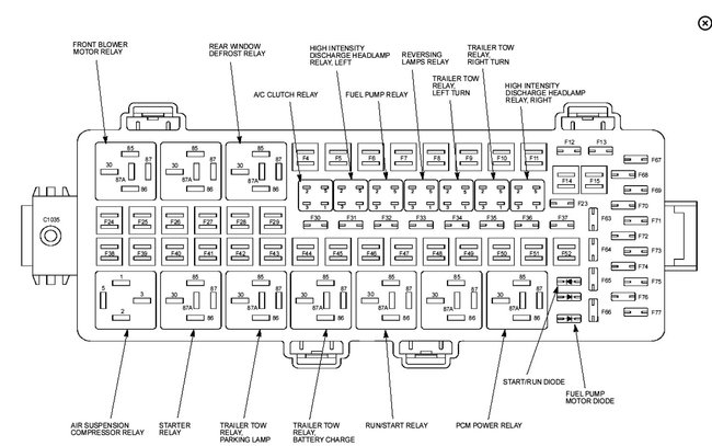

It has to be a bad relay. However, you need to check the motor when it does not run to see if there is power to it.

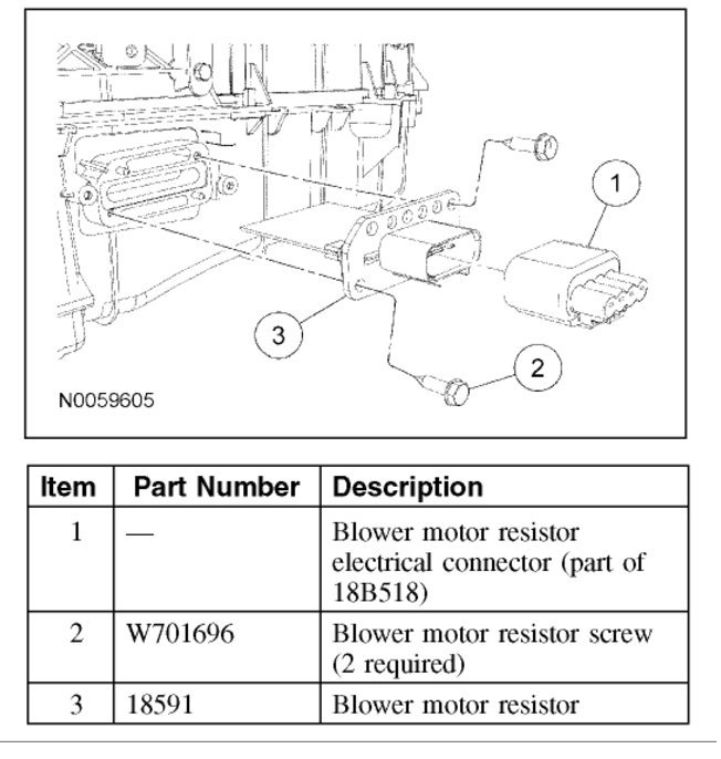

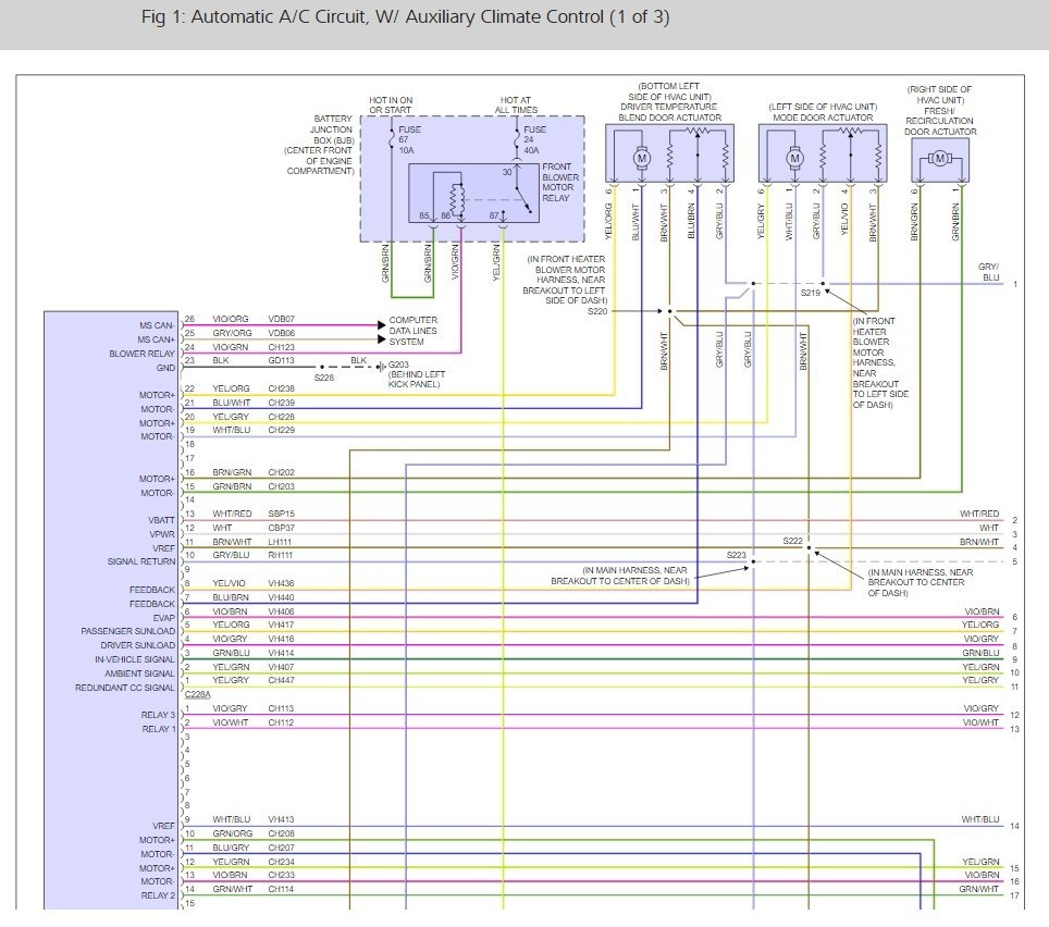

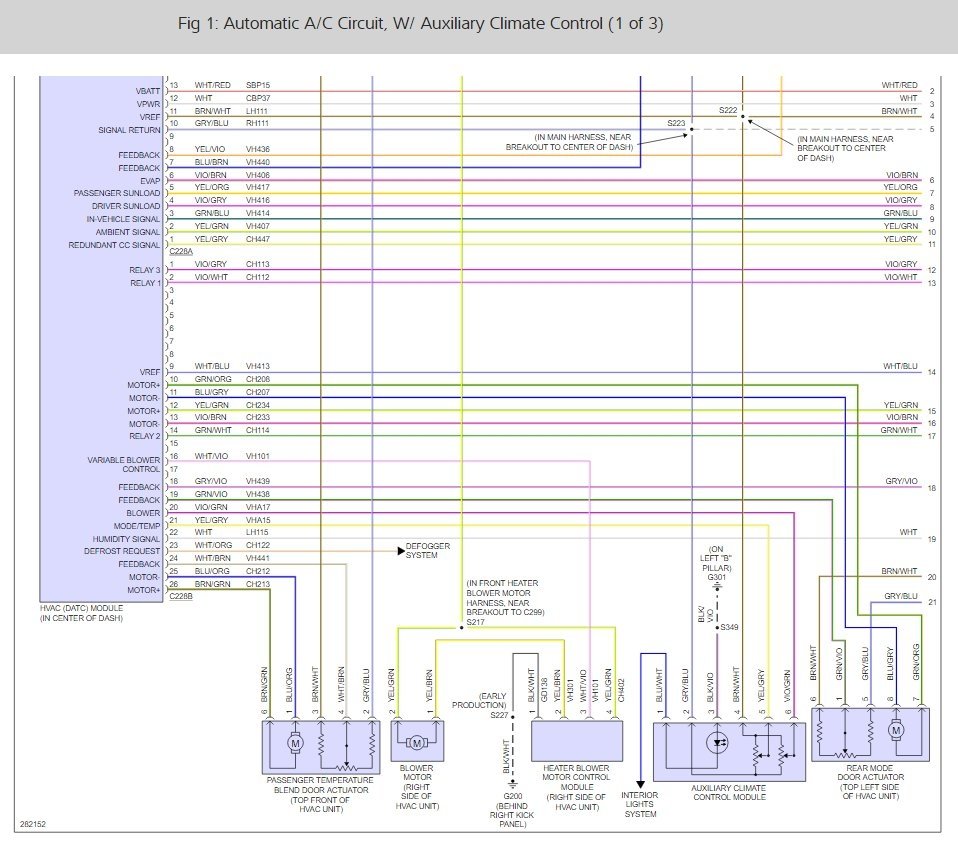

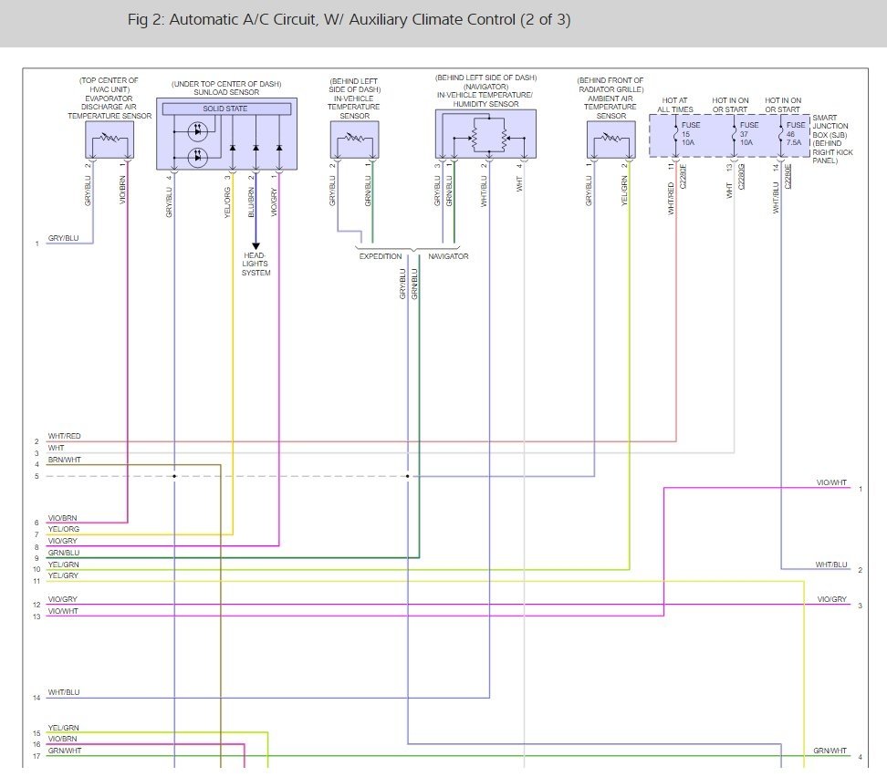

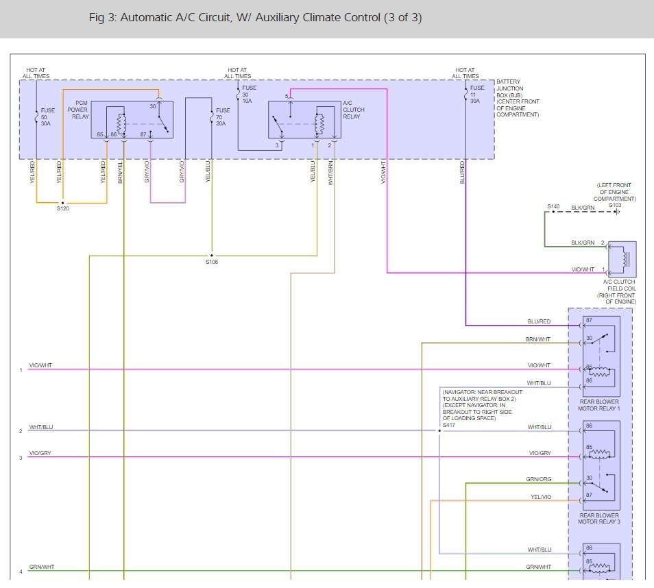

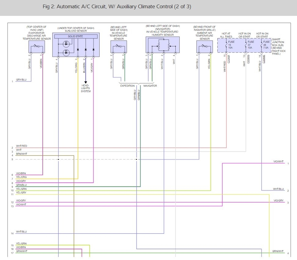

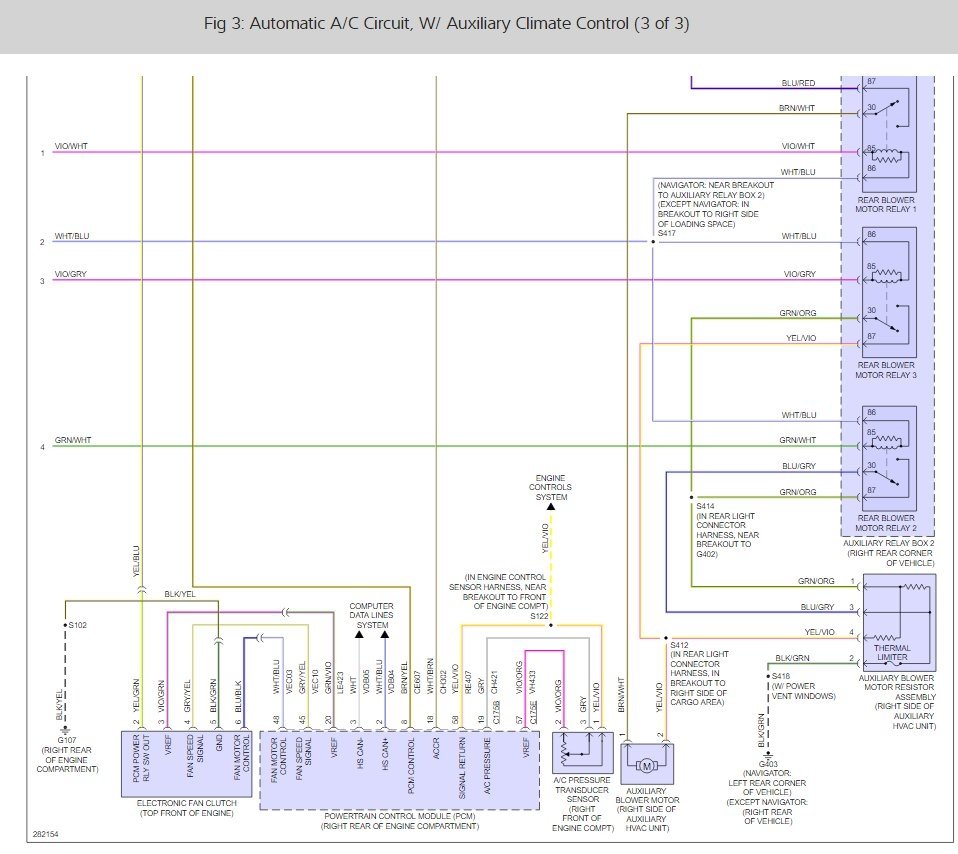

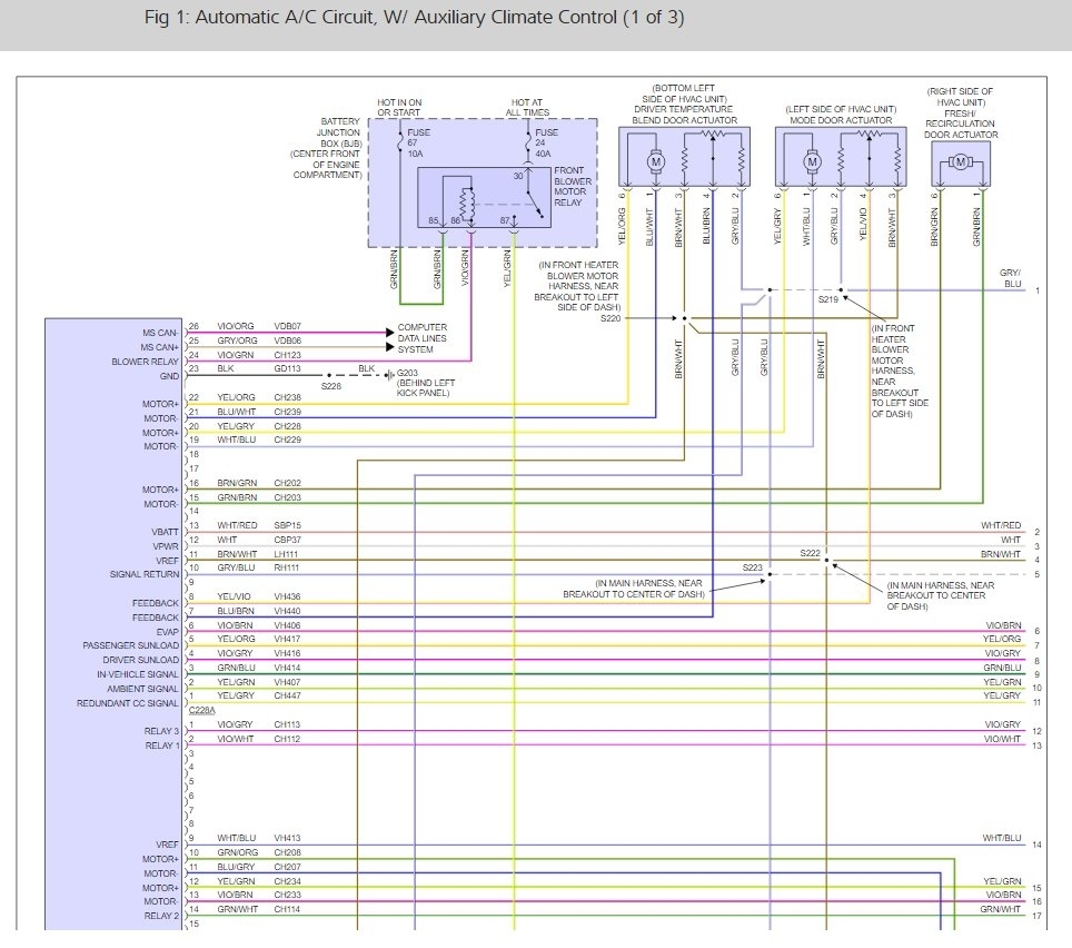

Two things come to mind for this problem. First is the blower motor controller itself is going bad which you can confirm by flowing this guide.
https://www.2carpros.com/articles/blower-fan-motor-works-on-high-speed-only
Here are some wiring, relay and component diagrams (below) to help you do further testing and get the problem fixed:
and
Please run some tests and get back to us we are interested to see what it is.

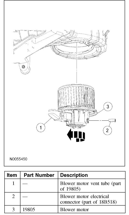

Just to add to the discussion. I have a 2008 Expedition EL and was having the same issue. After troubleshooting following your advice, I ended up at the blower motor under the passenger side dash. I noticed condensation on the black duct-work which I assume is from lack of air circulation. Anyway, the blower was not turning until I hit it. It then began to spin and I had cold air. This lasted until I turned the engine off and restarted the next day. No air. Wiggled and hit the motor until it started to turn. Reminds me of brushed motors in radio controlled cars. Once they are spinning, they will continue to spin. However, once they stop, the brushes can prevent restart until they are "helped along." Anyway, just ordered a new motor from amazon for $50.00. For those interested, the motor is just held in place by the housing which is twisted in place. Quarter turn counter-clockwise and it falls out.

I was having a similar problem with my 2008 Expedition LX KingRanch. The rear blower worked fine, but I was having intermittent blowing from the front blower. When the blower DID work, it worked as expected. It was either all or nothing.
I replaced the blower resistor but it did not fix the problem. I tested both the old and new resistors with an ohm meter and they were both fine. I tested the connector to the resistor with a volts meter and it was fine. I then went to test the connector to the blower to see if it was getting power and this is when I discovered the true problem.
Upon loosening the blower and removing it, it started spinning, much to my surprise! At this point, I know that it was either a loose blower connector or a bad/faulty blower. In my case, it was a bad blower. There was a dead spot in the bushings. There is a little access cover that you have to remove to drop the blower. Until I was able to replace the blower, all I did was (with the power to the blower turned off!) Reach my finger into the access cover and advance the blower a little bit off the dead spot. ShaBAM, it would work fine. Until I shut it off on a dead spot again.
The take away is, if it is not a resister problem, check your blower to see if you have a bad connection or a bad/dead spot in the blower bushing.
