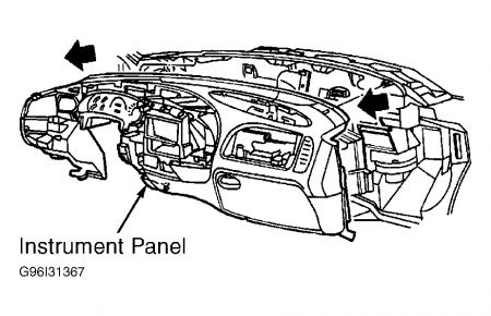

DANEGARDENHIREAIDEN
air conditioner leaking whatsmells like radiator fluid inside cab underneath cup holder. how do i take appart dash to find and fix theproblem
Apr 26, 2019 at 11:59 AM (Merged)
DAVE H
  • 13,384 POSTS
this is coolant leaking from the heater core ?? big job i'm afraid ? HEATER CORE Removal & Installation (Front A/C-Heater System) Disconnect negative battery cable. Drain radiator. Remove instrument panel. See INSTRUMENT PANEL . On 5.4L engines, remove junction block splash shield. Disconnect cable ends from starter relay. Remove junction block bracket. On all engines, compress heater core hose holding tabs. Disconnect heater hoses at heater core. Remove A/C plenum demister adapter screw. Remove A/C plenum demister adapter. Disconnect vacuum line. Remove 2 heater core bracket screws. Remove heater core bracket. Remove 13 screws from plenum assembly top. Remove plenum assembly top. Remove blend door assembly from case. Remove heater core. To install, reverse removal procedure. Tighten bolts to specification. See TORQUE SPECIFICATIONS . INSTRUMENT PANEL Removal & Installation Disable air bag system. See AIR BAG SYSTEM SAFETY article in GENERAL SERVICING. Move power seats rearward (if equipped). Move adjustable pedal to full forward position (if equipped). Release mounting tabs and position power distribution box aside. Remove 3 bolts and remove bulkhead electrical connectors in engine compartment. From inside vehicle, remove bulkhead electrical connector insulator and unclip bulkhead electrical connectors from dash panel. Remove front center floor console (if equipped). See FRONT CENTER FLOOR CONSOLE . Remove lower steering column cover. Remove valance panel. Disconnect Restraint Control Module (RCM). Disconnect blend door harness connector. Disconnect climate control panel vacuum harness connector. Remove left and right sill plates. Remove left and right door opening scuff plates. Move left and right door weatherstrip seals aside. Remove left and right "A" pillar lower trim panels. Remove left and right side assist handles. Remove left and right windshield garnish moldings. Disconnect brakelight switch electrical connector. Disconnect adjustable pedal motor harness connector (if equipped). Remove radio and Generic Electronic Module (GEM)/Central Timer Module (CTM) ground bolts. Disconnect left side main wiring harness and bulkhead connectors. Remove steering column opening cover reinforcement. Disconnect air bag sliding contact and anti-theft electrical connectors. Disconnect remaining harness connectors from steering column. Disconnect transmission range indicator from steering column (if equipped). Remove steering column support nuts. Lower steering column. Remove 3 instrument panel attaching bolts through steering column opening. Remove instrument panel reinforcement bolt (below left corner of cigarette lighter). Disconnect inertia fuel shut-off switch harness connector. Remove right side ground bolt. Disconnect air suspension switch harness connector (if equipped). Disconnect right side main wiring harness connectors. Disconnect blower motor harness connectors. Disconnect Electronic Automatic Temperature Control (EATC) hose from evaporator case (if equipped). Disconnect in-line antenna connector. Remove instrument panel relay cover. Disconnect autolamp sensor harness connector (if equipped). Disconnect sunload sensor harness connector (if equipped). Remove glove box. Wearing safety glasses, disconnect passenger's side air bag module connector. Remove passenger's side air bag module screws. Remove passenger's side air bag module. Remove instrument panel reinforcement bolt below and to left of glove box. Remove instrument panel bolts behind passenger's side air bag module opening. Remove instrument panel bolt on relay bracket. Loosen instrument floor brace bolts and nuts. Remove left and right instrument panel cowl nuts. Remove instrument panel cowl top bolts. With an assistant, remove instrument panel. See Fig. 23 . To install, reverse removal procedure.

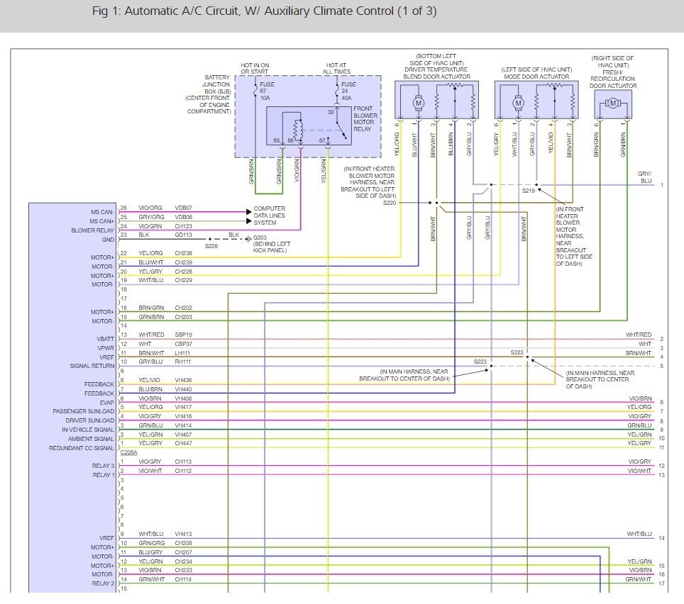

EATC MODULE SELF-TEST The self-test can be initiated at any time. Normal operation of the system stops when the self-test is activated. 1. To enter the self-test, press OFF and FLOOR buttons simultaneously then press the AUTOMATIC button within 2 seconds. Display will show a pulse tracer going around the center of the display window. The test may run as long as 30 seconds. Record all DTCs displayed. 2. If any DTCs appear during self -test, follow the diagnostic procedure given under ACTION for each DTC given. 3. If a condition exists but no DTCs appear during the self-test, see SYMPTOM TESTS . The EATC system is Inoperative, Intermittent or Improper Operation. 4. To exit self-test and retain all intermittent DTCs, push the blue (cooler temperature) button. The control will exit self-test, retain all intermittent DTCs and turn OFF (display blank). 5. To exit self-test and clear all DTCs, press the DEFROST button. The vacuum florescent display window will show 888 and all function symbols for one second. Then, the EATC control assembly will turn OFF (display blank) and all DTCs will be cleared. 6. Always exit self-test before powering the system down (system turned off). Intermittent DTCs will be deleted after 80 ignition switch ON cycles after the intermittent condition occurs. © 2008 Mitchell Repair Information Co., LLC. NOTE: The EATC module self-test will not detect concerns associated with data link messages like engine coolant temperature or vehicle speed signals. A scan tool must be used to retrieve these concerns. The EATC module self-test will detect concerns in the system control functions and will display hard DTCs in addition to intermittent diagnostic trouble codes for concerns that occur during system operation. The vehicle interior temperature should be between 40°-90°F (4°-32°C) when performing the self-test. If the temperatures are not within the specified ranges, false in- car temperature sensor DTCs will be displayed.
Post the results.

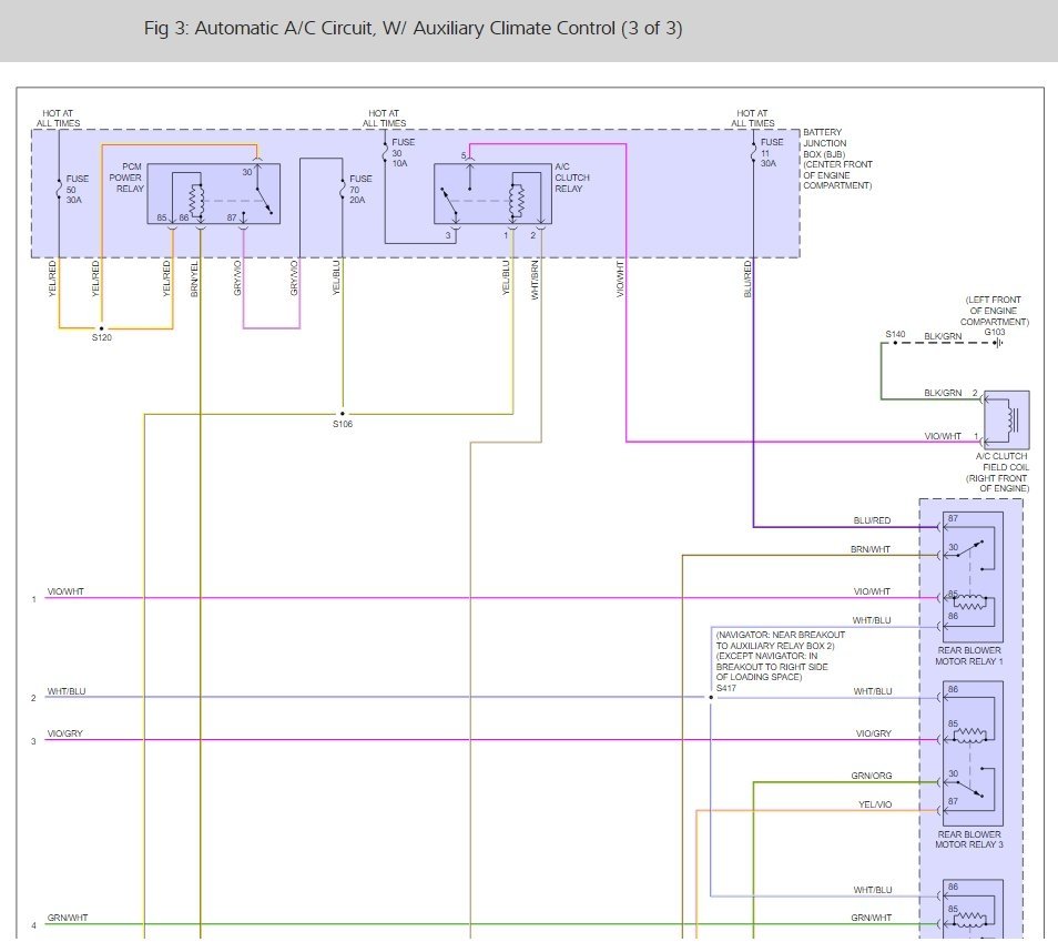

Was the clutch replaced with the new compressor? Are you getting power to the clutch? Does the compressor cycle on and off at all?
EMILYWALKER
the compressor isn't engaging at all. I am being told the clutch was replaced with the new compressor, said it was a "complete" compressor. I do not know if the clutch is getting power, how can i tell?
  • 110,244 POSTS
The clutch is usually part of the new compressor, so chances are they are being honest. To check for power, there is a single wire that runs to the compressor clutch. Use a test light or amp gauge to see if there is power to it.

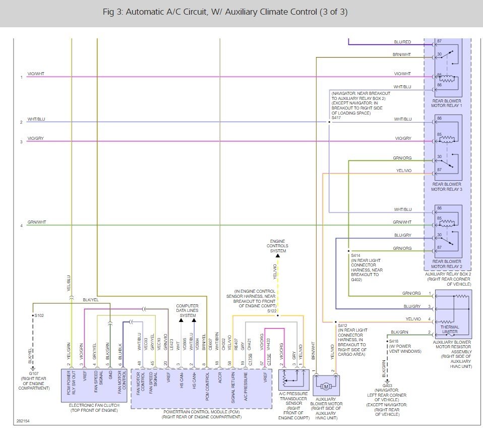

CBAILEY75
V8 two wheel drive automatic 50,000 miles. It started with intermittent stoppage and finally the front A/C will not blow air at all while the rear A/C will continue to blow air and the air is cold. It is an intermittent issue on top of everything else. There are times when the front unit will turn on just as normal as it should and then other times, it will not turn on at all, while at other times, it will turn on only after the rear unit has been on for awhile.
There is no rhyme or reason as to what makes the front unit decide to come on. I have tried turning the control to reflect the front unit blow air from the top and bottom and I can feel a very slight bit of air flowing from the air vents. When this happens, sometimes the full front unit will kick on and other times it just runs with the very slight air. Other times, the front unit will not blow any air even with the control knob in that position. Yesterday, the front unit worked perfectly as if there was never an issue and this morning nothing.
If it is the blower, I do not know. It seems to me like a vacuum issue as I can hear something in the air vents trying to open or close. Maybe that is what it is? I just do not know but other times, I cannot hear the same sound. Did I help at all?
Okay, When the air does blow from the front, it blows exactly where it is supposed to. But when it does not blow, it does not blow from any of the front vents. So when it does kick on and I have the control set to AC, it blows from the proper AC vents. Does that make sense?
Additionally I am speaking about the AC, not the heater just in case that makes a difference.
It is very frustrating.

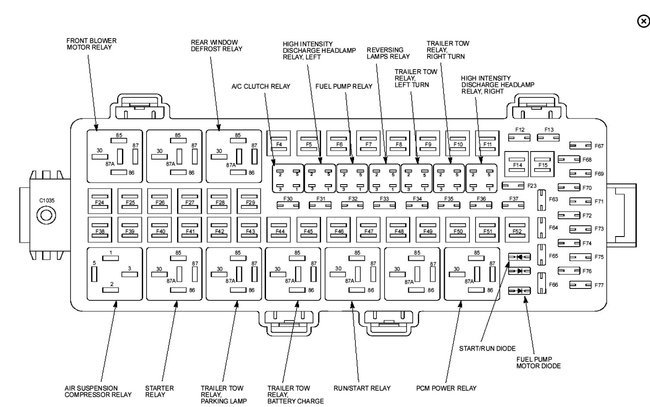

  • 110,244 POSTS
The relay wouldn't cause the fuse to blow. You have to have a short to the compressor.

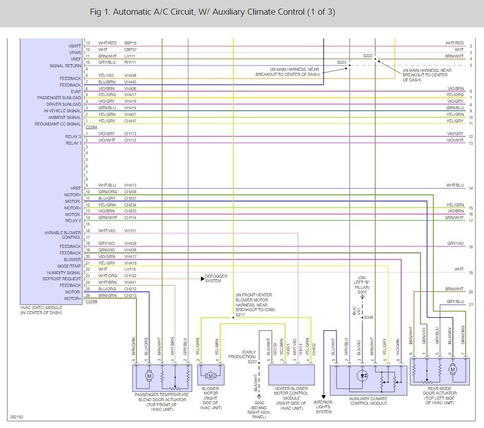

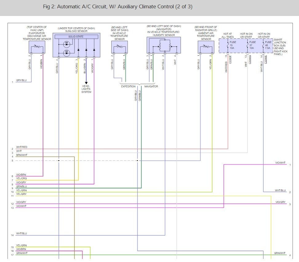

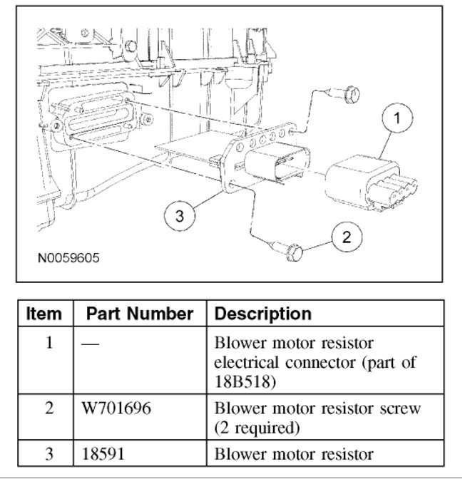

Two things come to mind for this problem. First is the blower motor controller itself is going bad which you can confirm by flowing this guide.
https://www.2carpros.com/articles/blower-fan-motor-works-on-high-speed-only
Here are some wiring, relay and component diagrams (below) to help you do further testing and get the problem fixed:
and
Please run some tests and get back to us we are interested to see what it is.

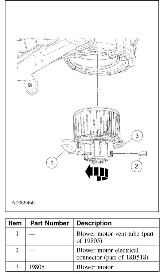

I was having a similar problem with my 2008 Expedition LX KingRanch. The rear blower worked fine, but I was having intermittent blowing from the front blower. When the blower DID work, it worked as expected. It was either all or nothing.
I replaced the blower resistor but it did not fix the problem. I tested both the old and new resistors with an ohm meter and they were both fine. I tested the connector to the resistor with a volts meter and it was fine. I then went to test the connector to the blower to see if it was getting power and this is when I discovered the true problem.
Upon loosening the blower and removing it, it started spinning, much to my surprise!! At this point, I know that it was either a loose blower connector or a bad/faulty blower. In my case, it was a bad blower. There was a dead spot in the bushings. There is a little access cover that you have to remove to drop the blower. Until I was able to replace the blower, all I did was (with the power to the blower turned off!!) reach my finger into the access cover and advance the blower a little bit off the dead spot. ShaBAM, it would work fine. Until I shut it off on a dead spot again.
The take away is, if it is not a resister problem, check your blower to see if you have a bad connection or a bad/dead spot in the blower bushing.
