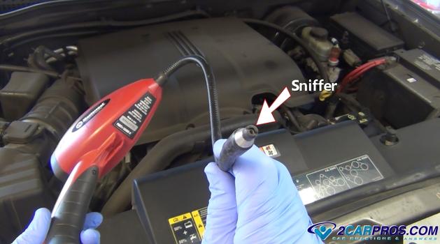

If you cannot hear the leak, or find any oil residue then a leak detector is needed. If you do not have a detector you can purchase one from Amazon from about $35.00. The detector is comprised of a main body which holds a sensing device, batteries, and sensitivity controls. At the end of the detector there is a "sniffer" which is where the detector pulls in a small amount of air to be analyzed for traces of refrigerant.

Note: Dust and dirt can cause the detector to falsely "go off" and it can fool you into thinking there is a leak when in reality there is not. If you do accidently catch some dust blow into the sniffer tip and the detector will reset itself. Keep the tip out of the dirt of the vehicle as much as possible.

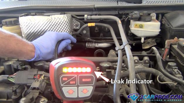

1. Turn the detector on and adjust the sensitivity to the lowest setting to start testing. Here we are testing an O ring seal on the receiver dryer with no response from the detector. O rings are popular places to finds leaks. The tester will indicate a leak by showing one or more red lights while beeping. If you have tested the entire system and no leaks are found, adjust the sensitivity to its higher settings.

7. When the detector has found a leak it will indicate this by beeping rapidly and advancing the red lights on the detector. Before the repair can be made the system must be discharged, once the repair is completed the system must be vacuumed down and recharged.
