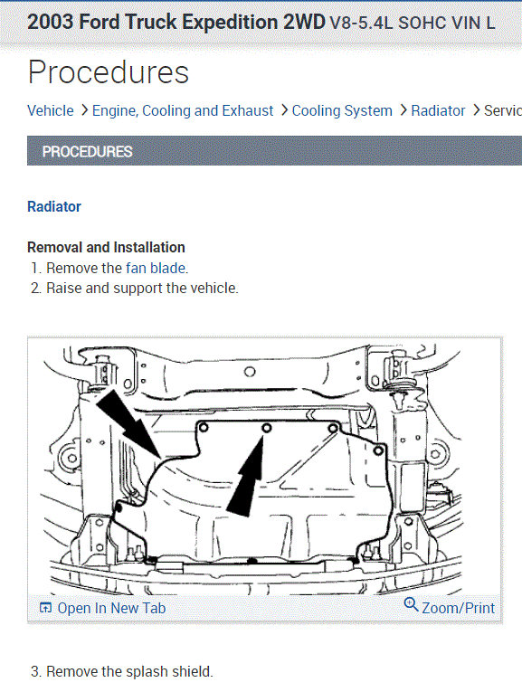

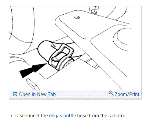

The radiator is leaking I need to change it out.
2003 FORD EXPEDITION
ELENALMCCOY
the radiator is leaking I need to change it out.
Jan 5, 2010 at 7:54 PM
  • 110,194 POSTS

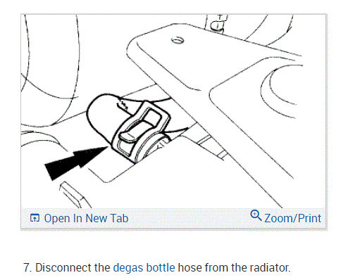

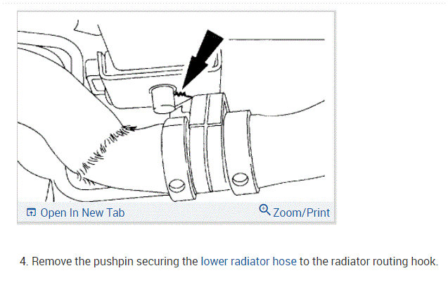

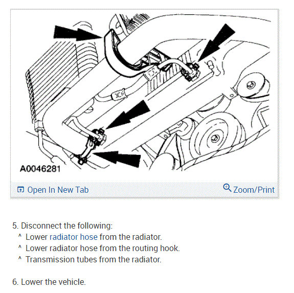

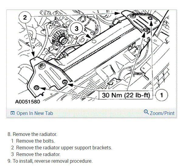

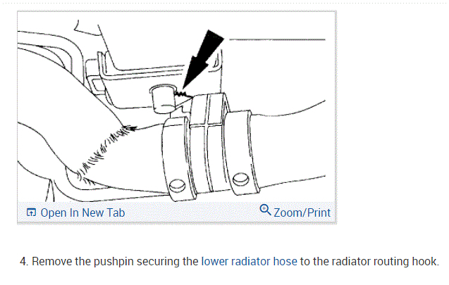

Replacing the radiator isn't too hard to do. However, it can be a dirty job. Make sure to keep all coolant in a safe place away from animals.
To get you started, here is a link that explains in general how it's done. You can use this as a guide.
https://www.2carpros.com/articles/how-to-replace-a-car-radiator
If you look at the attachments below, they provide the directions and pictures specific to your vehicle for removal and replacement.
Jun 1, 2021 at 8:23 PM
