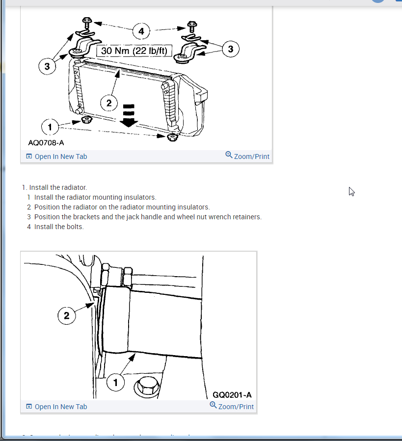

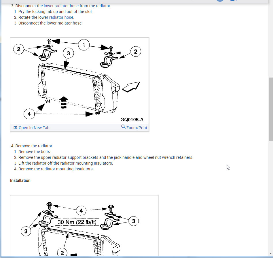

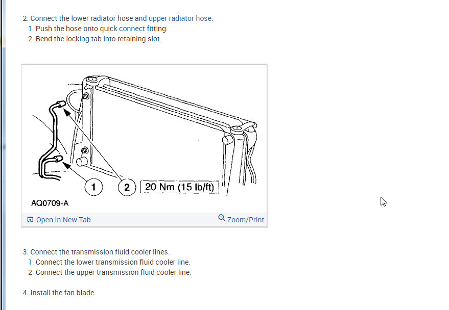

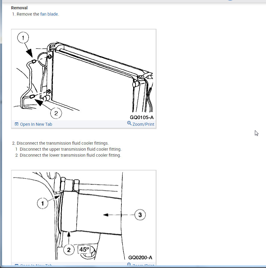

leaking antifreeze from the front driver side. I checked and its the radiator
2000 FORD EXPEDITION
156,921 MILES • 5.4L • V8 • AUTOMATIC
ARMYMOMX2G
Just started leaking antifreeze from the front driver side. I checked and its the radiator.
Apr 29, 2014 at 5:46 AM
Here are a couple guides that will help with this and give step by step instructions:
https://www.2carpros.com/articles/how-to-replace-a-car-radiator
https://www.youtube.com/watch?v=eklCKZIOd_0
Below are the instructions from the manual which you will need to replace this as well.
Please run through this material and let us know if you have questions. Thanks
