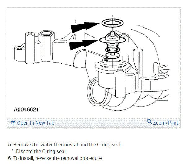

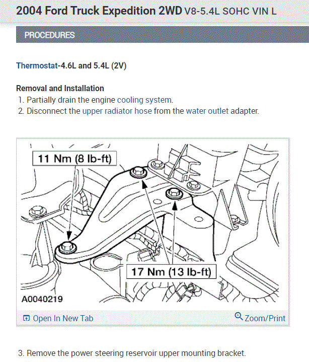

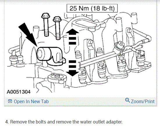

My heater won't blow hot air. I think I should change the thermostat. How do I do that..you know, simple instructions please. Thanks much.
Dec 10, 2008 at 10:38 PM
  • 110,244 POSTS
Replacing the thermostat isn't too hard. Just make sure to keep all coolant away from animals. It is very toxic.
To get you started, here is a link that explains how to replace an engine coolant thermostat in general. It can be used to help guide you.
If you look at the attachments below, they provide the directions and pics specific to this vehicle for replacement.
I hope this helps. Let me know if you have additional questions.
