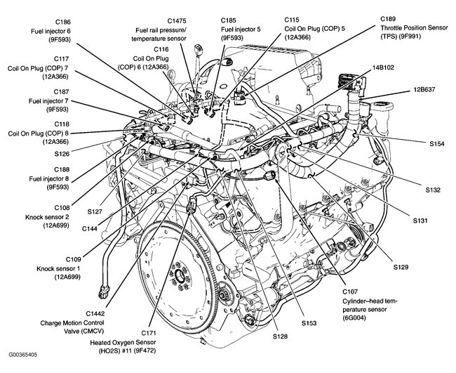

I got check engine light, when I diagnosed it ave me code P0119 faulty and pending, also gave me P1289 pending, so I figure it out the ETC should be changed, I bought one and to replace it I need to locate it on the engine.

This image should help. My reference says that the P1289 code refers to the Cylinder Heat Temperature sensor. P0119 refers to the Engine Coolant Temperature sensor. Check out the diagrams (Below). Please let us know if you need anything else to get the problem fixed.
