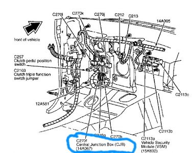

Oops. More data. Now it seems that neither the cruise control nor backup lights work along with turn signals. So perhaps the flasher isn't the offender. Anything obviously in common with those three things?
Feb 11, 2007 at 12:23 AM
SERVICE WRITER
  • 9,123 POSTS
Check fuse #27 in the central junction block on the left lower side of the dash.
