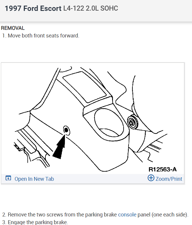

First and foremost this site ROCKS! I have one simple question and that is how to open the instrument panel below the shifter, to replace a bulb. I have done it to my sisters car but hers seems a lot easier 2 years ago.
Here is a pic of what I am talking about.
[img:52f87d68e0]http://www.2carpros.com/forum/automotive_pictures/121399_2340753_5_400_1.jpg[/img:52f87d68e0]

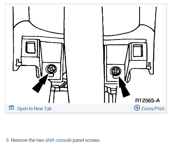

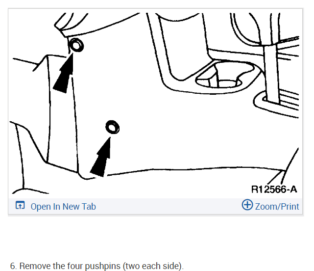

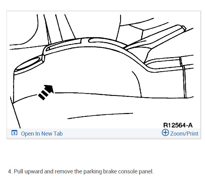

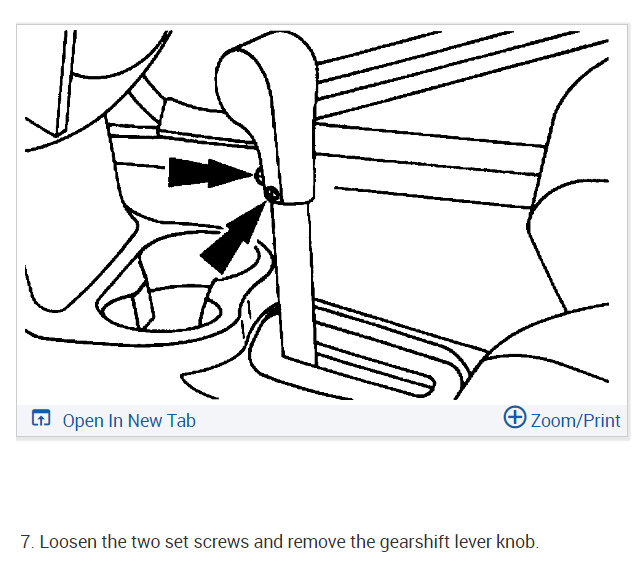

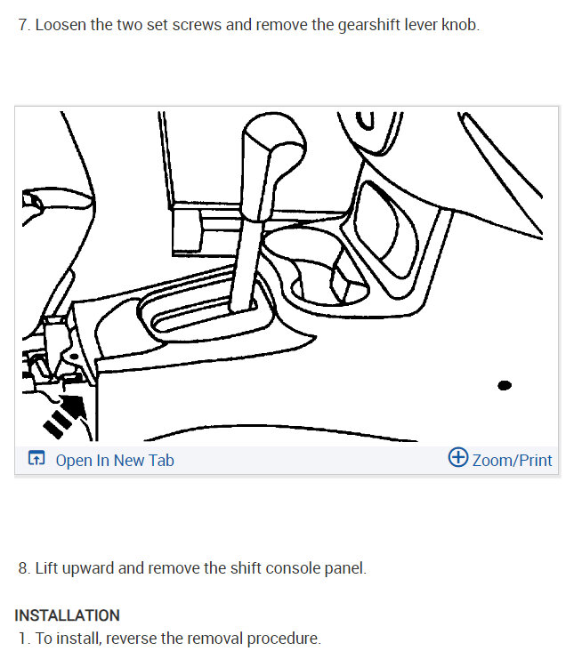

Sure, you need to remove the center console which I have left instructions for in the images below. Check out the images (below). Let us know if you need anything else.
