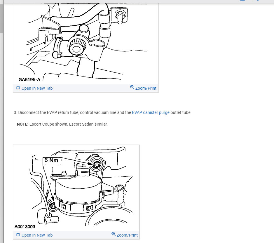

2002 ford escort zx2 with ~54000 miles. When I hit the gas pedal, it diesels REAL bad and has no power. If i BARELY touch the gas it runs fine - albeit gets up to speed very slowly. Had the computer checked as the check engine light came on and replaced the MAF sensor - no help at all. I replaced the fuel filter, again no help at all. Car seems to rev ok while in park and idles fine - but no power under load. Check engine light is NOT on any more. Only owned the car for 6 weeks. Any help would be greatly appreciated.

I have to start by saying that this vehicle is used as a professional rally racing car, and for the most part has done a GREAT job. However, the above issues are EXACTLY the same. I can push the gas down up to half way, and the car will do just fine the entire time. But when I give it a bit more 'go-juice' the car begins to buck and eventually looses all power. Take my foot off the gas and then reapply it half way, no issue. I have replaced the TPS with so effect. There are no conclusive OBD II codes being produced. NOW, I will say that before, it seemed to correspond to the level of gas in the fuel tank. Any help on this issue?

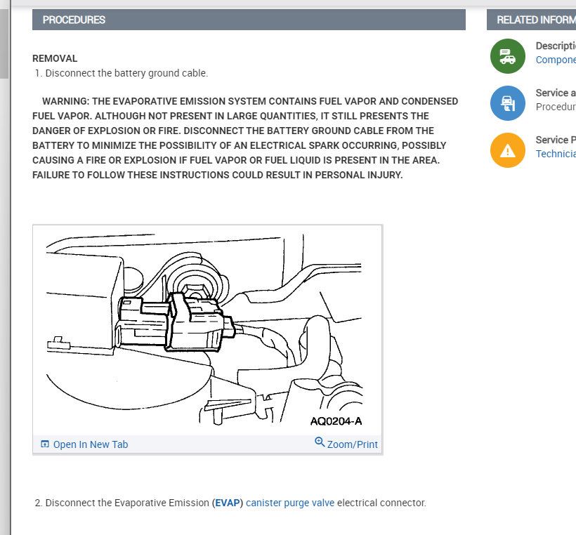

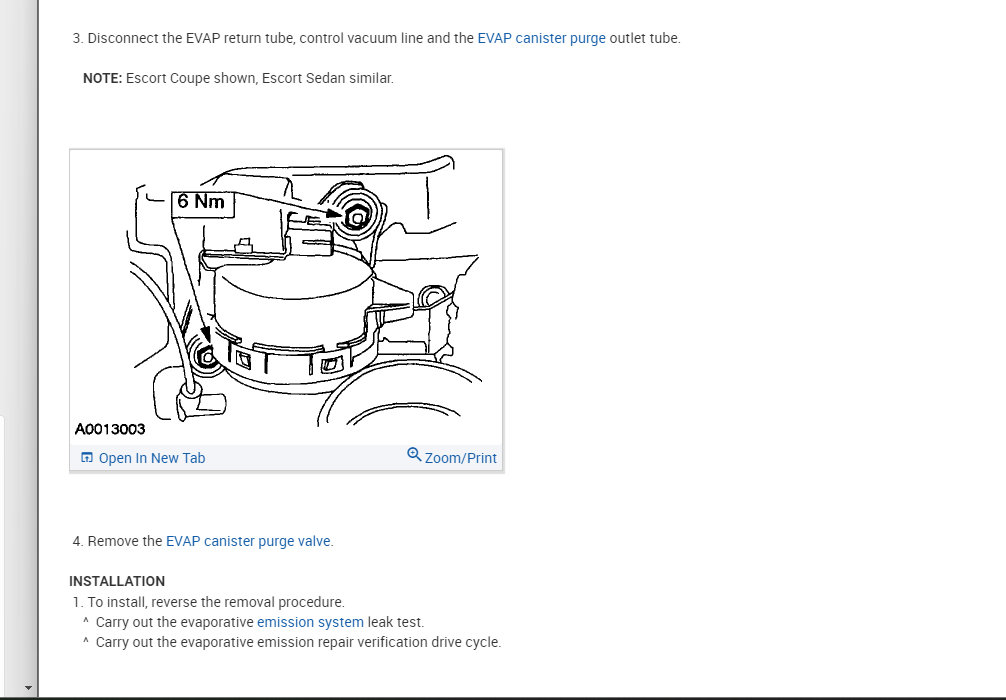

Thanks for providing that info. Unfortunately, this is a post from well over 10 years ago, so they are unlikely going to benefit from it.
However, I am sure others will.
One thing I will add to this is due to the fuel level having an effect on issue that was mentioned in the second post then this means it is likely related to the EVAP system.
Basically, when the purge hangs open the engine gets flooded and if the fuel tank is full or low then that will affect the vapor volume.
https://www.2carpros.com/articles/symptoms-of-low-engine-power
I would suggest removing the purge and check to see if it is stuck.
I am attaching the info below on this so hopefully this will help others in the future.
Thanks
