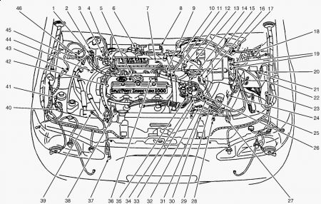

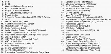

They now make a throttlebody cleaner, not carb cleaner, I now ford uses teflon coated TBI's but the newer TBI cleaner will not harm it! As for the Gauge, check the connector at the sender #33 in the diagram.

Will check the temp gauge connector now. Hard to see 33 though. Front of coil?

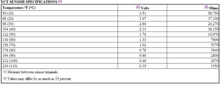

Let's try this, measure the resistance of the IAC:
IDLE CONTROL SYSTEM 1. Check Idle Air Control (IAC) Solenoid Resistance Turn ignition off. Disconnect IAC wiring harness connector. Connect DVOM positive lead to VPWR (White/Red wire) terminal of IAC solenoid wiring harness connector. Connect DVOM negative lead to IAC terminal. If resistance is 6-13 ohms, go to next step. If resistance is not 6-13 ohms, replace IAC valve assembly. 2. Check IAC Solenoid Internal Short To Case Turn ignition off. Measure resistance between each wiring harness connector terminal and IAC housing. If either resistance is less than 10,000 ohms, replace IAC solenoid assembly. If each resistance is 10,000 ohms or more, IAC solenoid is okay. If fault is still present, go to CIRCUIT TEST KE in TESTS W/CODES article for additional testing.
Let me know...and ECT(CTS)
https://www.2carpros.com/forum/automotive_pictures/62217_ECT_9.jpg
No Stall? It should not stall unless you apply vac at idle, this makes the EGR open, if it does not stall with EGR active, then carbon blockage is your answer, remove EGR and clean out the port under it all the way to the throttle plate, I use a coathangar for this, and TBI cleaner, clea EGR valve too, apply vac to the EGR, does the diaphram move? Could be loosing vac at EGR.

The first test gives me 11 ohms.
On the second, from one of the two terminals to the housing I get 9500 ohms, the other reads 0.
Let me say, my meter may not be 100% accurate, but I think it's close.
