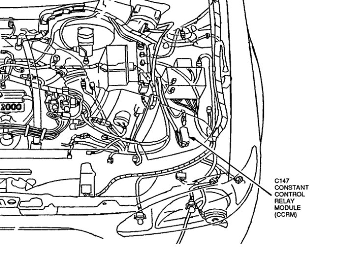

Hello, I am working on a air conditioning system that the compressor will not come on. I fixed a broken wire going to the compressor, fuse is good. Voltage at that plug varies from 4 to 11 volts. I can jump the compressor with a another source of 12 volts and it will run. I ran it long enough to put in one can of 134a. I found a two wire plug on the accumulator/dryer and checked it for voltage of 13 to 14 volts with the car running. I jumped it across and the cooling fan came on. I found a four wire plug on the high pressure line and decided to stop there because I do not have a repair manual or a schematic to pursue this further. Please advise. Thanks.

This sounds like you have a compressor relay that is not working. Here is a guide to help you check the relay with diagram below of the relay location:
They call it a constant control module. Check out the diagrams (below). Please let us know what you find.

Thanks! You guys are the best. I did what you said and replaced the module everything working great! I love this site.
