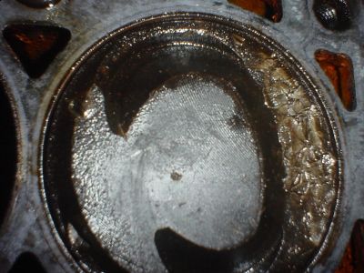

GARYVAC2
  • 13 POSTS
OK, finally, I got the head off again.......took off the exhast and intake manifolds...there is damage to the surface of the head,, the no.4 piston has damage to it as well....just to the face of the piston as seen in pic....the cylinder walls are fine, no damage, no scratches.....remember, (m not a mechanic, just calling this stuff out as I see it)
https://www.2carpros.com/forum/automotive_pictures/399551_head_damage_1.jpg
https://www.2carpros.com/forum/automotive_pictures/399551_pistondamage_1.jpg
.....if I get another head with good valves can I install it and run the car with the piston damaged like that? looks like just surface damage, we did NOT run the car like this for more than about 5 seconds before shutting it off.....it was towed home....considering the miles 165K and age....can it be left like this with another head and run for a year or so?

LAZYGAZER
  • 68 POSTS
Hi again, sorry to see that your head got messed up, and funny thing I signed in was reading your last input and was about to tell you mayby there was somthing loose in the cylinder and scrooling down I saw what I was thinking about.
Ive seen a few of those but cant see how or what got in the cylinder. However if you can do a fluid test on that cylinder by putting some t/m fluid in them and see if there is any leaks then you should be fine as long as the new head and gasket can seal without any kinks.

GARYVAC2
  • 13 POSTS
Thanks for getting back to me.I ended up getting a rebuilt head with new valves. The valve seat came out and got chewed up as you saw in the last post. Supposably, they have improved the valve seats on these rebuids to prevent this from happening.I put it all back together and started the car before I went to bed last night. Only thing i'm worried about is that damage on the piston, not sure if heat will cause it to prematurely fail and crack or something, I did'nt realize that the pistons are also aluminum.I'll give it a run this morning and hope for the best. Thanks for your help

LAZYGAZER
  • 68 POSTS
Sorry to get back to you so late but I see u have it covered. But to know the integrity of the piston would be to do the fluid test. However from the pic the damage was not to the center but the edge so you should be ok.
Thursday, September 24th, 2009 AT 6:14 AM
GARYVAC2
  • 13 POSTS
Its too late to do that test.I'm not a mechanic, like I said before, but, i've never seen the pistons out on a table to look at. Can you give me an idea how thick they are at the top? This damage to the edge is about 1/16 maybe 1/8" deep in a couple spots. But no damage to the center as you say, the center is thicker then?
Thursday, September 24th, 2009 AT 6:19 AM
LAZYGAZER
  • 68 POSTS
Yes its late now but you should be fine looking at the pics you are ok.
