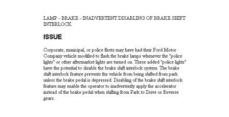

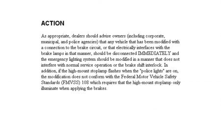

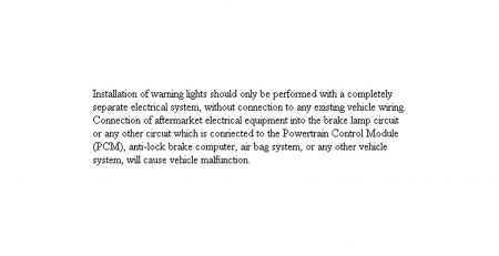

It sounds like a weak alternater. IF the battery is five years old, I would replace it regardless. It may be both a bad battery and alternater. There is wiring on the instrument panel and fuel injection circuits that lead from the alternater. The shift interlock may be related to the alarm wiring. This was from a tecnical service bullitin: [
