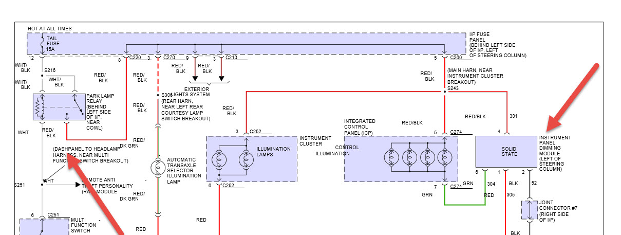

Instrument lights stay on when ignition switch turned off. draining the battery.

check the parking light relay for staying on, switch with a like relay or it may be the dimming module shown in picture. which a mechanic will have to scan for codes to see if that is the problem.
