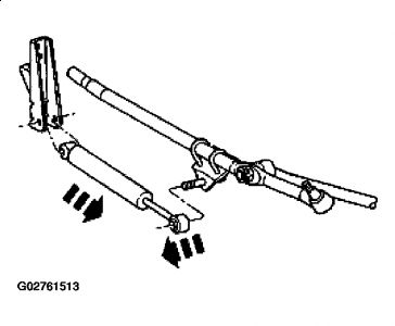

Hi
Check out steering dampner see diagram. for fluid leaks. unbolt and check resistence should be quite stiff if not replace.
Let me know

brillant deduction, e250 doesnot have sterring dampner, did i waste my donation?

Yes it does
https://images.2carpros.com/forum/automotive_pictures/198357_Grafic_3_44.jpg

there is no sterring dampner, if i need to send picture i will, tried putting in neutral several times and on different roads and and at different speeds and the vibration is still there, like i say, feels like riding on a cobblestone road, feels like steerring is loose, could it be steering box needs adjustment?
