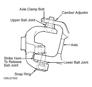

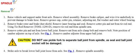

i have a 98 ford e-250. i cant get the steering nuckle off..i have the caliper and rodor off but the lower ball joint is stuck and wont come out...my question is how do i get it out?!?!?!?

https://images.2carpros.com/forum/automotive_pictures/261618_Noname_2806.jpg
https://images.2carpros.com/forum/automotive_pictures/261618_Graphic_741.jpg
