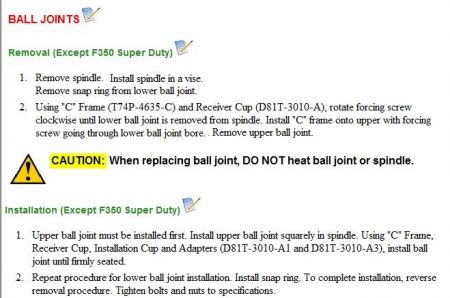

Trying to replace Ball Joints & cannot get the bottom one out. Any Help?

https://images.2carpros.com/forum/automotive_pictures/261618_Noname_2168.jpg

Thank you so much.
