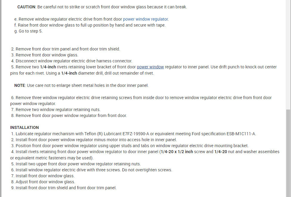

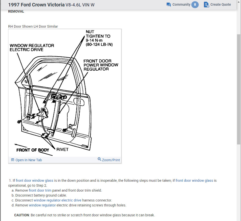

Below is the process from the manual that will give the detail that is needed to complete this as well.
Please let us know if there is anything we can help you with in the future. Thanks
