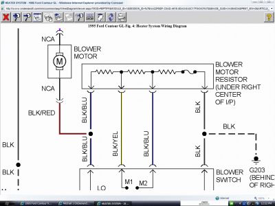

Where is the heater blower motor resistor located? I need to replace it. I have been replacing fuses regularly. Also the fan swtich only works on the high selection. Again, where is the fan motor resistor, or as ford calls it the regulator located?
Monday, August 26th, 2019 AT 11:46 AM (Merged)
MERLIN2021
  • 17,250 POSTS
It's on the blower case, rermove the under dash panel to expose the case, remove the plug, screws, and then pry out the old, snap in the new and you are done! Heres the colors of the connector...
