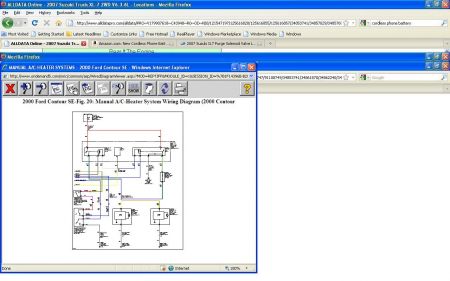

Yes, my niece has a 2000 Ford Contour. The Blower Motor does not work. I removed the Blower Motor and checked it by connecting a 12-volt power source. The Blower Motor itself works fine. Therefore, it must either be three other possible problems. 1.) the Blower Motor Resistor. 2.) The Dash Blower Motor fan switch, or 3.) the Blower Motor fan relay.

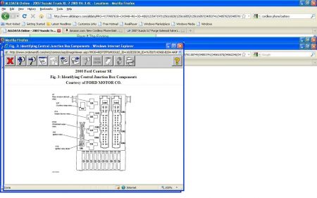

So, where do I find the Blower Motor Resistor or the Blower Motor Relay? I have a Haynes Manual for this vehicle, but it does not show you where to look for these items.
Is there not a more comprehensive manual out there which provides locations for parts such as referenced above?
P.S. I understand your time is valuable. However, at rhis particular time, I cannot afford a well deserved donation at this time. I am Disabled and I don't receive my monthly check until the 17th of the month. Sorry.

First of all thank you so much for your donation.Do you have a multimeter so we can do some testing?You will need one so we can figure out what is wrong.Also do you know how to use a multimeter?Let me know

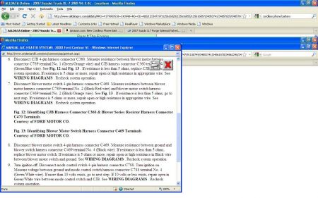

Alright on the connector that goes to the blower motor put the fan switch on high with the key in the run position.Check the green and orange wire it should have battery voltage.Now check the black and red wire that should have 2 ohm's or less to ground.Let me know what you find.

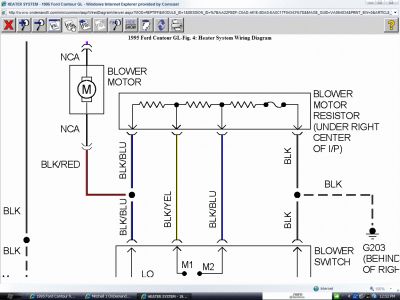

Yes you need to check the switch !
BLOWER MOTOR CIRCUIT
Mode (Function Selector) Switch
When the heater mode switch is in any position except OFF, power is supplied to the coil circuit of the blower motor relay. When the heater mode switch is in the OFF position, the blower motor will not operate.
Blower Motor Relay
Blower motor relay is located under left side of dash, in fuse/relay block. When current flows from the heater mode switch to the blower motor relay, it passes through the coil circuit to ground. This causes the contacts in the relay to close, allowing power to the blower motor.
Blower Motor Switch
The blower motor switch completes the blower motor ground circuit by directing current through one or more of the blower motor resistors (except high speed), or directly to ground through the blower motor switch (high speed).
Blower motor resistor is located behind glove box, near blower motor. The blower motor is grounded through all 3 resistors (low speed), 2 resistors (medium-low speed), or one resistor (medium-high speed).
Thermal Limiter
The thermal limiter is part of the blower motor resistor. If airflow through the system is reduced or stopped (due to a locked blower motor wheel, etc.), the blower motor resistor may overheat, damaging the heater housing. If the temperature of the blower motor resistor increases to about 250°F (121°C), the thermal limiter opens the blower motor circuit. The thermal limiter cannot be serviced separate from the blower motor resistor.

-Check fuses 23 and 73 if okay-test the blower relay, resistor and the blower switch to include the ground circuit

Check the blower motor fuse 30amp and the blower motor relay in the interior fuse panel. Fuse and relay okay -Try powering the blower motor direct from the battery and see what happens
