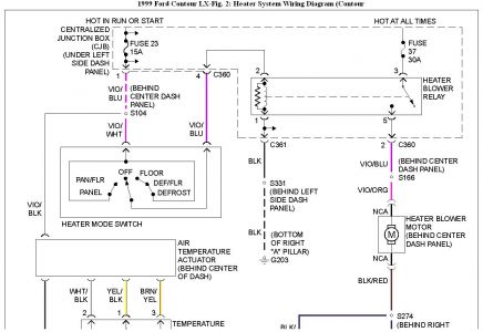

The interior compartment fuse for the heater blower "blows" when I turn the fan setting to either floor/defrost or defrost. Te fan will operate normally if i keep it away from the defrost setting. I should mention that the air conditioner has been removed from the system.
Can only get air flow when not in the defrost setting. Youcan actually hear stress on the engine when the defrost blower setting is selected before the fuse blows.
Any suggestions on where my short is?

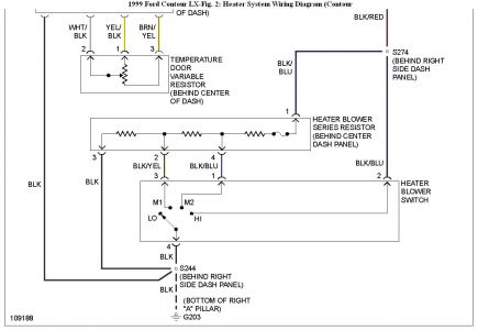

This is strange. Fuse # 37 is solely for the use of the blower motor fan, fan speed and relay and not related to the heater mode switch.
https://images.2carpros.com/forum/automotive_pictures/192750_HeaterWiringContour99Fig02a_1.jpg
https://images.2carpros.com/forum/automotive_pictures/192750_HeaterWiringContour99Fig02b_1.jpg
For the fuse to be shorting out, it should be a fault between the fuse and blower fan motor. What is surprising is why it is not doing so in other modes. Is the correct fuse used? ( 30 A). Does it blow immediately upon turning to defrost or it takes some time to do so?

The defrost setting seems to have caused something to short out the circuit but based on the wiring diagram, it should not occur, unless the wiring schematic is wrong.
I am going to post this in the moderators forum to get my fellow technicians to have a look into this and see if any of them can come up with anything.

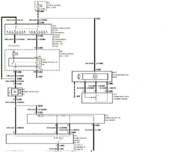

I also noticed that the schematic listed here is differnt than my vehicle wiring. There is no ac settings on the schematic switch. Also The power to the fan does not go directly to the relay. It goes to the switch first and then to the relay.

https://images.2carpros.com/forum/automotive_pictures/66751_Untitled_1.jpg
Oct 5, 2010 at 1:20 PM
BLACKOP555
  • 10,386 POSTS
you are going to have to start by with the bulb in and heater turned to defrost disconnect blower motor light. does light turn off or stay on? also what does the bulb do in other settings.
try disconnecting ac clutch, and the pressure switches also. anythign change?
