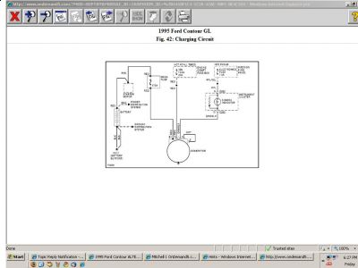

According to my schematic there are 2 red wires going to the alternator. One from the battery," B+", and one from the underhoodfuse block, "A". "I" is grn/blk and "S" is grey. Does this not match what you have?? Let me know.

I DO NOT HAVE ANY RED WIRE COMING FROM A FUSE BOX... JUST THE WIRES HOWN IN PICTURE ATTACHED MY SCHEMATICS
(HAYNES) SHOW ME THAT THERE IS ONLYTHE GRN/BLK WIRE AND THE RED DIRECTLY FROM THE BATTERY. THAT IS ALL THE WIRING THAT i HAVE... mAY i SEE A COPY OF THE SCHEMATIS THAT YOU HAVE. THE THERE IS ALSO A PICTURE OF THE DASH WILL THAT RESISTOR SHOWN IN PICTURE CAUSE THE NO CHARGE SYMPTOMS THAT EXIST..? SIT IS RED-BLK-RED-GLD, AND IT MEASURES AT 7OHMS IT IS RATED AT A 2K OHMS.. WHAT DO YOU THINK?

According to my chart;
Red = 2, Blk = 0, Red = 00, Gold = + or - 5%
That's a total of 2,000 ohms. wattage just indicates how much load it will carry.
If, with the car running and you unplug the alternator, is the dash light(charge) come on? If yes, put 12 volts to the grn/blk wire at the alternator connector with it still uplugged. Does the dash light go out???

Check to see if you have 12 vols, or close to 12 volts ay the connector end of terminal I. If you don't, you have an open between connector twerminal I, and the fuse in the interior fuse block.
Grounding terminal I at the alternator connector should light the das light with the key in "on" position.
There is a "resisting diode" in conjuction with the dash charge light that allows fuse block voltage to run around the charge bulb to allow reduced voltage to bypass the bulb as it goes to the alternator. When the alternator starts to charge, it sends voltage back up the grn/blk wire and with 2 positive feeds to the bulb, it goes out.
Do you gave a "grey" wire that loops in and out of the alternator? If yes, make sure these connections are good. Let me know.

I'm sending you a shot of the diagram I'm using. I'm trying to dig up a schematic for the internals of the alternator itself. I'm thinking ourproblem may be in the Grey wire circuit. Let me know if you don't get the diagram as an attachment.
https://images.2carpros.com/forum/automotive_pictures/248092_95fordaltdiagram_3.jpg
This diagram didn't come very well, I'll try another.
https://images.2carpros.com/forum/automotive_pictures/248092_95fordaltdiagram_2.jpg

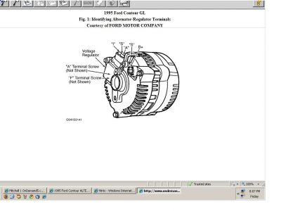

The attached looks like the voltage regulator is a screw on unit. I can't get a very good shot at it. Take a look at yours. This could very well be our problem. Let me know and I'll keep looking for an exploded view. This little project has now become a personal vendetta.

GREAT NEWS IT WAS THE REGULATOR AND ON TOP OF THAT THE i WENT TO REPLACE THE ALTERNATOR AT THE PARTS STORE AND THERE WERE TWO RIGHT OF THE SHELF THAT FAILED THE ON-SITE ALTERNATOR TEST AND THE FAULTY PART WAS THE REGULATOR... THANKS SO MUCH FOR THE HELP AND DIAGRAMS... CAN YOU GIVE ME SOME INFO ON THE MITCHELL MANUAL THAT YOU USED TO HELP ME.. THANKS AGAIN... I REPLACED THE ALTERNATOR WITH A GOOD ON AT ANOTHER STORE AND CHARGE LIGHT WORKS NOW AND THE BATTERY IS GETTING 14.8V AT A STEADY CHARGE...
