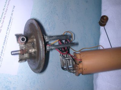

I disconnected the fuel line at the rail (to the rear of fuel filter) and no fuel pressure. when the key is turned to second position. However, I did hear the pump(in-tank) turn on. Dropped the tank, pulled the pump and the sock and filter it didn't seem dirty. Is there any way to check the pump without submerging in gas/water? The pump motor still runs after connecting to 12v. Could it have been the fuel regulator preventing pressure from the rear even though it's located in the front? Or, perhaps a clogged fuel housing(sending) unit? Thanks in advance! AE

Hi there,
You must not run the pump out of fuel as you will over heat it very quickly,i would be banking on a bad pump, although the motor may still be working.

Thanks Mark. I sure hope so because I read, "if the regulator is stuck open, the fuel pump will NEVER develop pressure."
This comment is what concerns me. If the fuel regulator could cause no pressure getting to the rail. Doesn't make sense. Anyway, I bought the pump assembly and will install today. Hopefully, it was the old pump's impellers.
I just don't want to reassemble everything just to find out that there still isn't any pressure getting to the rail because of a regulator.
I'll be using a bicycle pump (bummer) to try and blow out any build up in the lines as well.
This has taken me twice as long as anticipated. Any other suggestions are greatly appreciated.
AE

Even if the regulator was stuck open through its normal range of operation you would still have pressure, the reg would just about have to break up internally for your problem to happen, pump is still looking good to me.
