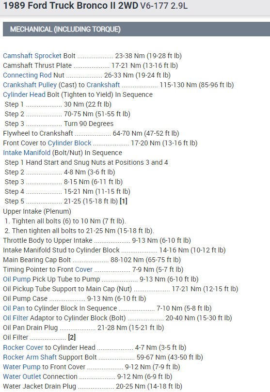

torque numbers for the water pump?
DOGDODGE
i was wondering the torque numbers for the water pump and the timing belt casing.

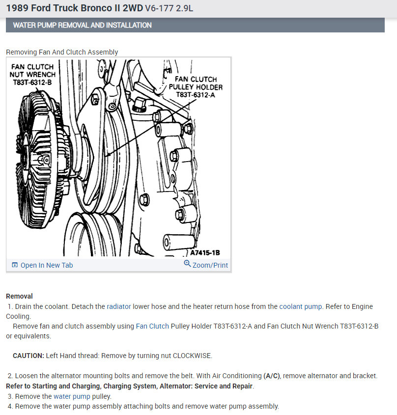

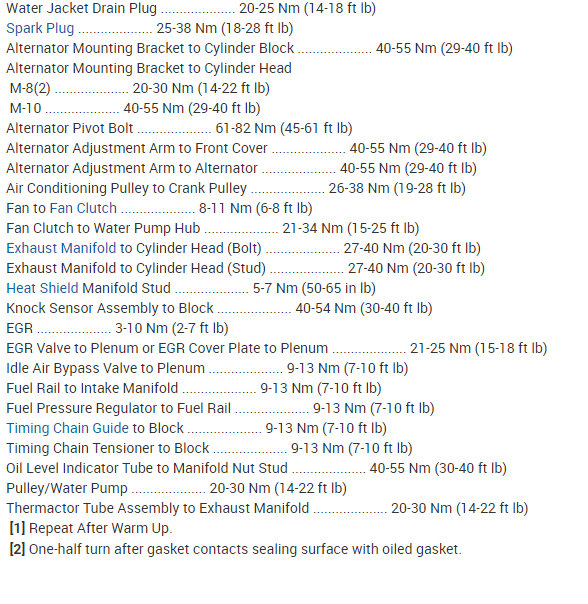

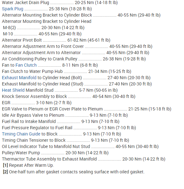

Here are the torque specifications for the water pump on the Bronco 2.9L:
Water Pump to Front Cover : 9-12 Nm (7-9 ft lb)
Water Outlet Connection : 9-12 Nm (6-9 ft lb)
Water Jacket Drain Plug : 20-25 Nm (14-18 ft lb)
Be sure to work on the vehicle's cooling system when the engine is cool.

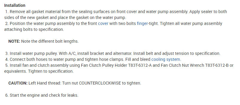

Here is a helpful guide of water pump replacement:
https://www.2carpros.com/articles/water-pump-replacement
I have attached the water pump replacement diagrams below.
