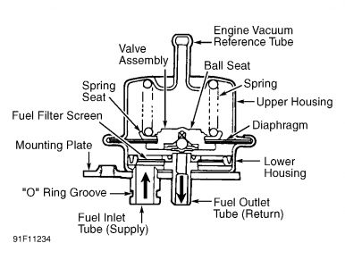

I have a 91 Aerostar w/3.0 TFI IV Fuel Injected 6cyl. It sat for a week and when tried to start it would turned over but wouldnt start. Noticed smell of gas when trying to start. Replaced coil & cap & rotor. Ign Mod tested at autoparts store. I have spark between coil and dist. I also have spark between dist and plug. Tested with a spark tester. I have fuel at pressure port but it doesnt seem like alot.

Crank it over a few times and pull a spark plug out to see if your getting fuel to cylinders .. if your getting fuel and spark it should fire up ?
This guide will help us
FUEL PRESSURE REGULATOR
The fuel pressure regulator is attached to fuel supply manifold assembly, downstream of fuel injectors. It regulates fuel pressure supplied to injectors. Regulator is a diaphragm-operated valve with one side responding to fuel pressure and the other side to intake manifold vacuum.
When intake manifold vacuum is low, an internal spring increases pressure on diaphragm, blocking off fuel return passage and increasing fuel pressure. When manifold pressure is high, spring pressure is overcome by vacuum, opening fuel return passage and lowering fuel pressure. Excess fuel is by-passed through regulator and returned to fuel tank.
The regulator also controls fuel line vapor formation, allowing for rapid restarts, assistance in engine idle stabilization and maintenance of fuel pressure when engine is turned off. Pressure is adjusted at factory to compensate for fuel flow differences between injectors.

I did pull a plug and it was soaked. I then cleaned it and checked for spark and there was. I was thinking about the fuel pressure regulator also. I also was concidering the fuel filter, fuel pump or timing chain. I just bought a fuel filter and plan on installing it tomorrow. If that doesnt work I plan to replace the fuel pressure regulator. Beyond that, how would I check the timing if it wont run? I have a light and do know how to set timing. But not in this case. Thanks for your answer!

The pump is working if your getting fuel. If the plugs are soaked it may just be flooded. Try starting it again in the morning without touching the gas pedal. Remove a plug again and see if it's soaked again. Install filter try again and let me know. And we will go from there.

I will do just that. I am curious. How do you test the pressure regulator?
Ensure key is off. Connect fuel pressure gauge to Schrader valve on fuel rail. Ensure manifold vacuum supply tube is connected to fuel pressure regulator. Start and run engine for 10 seconds. Stop engine and wait 10 seconds. Start and operate engine for 10 seconds. Stop engine and remove pressure regulator vacuum hose. See Fig. 10 . Check vacuum port for fuel.
Fig. 10: Fuel Pressure Regulator Component ID
Courtesy of FORD MOTOR CO.
https://www.2carpros.com/forum/automotive_pictures/266999_fpr_1.jpg
If fuel is present, replace fuel pressure regulator and repeat test. If fuel is not present, start and run engine for 30 seconds. Stop engine and check fuel pressure gauge. If fuel pressure does not drop, go to step 4). If fuel pressure drops more than 5 psi (34.5 kPa) in 60 seconds, disconnect and plug fuel return line at engine. Cycle ignition key on and off until normal fuel pressure is obtained.
Turn key off and check fuel pressure gauge. If gauge drops more than 5 psi (34.5 kPa) in 30 seconds, replace high pressure fuel pump (dual pump system) or fuel sender/pump assembly (single pump type). If gauge does not drop more than 5 psi (34.5 kPa) in 30 seconds, replace fuel pressure regulator.
Ensure key is off. Relieve fuel pressure. Remove fuel pressure regulator. Check "O" ring, gasket and mounting surfaces for cracks, cuts or other damage. Connect vacuum pump to fuel return tube and apply 20 in. Hg. If maximum vacuum loss exceeds 10 in. Hg in 10 seconds, replace regulator. If maximum vacuum loss does not exceed 10 in. Hg in 10 seconds, recheck entire fuel delivery system for cause of fuel pressure loss.

But the procedure for testing the fuel pressure regulator, states that I must start the vehical and run it for X amount of time. IT DOESNT START! LOL! Hahahaha! So what do I do about that? My plan was to replace it and if it started. Wha la THAT was my problem. I would rather diagnose the problem rather than be a parts changer. I dont have internet at my shop so, I was hoping to nail down as many possiblities before I left for the shop.

You have to cycle the key on/off a few times if the vehicle won't start. To check the pressure regulator. I am aware it won't start. You was curious and asked about checking.?

I didnt even think about that. Cycling the key would cause the fuel pump to pressurize the fuel manifold. I guess thats why you make the big buck$. Lol. You rock. Thanks again. Heading over to the shop now. When I get home I'll post my results to you.

I put the new fuel filter on and tested the pressure at the shrader valve (just pressing it down). I got alot more fuel! I went ahead and picked up a pressure regulator (being that it's only $25) and installed it. I replaced all the plugs except one, which I'm still working on. (Passenger side rear is a booger!). So, I'm gonna go back to the shop today and finish the last plug and see if she won't start. I'll let you know. If she don't start, I'm thinking either the computer or timing chain. Any thoughts on that? How do you test the computer, and again I ask how does a mechanic check the timing when the engine wont start?
