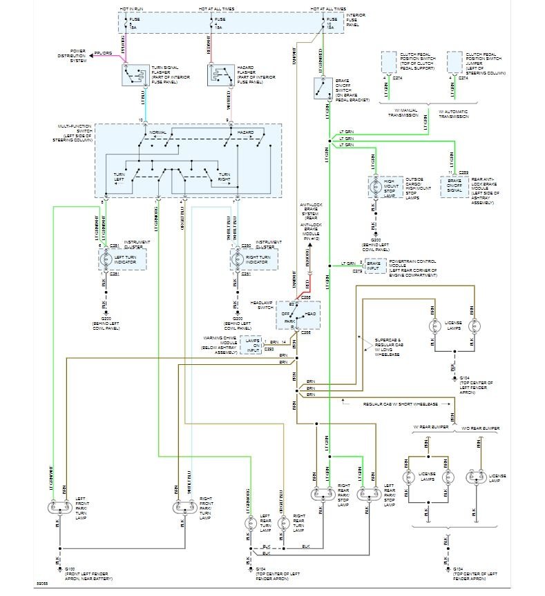

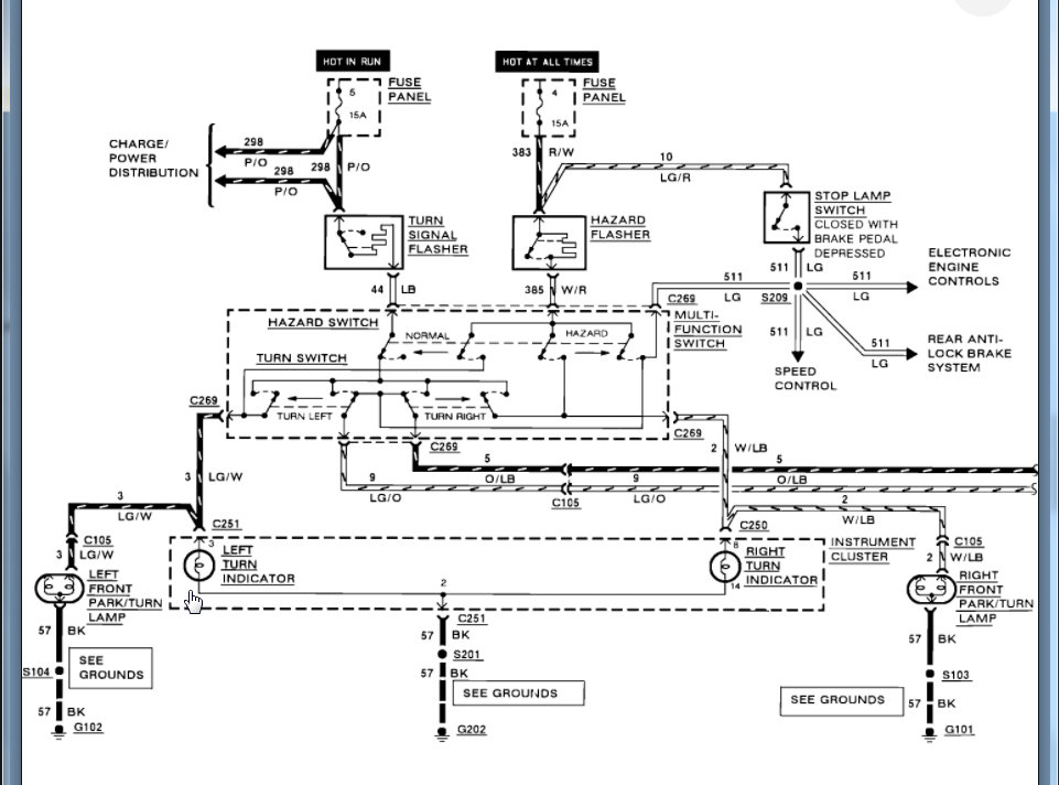

Try replacing your turn signal flasher its only 10 to 12 bucks should in or behind fuse panel.
Your wiring diagram for the turn signals is attached below
also attache is a guide for testing wiring

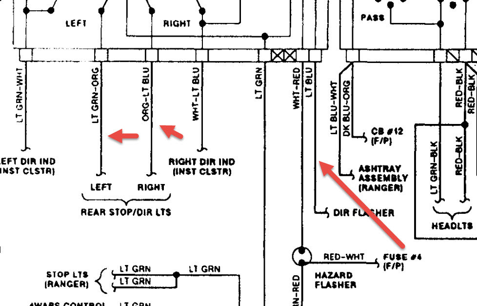

Hello, I was wondering what would keep my turn signals from working? The hazard lights will not work as well.

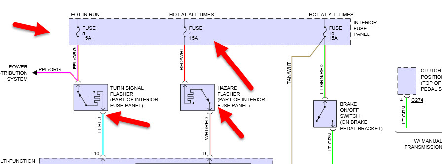

Check fuses in picture it looks like the flashers are part of interior fuse panel which may need to be replaced or a mechanic may be able to wire two flashers in. Not something for a person to handle. See picture.

My hazards work fine but my turn signals keep blowing the fuse. I have changed the multi function switch and the flasher but not sure if flasher I installed works properly. I was told if I had hazards then the flasher relay was fine. I do not think it would be a wiring issue going to the bulbs or the bulbs themselves because like I said the flashers work fine. I also have no reverse lights. The truck has not had reverse lights since I have had it for a couple years but just recently I am having turn signal issues. Help!

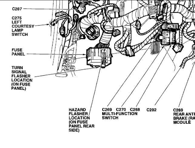

Good morning,
The turn signal flasher and the hazard flasher are separate flashers.
I attached a picture of the locations for you.
I would also check the wiring for the turn signals as well if it is blowing a fuse.

My turn signals stopped working. I changed the flasher that did not work. I got a used switch from the wrecking yard that also didn't work. The emergency flashers work fine. Any suggestions?

Seepic, make sure power is going to t/s switch from flasher and out of switch with arrows. Then check connection of t/s switch for corrosion if it has it clean off what you can then use dielectric grease get at auto parts. For about $2 usually on counter. Tehn check to see if power goes to rear at sockets it may be bad sockets or wiring is shorted between switch and sockets. You can use a test light to check

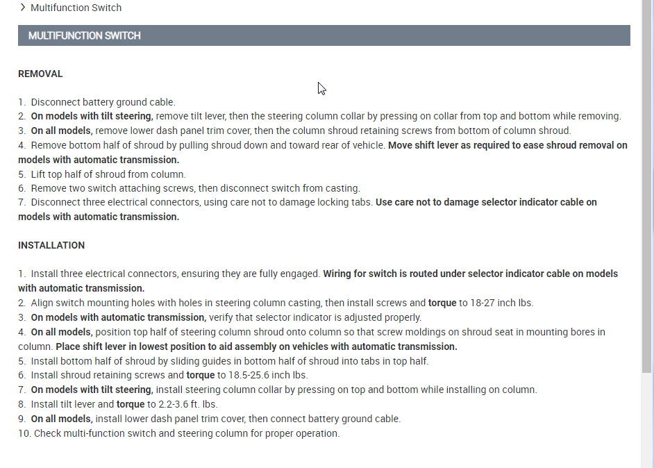

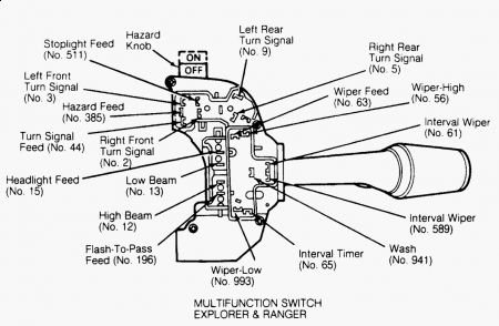

My flashers work, but my turn signals do not. I have checked bulbs, fuses, and the relay.
Wednesday, June 2nd, 2021 AT 1:23 PM (Merged)
ANTHONY EATON
1990 Ford ranger multi switch
+2

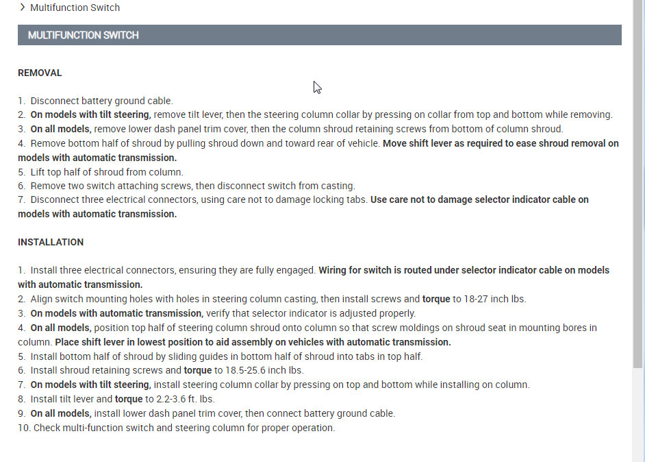

Normally this is a multifunction swtich issue so I am attaching the process below on how to replace it.
However, I am also attaching the wiring diagram because the way to confirm this is to check voltage coming from the switch which will tell us if there is a possible issue.
Please take a look at the info below and let us know if there are questions. Thanks
