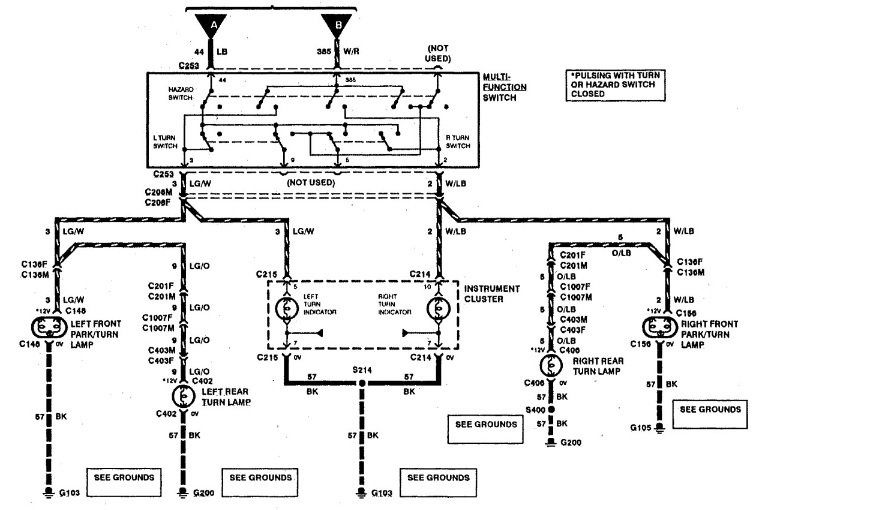

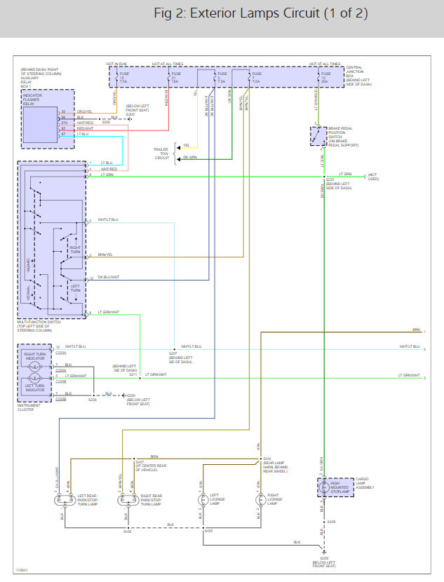

Okay so my boyfriend has the truck listed above XLT super cab 4 wheel drive truck. And we have been having a turn signal problem, so what happened was every time he would turn on either the right or the left turn signal it would automatically blow a fuse every time and we replace that fuse countless times. So then the turn signals quit working all together but the hazards worked for a few days but quit working. so we have replaced the multi switch that wasn't the problem, then we replaced the flasher relay box under the dash, and now we still have no turn signals, but the hazard lights started work again. But the battery light on the dash flickers on everytime we try either the right or left turn signal.
Jan 6, 2021 at 7:43 AM

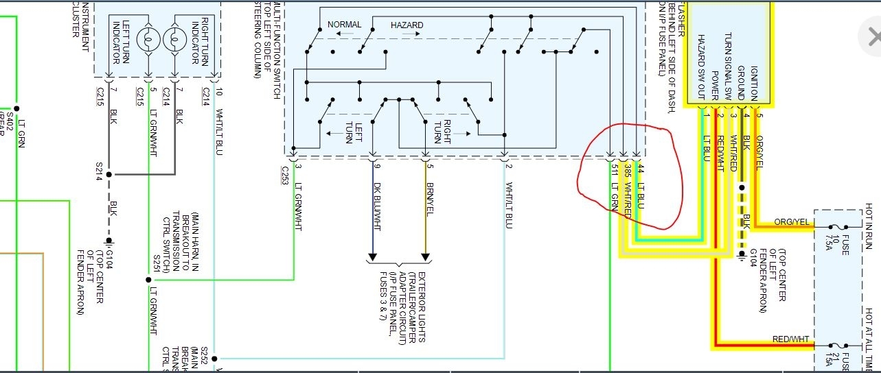

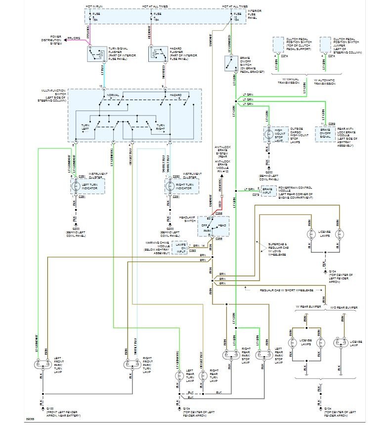

Good evening,
I attached a wiring diagram for you to view. Check the 2 wires I circled at the multifunction switch for power with the key on.

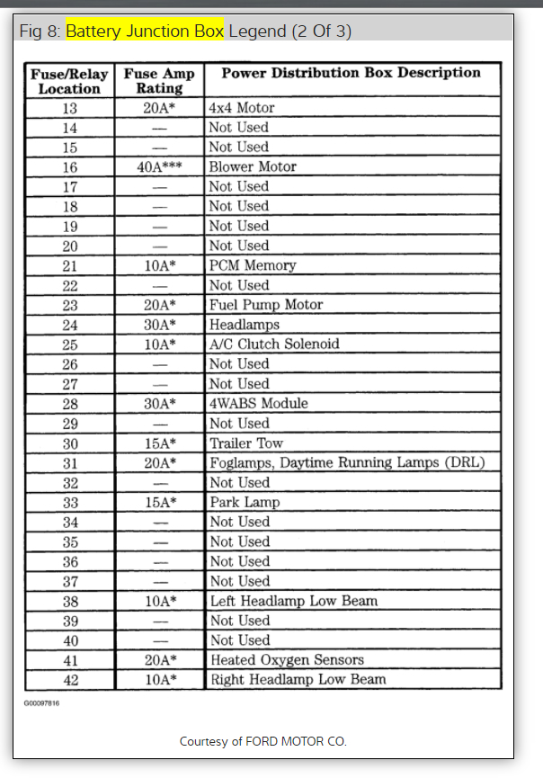

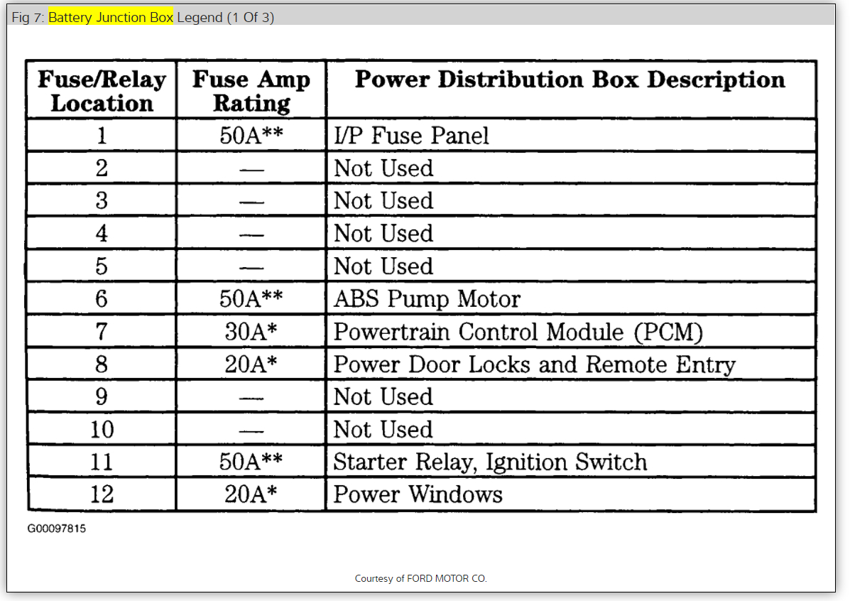

ADUL RAHMAN
Where is the location of the signal light fuse?
Jun 2, 2021 at 6:23 AM (Merged)

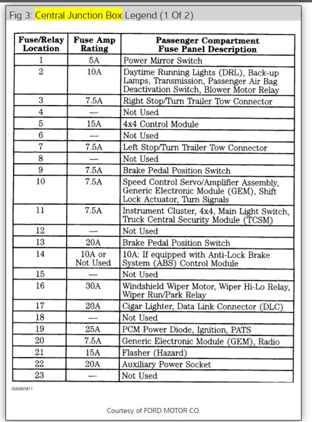

BLUELIGHTNIN6
  • 16,542 POSTS
check fuses 10, 11, 13 and 21. 10, 13 and 21 are in the instrument panel fuse box, fuse 11 is in the engine compartment fuse/relay box. THis guide can help as well

JDL
  • 16,098 POSTS
Note the diagram, the wires underneath multifunction switch, voltage for right and left signals. See A and B at the top that should be voltage from flasher, turn and or hazard. At the lamps, the top wire should be voltage and the bottom black wire is ground. You need voltage and ground.

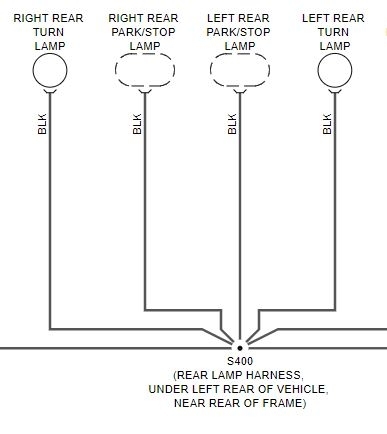

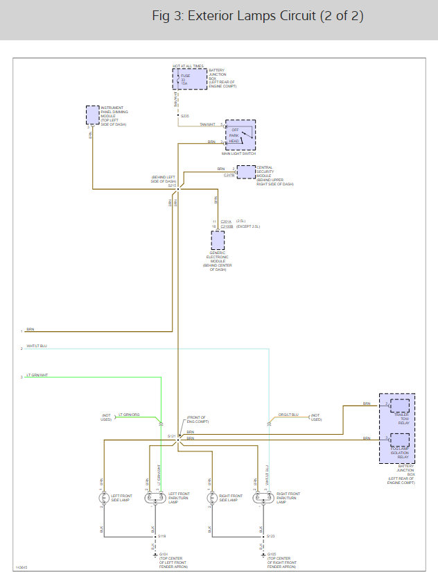

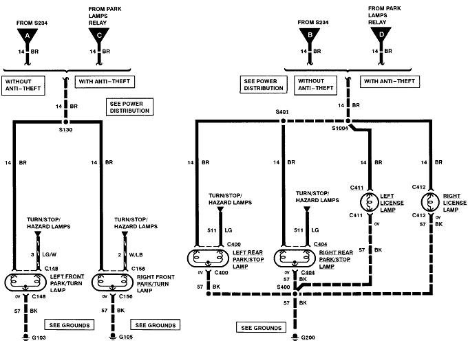

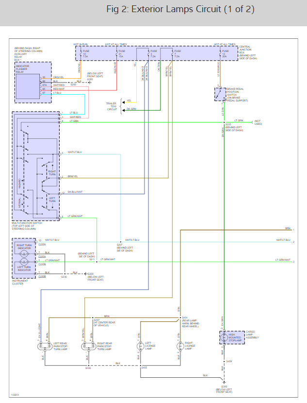

ACGRIGGS
Just started yesterday. Turn signals work and bulbs flash on left and right just fine by themselves. If you press the brake while a turn signal is on the flash accelerates, the rear turn signals on each side flash (dimly) on each side. The front turn signal bulb does flash but is also accelerated. This acceleration and dimly lit light show also happens if I use a turn signal and the headlamps are turned on. Individually, each turn signal works, brake lamps work, everything. It is only the combination of turn signal on with brake pressed or turn signal on and headlamps on.
Any ideas on where to start?
  • 110,251 POSTS
Welcome to 2CarPros.
You have a bad ground. Power is back feeding through other components to complete the circuit. If that isn't the case, then you need to check the wiring harness at the light sockets for shorts, but honestly, it sounds like a ground issue.
I have attached a picture for the lights in question. They all have a common ground. That tells me that either the ground is weak (rust or corrosion) or it is loose and when the added load of both circuits is added, it fails. The schematic indicates ground location.
Check this and let me know what you find.
Here are some general links related to checking wiring and basic tools. I don't know if you need it, but I thought I would add it.
CARADIODOC
  • 34,417 POSTS
This is characteristic of a bad ground wire at the rear. You can identify a clue by turning on the left signal light, then observing the right side will glow slightly. Sometimes that can be too hard to see, so another way to verify this is to remove the bulbs from the right side. If the ground is bad, the left side will stop flashing or it will flash differently. If you turn on the brake lights, you may see the front signal lights glowing dimly. With the rear ground broken, current for the rear lights finds an alternate path through the interconnected front lights, then to ground up there in the front.
Also check if the license lamps are working.
The ground in question is "G200" shown at the bottom of the second diagram. AllData online service manuals went down for service just as I was trying to copy the ground location diagram. Typically that will be a wire bolted to the body sheet metal or the frame near one of those lights. It could be bolted to the box behind a tail light housing to protect it from moisture, or it might be bolted to the bottom of the box.

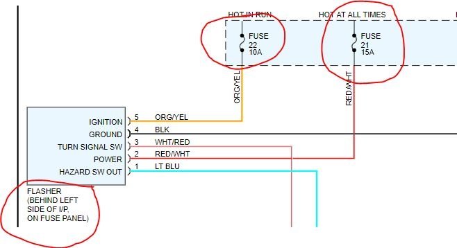

Have no turn signals or hazard lights.

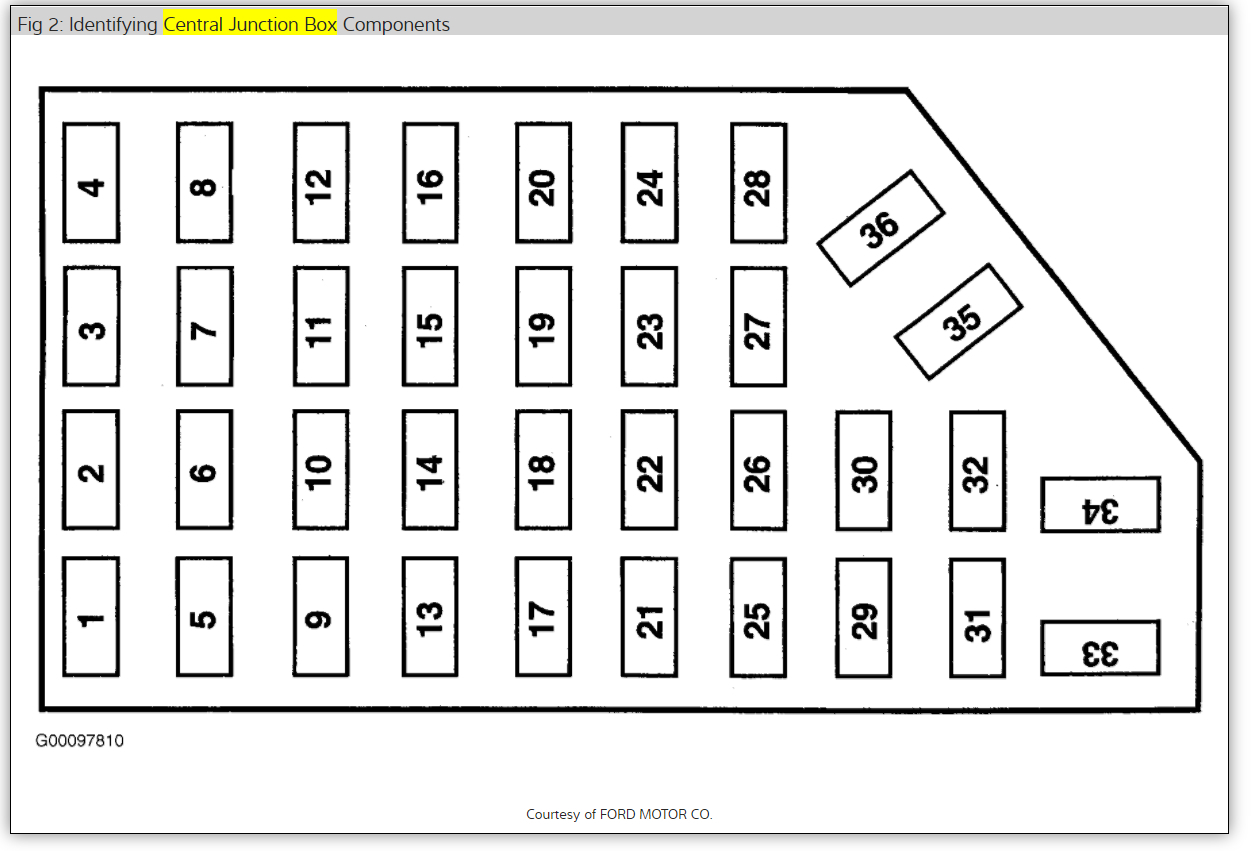

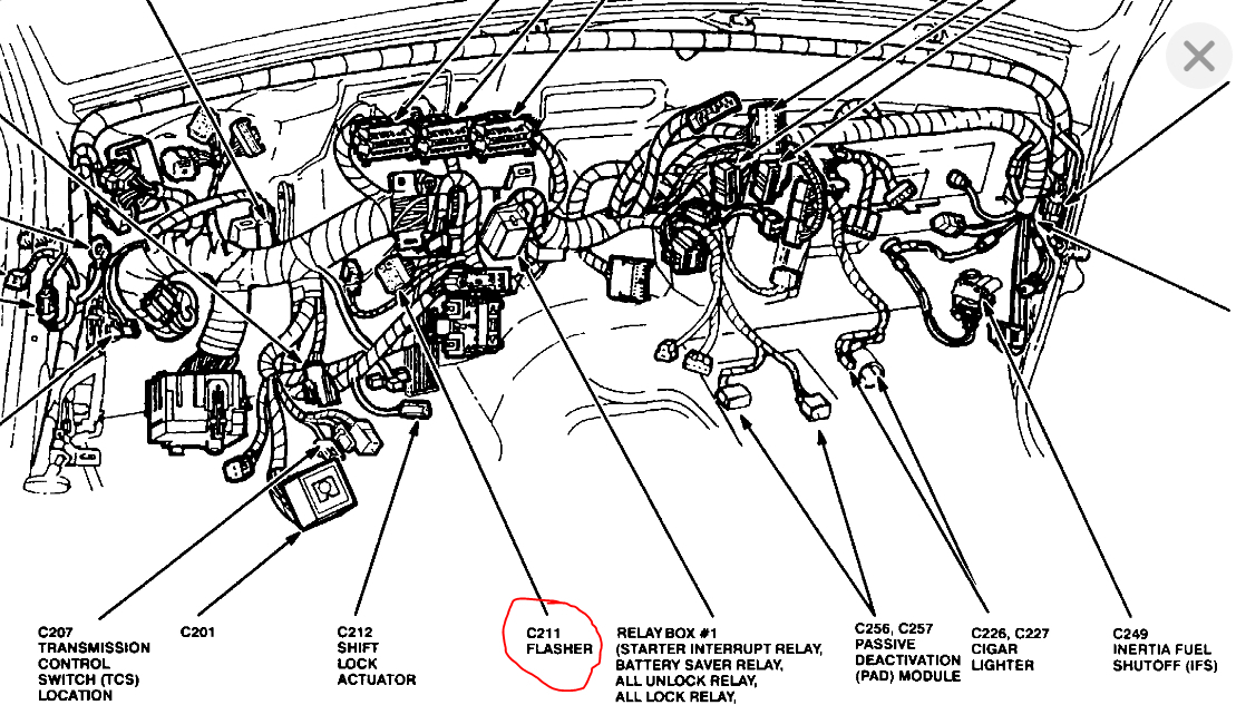

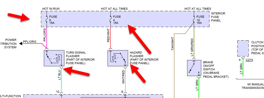

  • 110,251 POSTS
Since neither is working, I need you to first check two fuses in the interior fuse box. See pic 1. If both fuses are good, then suspect a faulty flasher, also seen in picture 1. It could also be related to the turn signal switch, flasher switch, or a wiring issue.
Here are a few links you may find helpful:
Let me know if this helps or if you have other questions. Check the diagrams below.

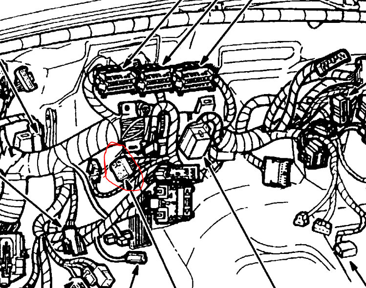

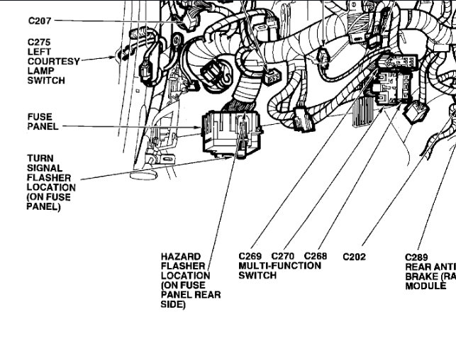

HUNTRON55
Where is the electronic flasher located?
DANNY L
  • 5,648 POSTS
Hello, I'm Danny.
The flasher is located under the dash on the left side of the column near the fuse box. I've attached 2 pictures below and circled in red.Hope this helps and thanks again for using 2CarPros.

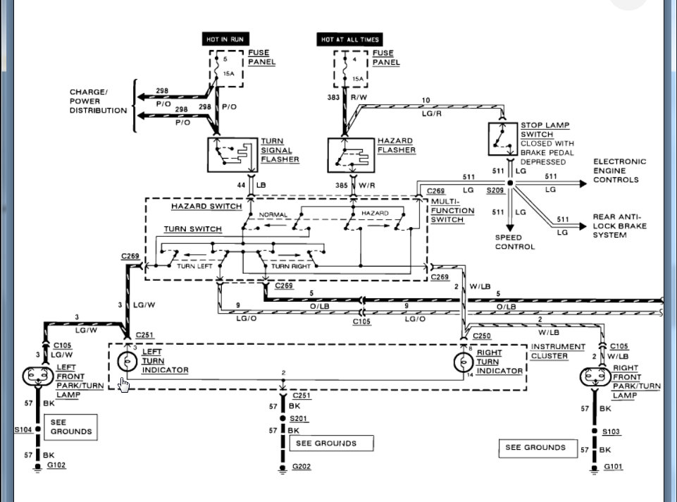

CARADIODOC
  • 34,417 POSTS
The hazards and turn signals use two different flashers. Did you replace the flasher for the signals or the hazards?
Check fuse # 7, a 7.5 amp in the fuse box inside the truck. Here are wiring diagrams for the blinkers so you can see how the system works and test for power loss.
Check out the diagrams (Below). Please let us know what you find.

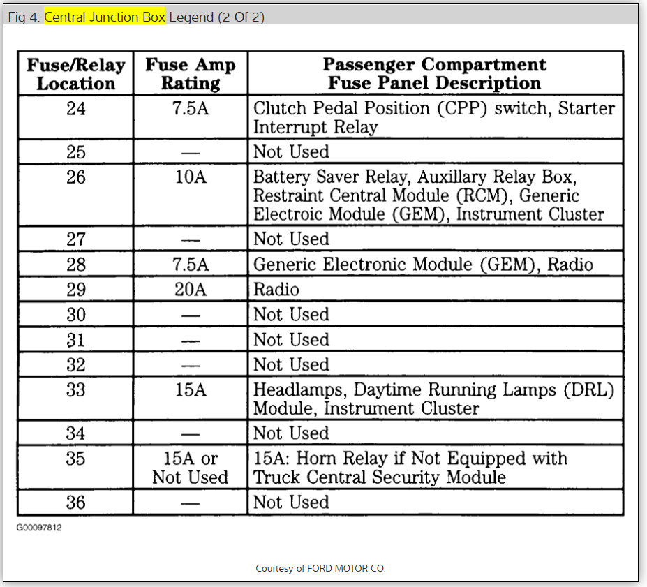

04 FORD RANGER
Hello, I was wondering what would keep my turn signals from working? The hazard lights will not work as well.
HMAC300
  • 48,601 POSTS
check fuses in picture it looks like the flashers are part of interior fuse panel which may need to be replaced or a mechanic may be able to wire two flashers in . Not something for a person to handle. See picture.

Good morning,
The turn signal flasher and the hazard flasher are separate flashers.
I attached a picture of the locations for you.
I would also check the wiring for the turn signals as well if it is blowing a fuse.

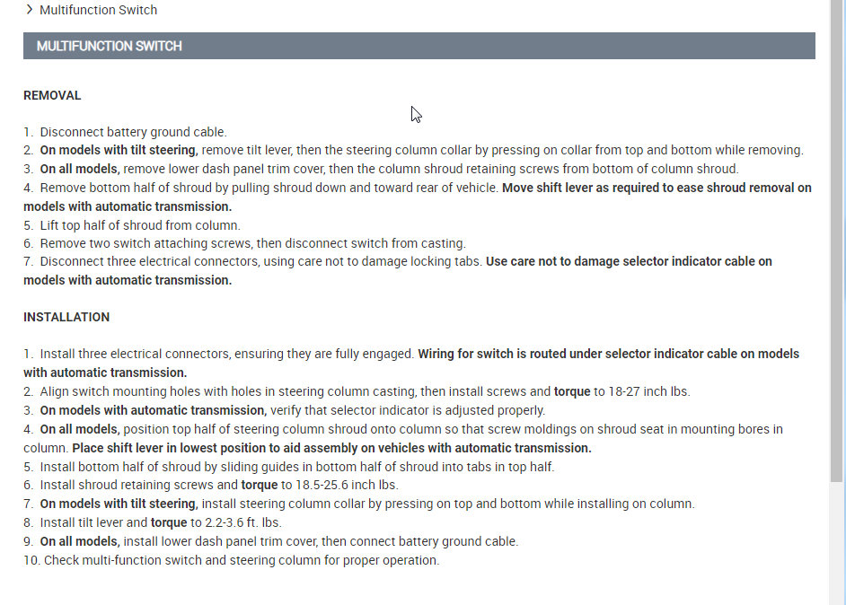

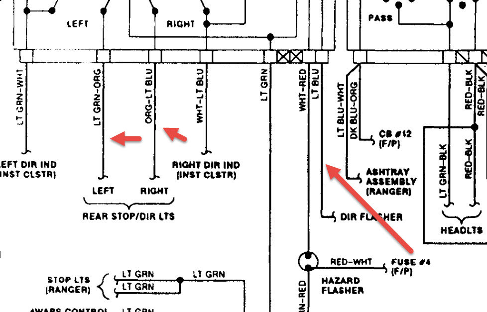

ANTHONY EATON
My flashers work, but my turn signals do not. I have checked bulbs, fuses, and the relay.
ANTHONY EATON
1990 Ford ranger multi switch

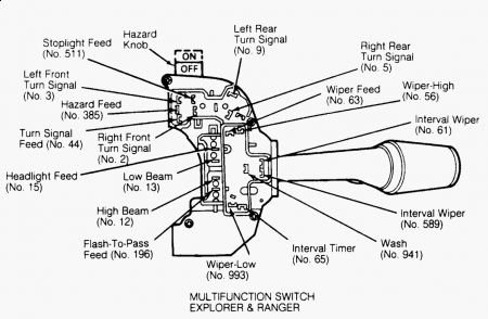

Normally this is a multifunction swtich issue so I am attaching the process below on how to replace it.
However, I am also attaching the wiring diagram because the way to confirm this is to check voltage coming from the switch which will tell us if there is a possible issue.
Please take a look at the info below and let us know if there are questions. Thanks
