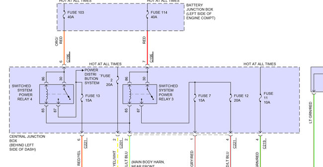

Failed brake light and running light right rear
100,000 MILES • 3.8L • 6 CYL • 2WD • AUTOMATIC
RMORT4726
My lights were working fine when I started my trip, it began to rain heavily then I noticed I had a failed light warning on my dash, I pulled over and found my tail light running light and brake light failed on right rear, left turn signal failed. I checked my light bulbs, good. I also checked my mini fuses in the engine compartment. What could be my problem? I do have a history of my license plate light failing. Can you assist me?
Aug 24, 2016 at 2:27 AM
HMAC300
  • 48,601 POSTS
have a mechanic scan for codes as it may b e the rear electronic module or if you have a trailer connection from factory the trailer module doing this. also check all fuses and relays in pic....
Aug 24, 2016 at 5:06 AM
