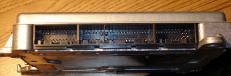

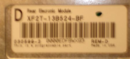

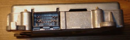

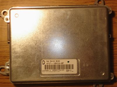

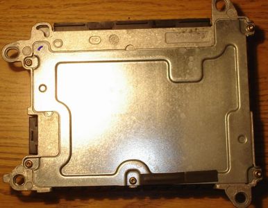

With the help of my old mechanic I found the REM (Rear Electronic Module) behind the jack bracket on the passenger side rear of the van. As fate has it my co-worker has a 1998 LX Windstar with a blown head gasket & trans and is getting rid of it to charity, but he said I can take any part I want from it! Problem is, his is a slightly different LX than mine, it is a Northwood LX model, and when I took the jack panel off his van(which is different than mine) there is nothing behind it and no removeable bracket...so I'm almost back to square one. Anyone know where I might start looking for this big boxy module on a Nortwood LX? The sticker on this thing states: "This is a programmable part" do you know if I can take this module somewhere to be re-programmed?
https://images.2carpros.com/forum/automotive_pictures/272959_REM_1_1.jpg
https://images.2carpros.com/forum/automotive_pictures/272959_REM_2_1.jpg
https://images.2carpros.com/forum/automotive_pictures/272959_REM_3_1.jpg
https://images.2carpros.com/forum/automotive_pictures/272959_REM_4_1.jpg
https://images.2carpros.com/forum/automotive_pictures/272959_REM_5_1.jpg

The scanner returned a code indicating that the REM needs to be replaced. It is a generic solution since the module could be re-programmed but it needs to be "fixed" either way. While I had the module exposed and still plugged in I started pulling the plugs(there are five), when I pulled one of them the rear tail parking light which is working went out, another one turned out the courtesy lights. If I can find the REM in my co-worker's Northwood LX I can at at least try it, problem is, where is it? It's not where mine is....same van, same year, same model (LX vs Northwood LX) why the heck does Ford do this?!

I just discovered it's a '99. I just got it from my sister, who told me it was a '98, when I checked the title I saw it was a '99. I dropped the module off at a local used autoparts yard, biggest around here, fully computerized etc.
The guy there told me he's been looking but has not found one that matches mine yet. He asked me if the sliding doors on mine are electric, they are not, manual only, I don't think the motorized doors were available in '99. He told me my REM is showing that it's for a van optioned with the electric doors....? Don't know how this would be possible unless his system is just spitting up the wrong data. I hope he finds one soon!
Apparently there are several different versions of this module depending on how your van was optioned.

If you look at the pics I posted you will see a close-up of the sticker on the module, it's fuzzy because I could not focus that closely with my camera, but that is the part #. And it's been working fine for 9yrs so I imagine it is correct for my van. I am leary of installing a part with a different part#, unless a Ford Tech. could verify it's okay to do it.
