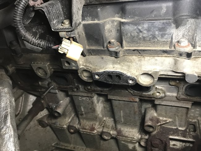

This was our vehicle originally, our son owns it now. Cracks developed in the exhaust manifold. He was able to remove the manifold; however, numerous bolts were broken even before the removal. Can you recommend specific extraction tools, techniques, insight he can use in removing the studs in the block on this specific 4.2L six cylinder engine?

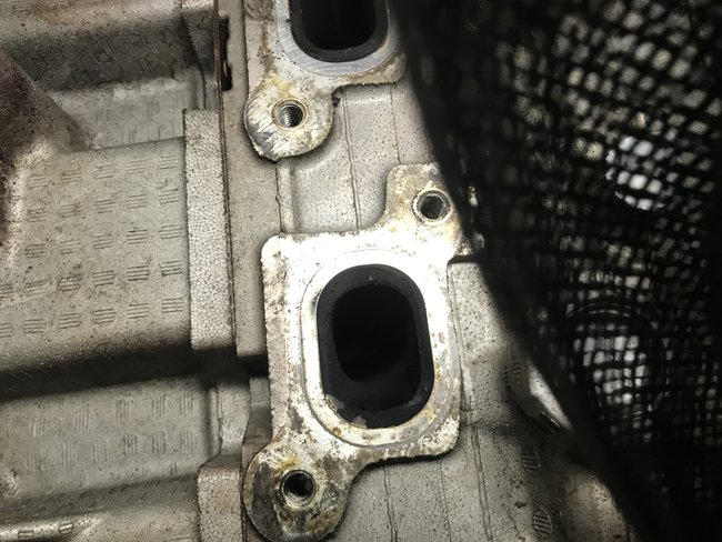

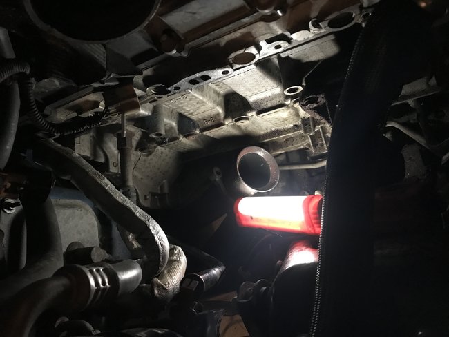

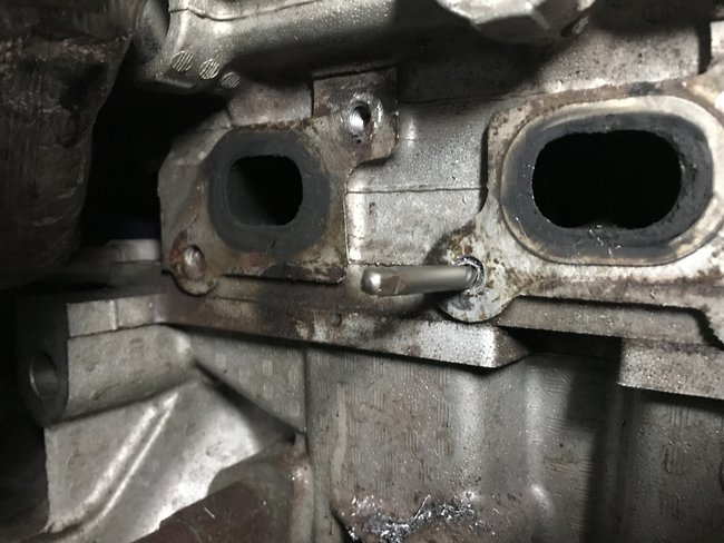

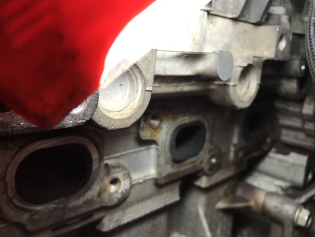

Here are the pictures:
Dec 20, 2019 at 6:42 AM
I only see 2 broken bolts.
The one with the easy out, did you heat up the area with a torch to see if you can extract it?
Dec 21, 2019 at 5:03 AM
SIRJR
  • 86 POSTS
I know he hadn't used any heat in trying the extraction. Could you explain the correct procedure using heat to remove the broken bolts in the block. Thank you.
Dec 22, 2019 at 12:46 PM
You need a torch and heat up the area around the broken bolts. The aluminum will expand and release the bolts so they can be extracted.
