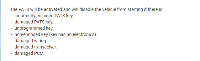

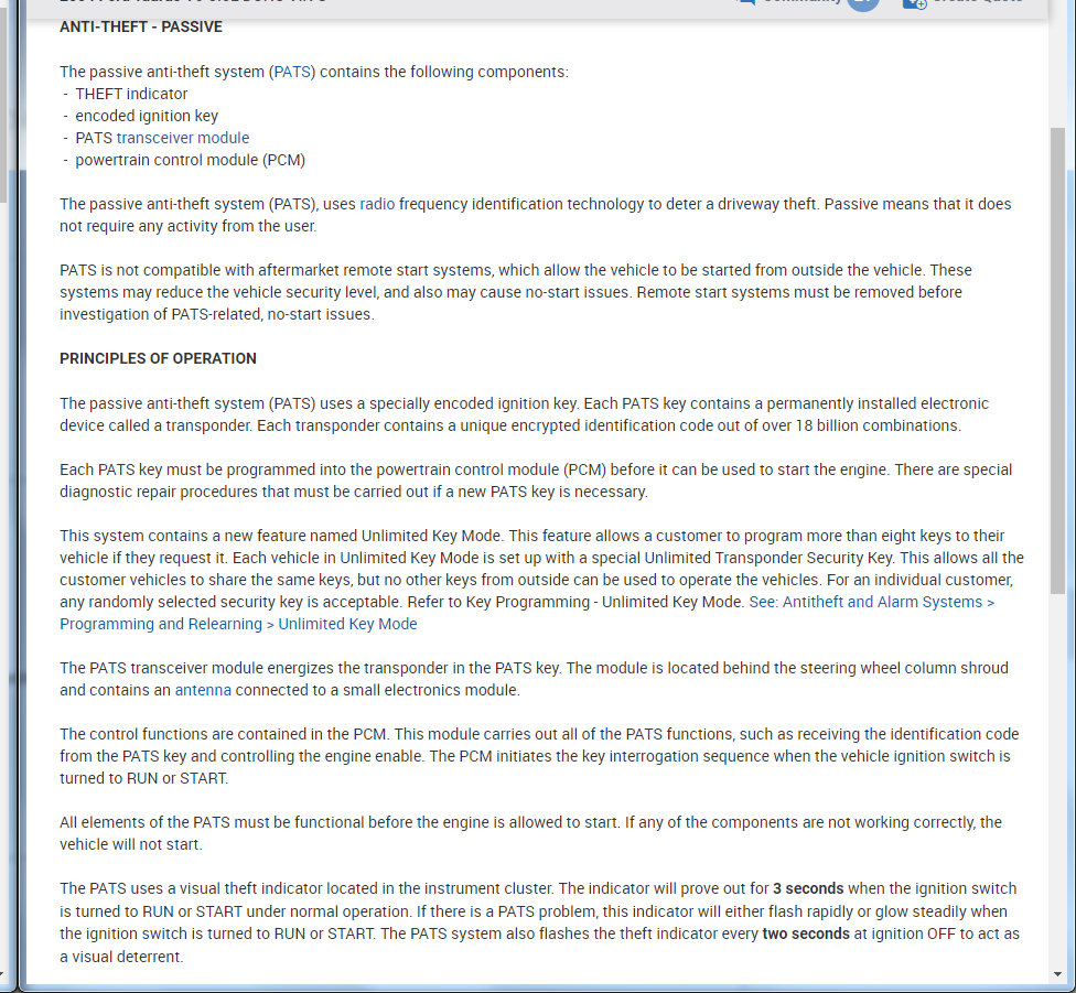

You cannot cut the system out. The only way to bypass this system is to get a PCM that is not dependent on it. Meaning it will start the engine with just an ignition switch input and not a specific code.
Please see the attached information below on this system and it will show that we cannot bypass it. Please let us know if you have other questions. Thanks
