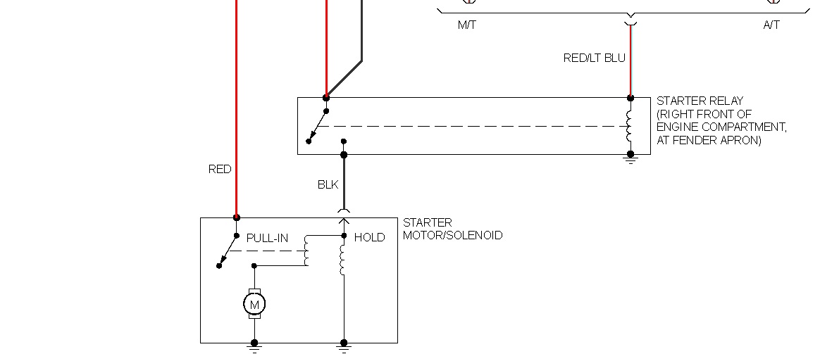

my starter is not working to crank the engine over?
168,000 MILES • 4.0L • 6 CYL • 4WD • AUTOMATIC
LLCUTTERLL
It's been hard starting for a couple of months, that's to say that once in awhile rather than when I hit the key and it just starts right up, it takes a couple of cranks, kind of slow cranks before it starts.
Only one time before has it not started when I went out, and I waited several minutes, and it started. today it would not start at all. After I waited several minutes it still wouldn't start. After trying to start it several times the battery finally died and all it did was click. One click, not multiple.
After trying to jump the truck, it did nothing for the battery, and I bought a new one. Upon placing in the new battery, it still would not start. And I only get one click.
Jul 1, 2020 at 11:53 AM
  • 110,248 POSTS
First, make sure the battery you installed is charged, the battery cables are clean and tight, and there is nothing that appears damaged on the wiring.
Next, you indicated that it cranked slow. Is the slow cranking what caused it to be hard to start?
As far as the one click, if it is coming from the starter, either we have a weak connection, weak battery, or the starter is bad. Here is a link that explains how to check the starter. You will need a helper. Note that the larger wire on the starter has 12v at all times, so be careful when working around it. The smaller wire on the starter show only have 12v when the key is turned to the start position. If you have 12v to the smaller wire and everything I mentioned to check is good, replace the starter motor.
Here is the link:
If you find the starter is bad, here is a link that explains in general how one is replaced:
Here are the directions specific to your vehicle for removal and replacement:

Check and test the transmission range switch
Dec 31, 2020 at 1:24 AM (Merged)
JDL
  • 16,098 POSTS
Rasmataz is correct. There are two hot wires at the starter. One is hot all the time, the other goes hot with key in the crank position.

FIXITMR
  • 9,989 POSTS
click and lose all power sounds like a bad connection from/at the battery. clean all your cable ends and battery posts including where they go to car. what do you mean it sounds like a bearing is going out? is the engine froze up? did you mean alternator bearing? lose all power sounds like starter is drawing too much amps or battery is not good! or bad connections!
FIXITMR
  • 9,989 POSTS
if that checks out good then take out starter and test.

Ok, here is something to try.... when the vehicle won't start open the hood right next to the Batter is a Starter Relay Switch just follow the Positive cable to it. Jump the 2 large terminals. If Vehicle Starts replace that relay.
Dec 31, 2020 at 1:25 AM (Merged)
JAKE122288
  • 9 POSTS
ok well i went ahead and replaced that starter relay thing....and still sitting at the same click....my next thought is the gear thing....i dotn know what its called....it prevents the vehicle from being started if its not in Park or neutral. i need 2 know where wires or this sensor/relay/whatever it is is located so i can see if thats my issue...and if that doesnt work im left with no choicer but 2 replace wires even tho they look fine. Thanks again for everything
BMRFIXIT
  • 19,053 POSTS
Try this
key off (KEY OFF )
E brake on
jump the two terminals on the starter (big and should have power at all time
and small switch only )
and it should crank
have you checked the fuses
do you have an alarm system that may effect in this mater
make sure you have power at the starter and also check for ground
let me know
