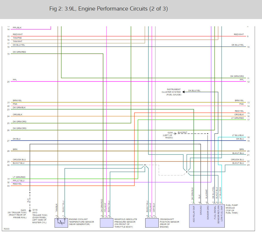

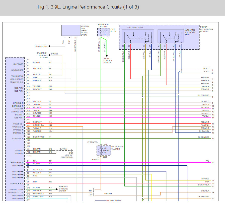

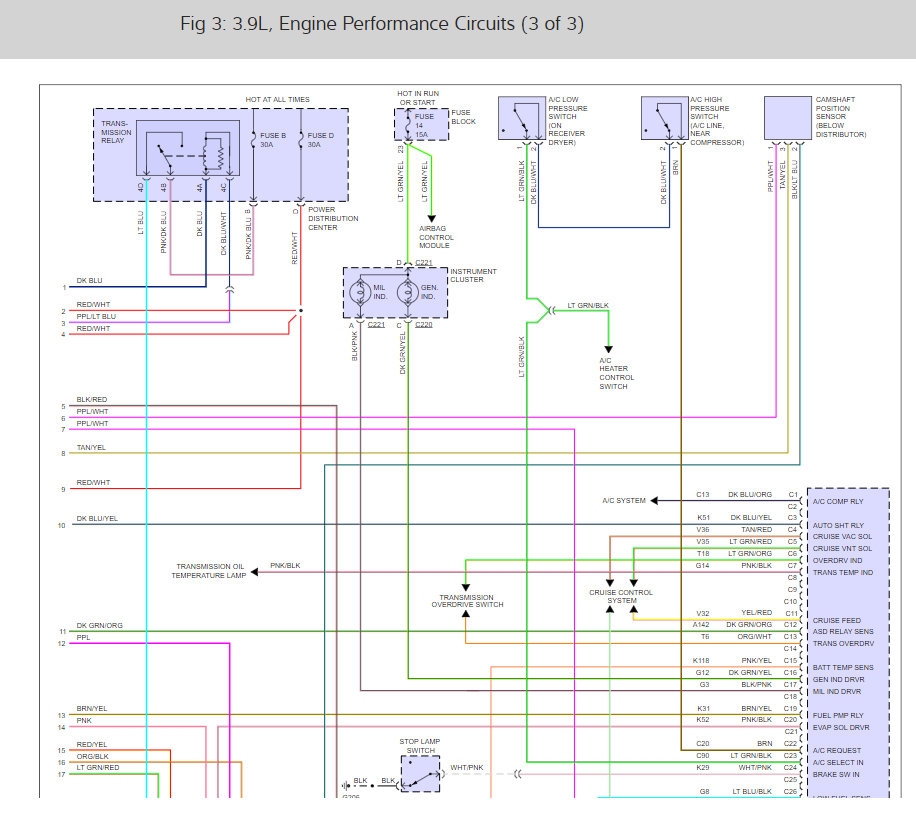

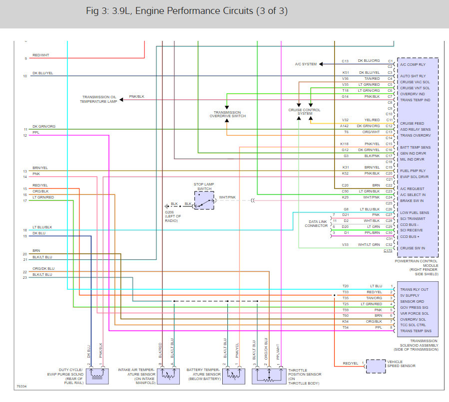

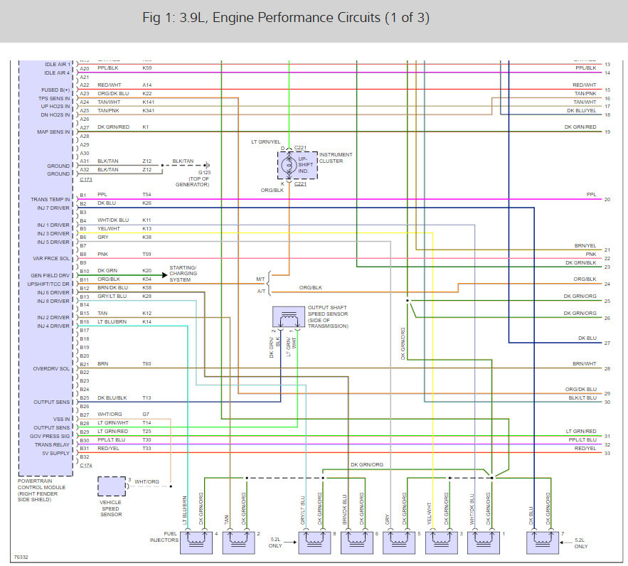

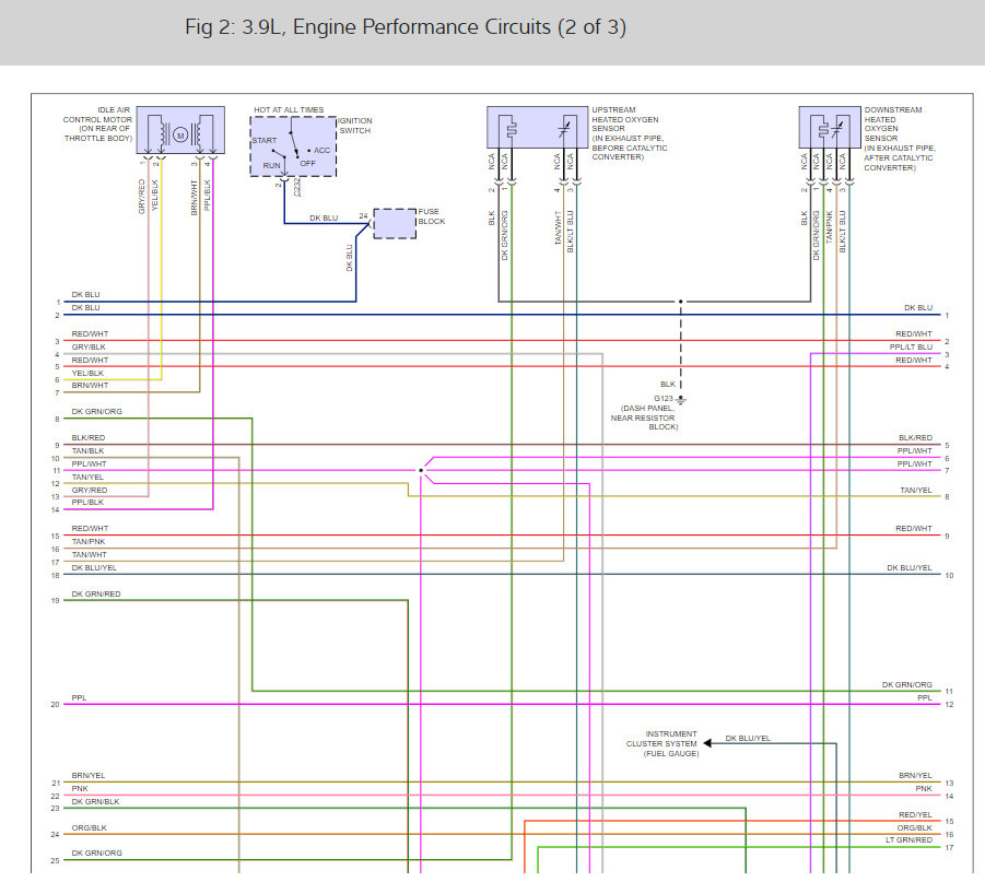

Well, this is it. After all is said and done Mr. Compo has done all that he can. Four new sensors and still no start. Locals will only help if my truck becomes their contract item. Those of you who have assisted me in my situation have been awesome. I have worked with my former on his vehicles and motorcycles, before computers, and I am sure if he were here he would have it running. He passed away some years ago. I do have one more option and that is going to a larger auto shop with more sophisticated equipment, but that will take a bit of time. Many thanks for all your input. I understood what you were telling me as I have the Chrysler shop manuals for my truck, but I chose the wrong mechanic. If you do not have the right equipment and run into a problem you can only go so far. Again, many thanks . All of your directions were on the money. Keep me in mind because when I do get it running I will definitely let you know what the glitch is/was causing the problem. EDawson.
Yes please let us know, we are missing something here. Bad grounds? Wiring connection something.

What a mess. My bet is that the wiring harness for the crank sensor (and other wires) got pinched between the bell housing and block as they were bolted together. They did not verify it was not there and just tightened everything down. Then did not bother to actually check for that.
