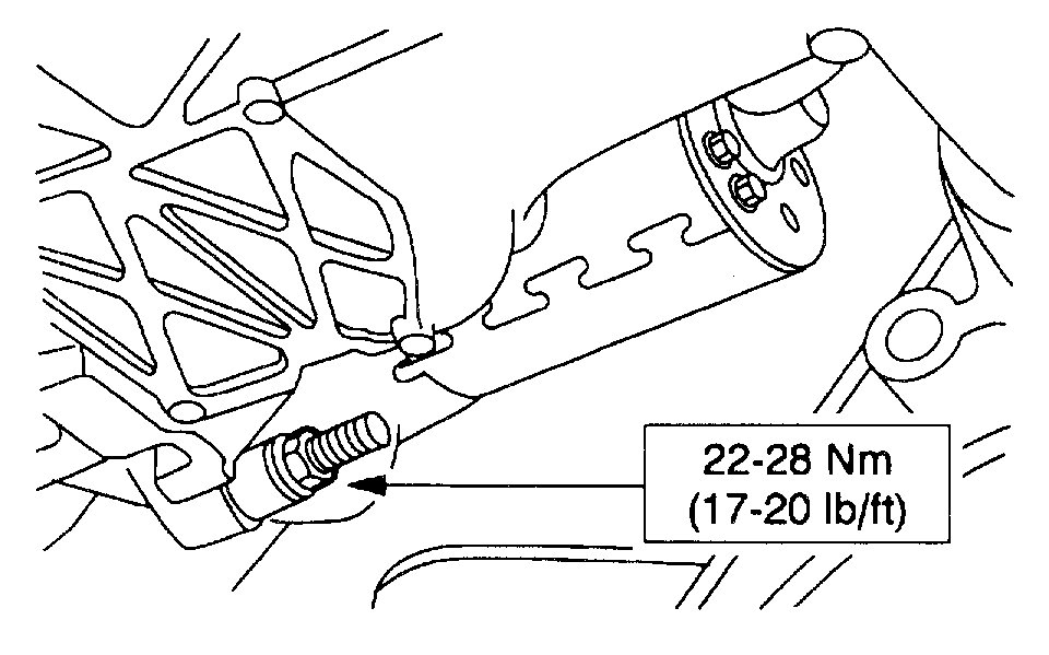

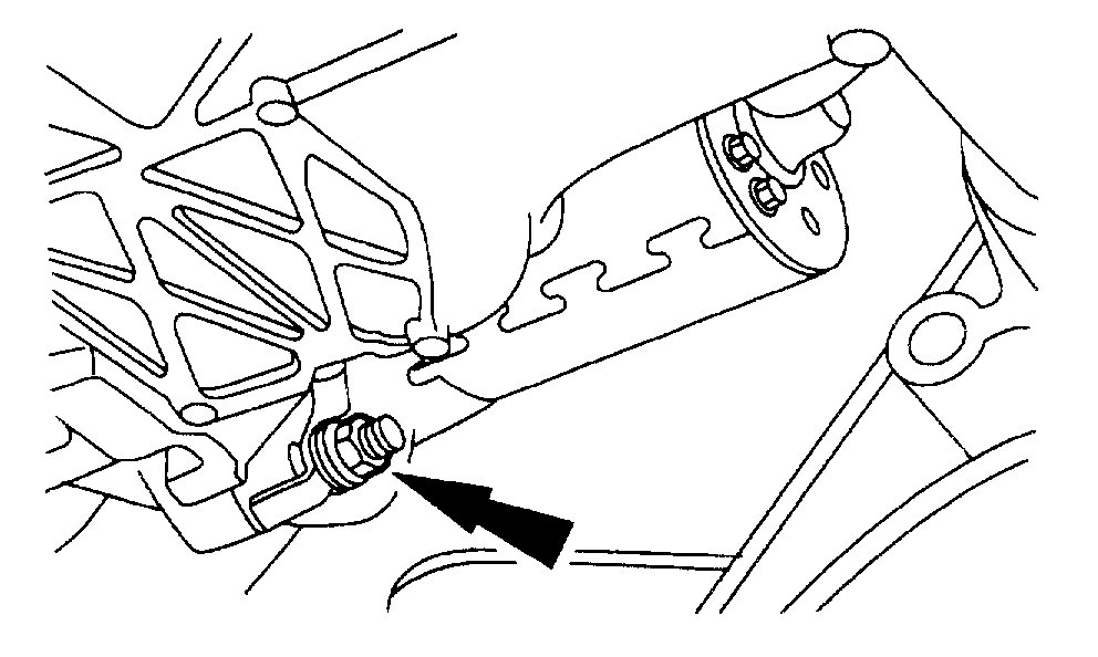

My vehicle has eaten two starters over this weekend it ate my second starter it won't start. I had to shim my second starter and that held out for about a month it would do the the rapid metal thing like the gear on the starter wasn't disengaging. I shamed it that stopped and then all the sudden it it's not even starting now.
Thursday, December 31st, 2020 AT 8:58 AM (Merged)
  • 109,885 POSTS
Welcome to 2CarPros.

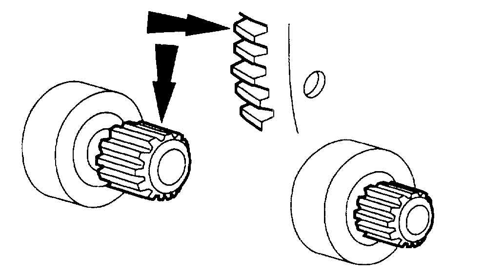

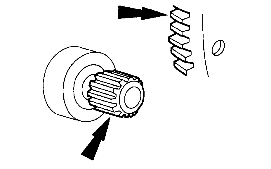

At this point it's not starting. What is happening? Does the starter grind when you try? Does it do nothing? Does it spin but not turn the engine?
Since you have been having issues, I'm starting to question the flywheel itself. It may be damaged or even cracked.
Here is a link that shows in general how to replace the starter. Take a look and see if there is anything that you may have missed.
Next, here are directions that show how to check the starter and flywheel. Pictures 1 and 2 correlate with these directions,
STARTER DRIVE/FLYWHEEL RING GEAR INSPECTION
1. Remove the starter motor.
pic 1
2. Check the wear patterns on the starter drive gear and the flywheel ring gear. If the wear pattern is normal, install the starter motor.
pic 2
3. If the starter drive gear and the flywheel ring gear are not fully meshing and both of the gears are scored or damaged, replace the starter motor. If necessary, replace the flywheel.

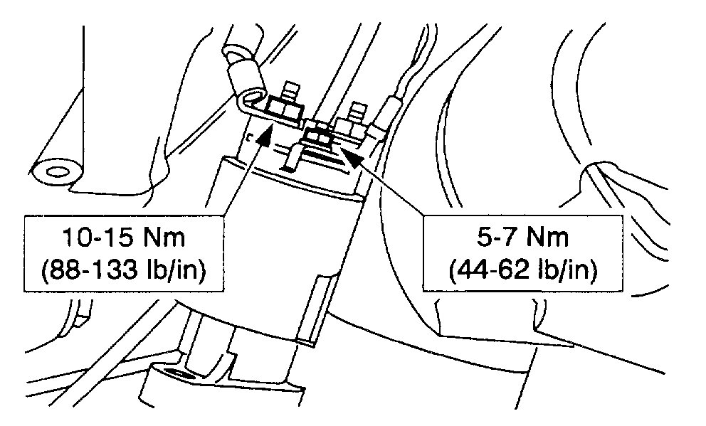

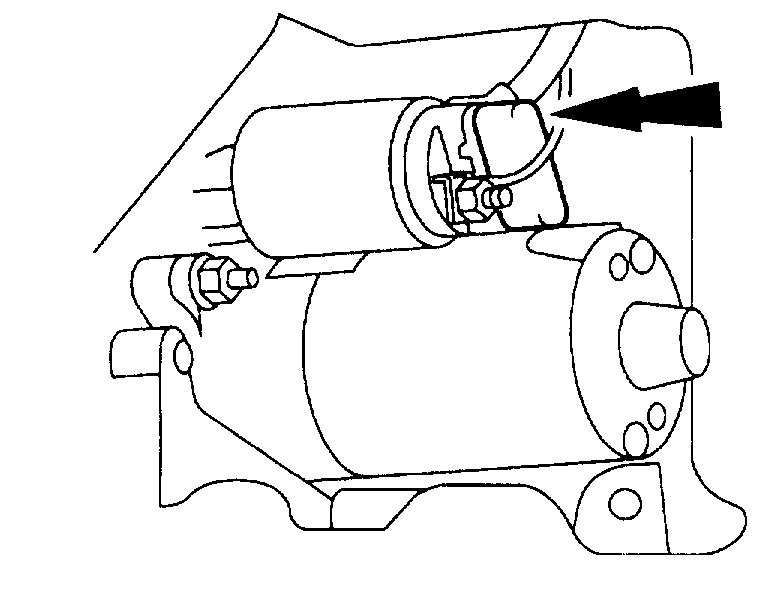

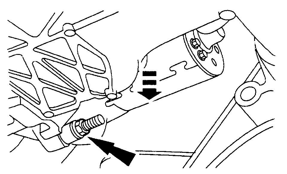

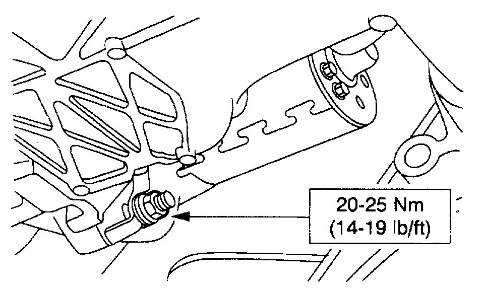

Here are the manufacturer's directions specific to this vehicle. Take a look through them also. The remaining pics correlate with the directions.
REMOVAL
WARNING: WHEN PERFORMING MAINTENANCE ON THE STARTING SYSTEM BE AWARE THAT HEAVY GAUGE LEADS ARE CONNECTED DIRECTLY TO THE BATTERY. MAKE SURE PROTECTIVE CAPS ARE IN PLACE WHEN MAINTENANCE IS COMPLETED.
1. Disconnect the battery ground cable.
2. Raise and support the vehicle.
pic 3

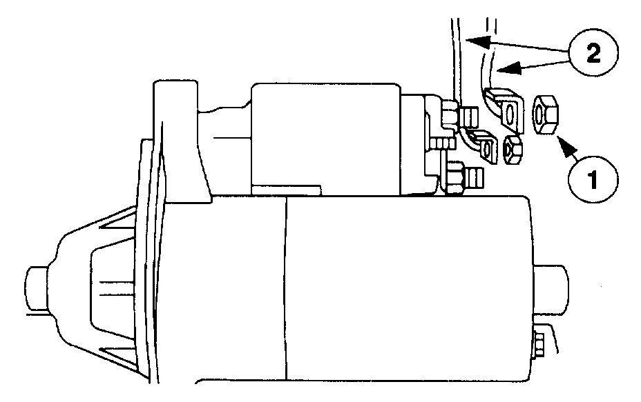

3. Remove the starter motor solenoid terminal cover.
pic 4
4. Disconnect the starter wires.
1. Remove the nuts.
2. Disconnect the wires.
pic 5
5. Remove the nut and the starter ground cable.
pic 6
6. Remove the bolt and the starter motor.
INSTALLATION
pic 7
pic 8
pic 9
1. Follow the removal procedure in reverse order.
NOTE: When the battery is disconnected and reconnected, some abnormal drive symptoms may occur while the vehicle relearns its adaptive strategy. The vehicle may need to be driven 16 km (10 miles) or more to relearn the strategy.
____________________________________
If this isn't helpful, let me know the specifics.
