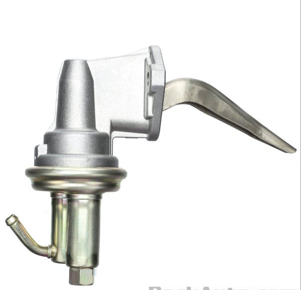

So let's start with a fuel issue. We want to start the engine and when it stalls, try to spray some starter fluid in the carb and try to start it.
If it starts then we have a fuel delivery issue so we are going to want to check and make sure the pump can deliver pressure. You do this by removing it and operating the arm and see if the diagram pushes air out the nipple on the bottom of it.
The way this works is the arm shown in the picture below rides on a cam lobe and as it spins it moves this arm up and down and that creates the fuel pressure needed to feed the carb.
