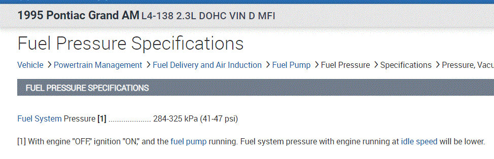

It sounds like you might have a weak or failing fuel pump not providing adequate fuel pressure. Have you tested the fuel pressure? I would suggest performing a fuel pressure test. Here is a tutorial showing what is involved:
After performing this test get back to us with the results and we'll go from there. I've attached a picture below showing the proper fuel pressure for your vehicle. Hope this helps and thanks for using 2CarPros.

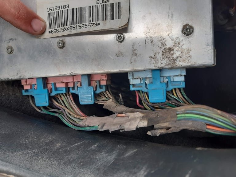

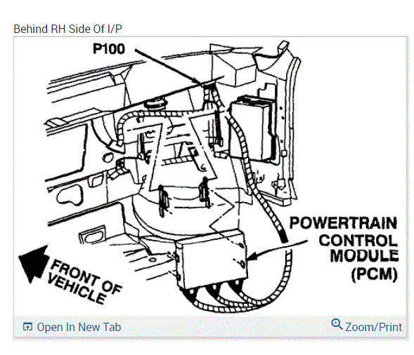

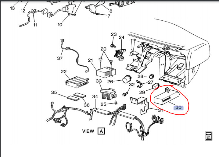

You are correct. The PCM is on the passenger side under the dash. I attached a pic below.

So Danny my dear, I found no field to reply for your answer, i wanted to tell you that my vehicle doesn't seem to have any pressure checking facility (valve), all fuel delivery and return lines are tightly sealed connections that demand a special plastic tool to easy detaching. if there had been a check point it would have helped me track and see if the pressure falls at any moment. Still, I needed to know the designated pressure value that you kindly provided, the fuel pumps we use here are all Chinese brands (usually sold here at 10-15 USD/each) with 10 kgf/square cm pressure upon installing. I started with replacing the old fuel pump and the fuel filter to eliminate any probability of a faulty one of these two items. I am talking about some 142 PSI here.

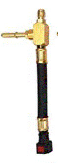

If you have 142 PSI, I'm surprised the entire engine isn't full of fuel. I attached the manufacturer's specs below. You are way above them.
As far as the test port, if there isn't one on the fuel rail, you will need to disconnect the supply hose from the fuel rail and place a T connector there. One side will have a Schrader valve on it and the other two will be for fuel to go through.
If you look at pic 2 below, it shows what I am referring to.
Let us know what we can do to help.

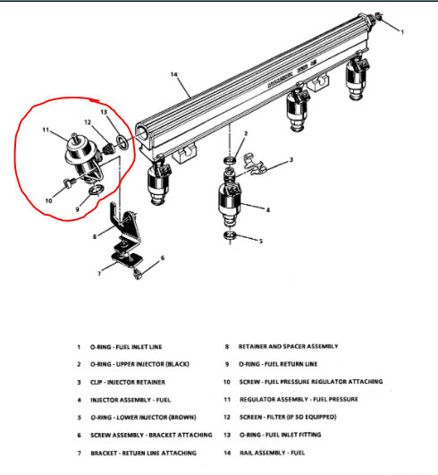

  • 110,251 POSTS

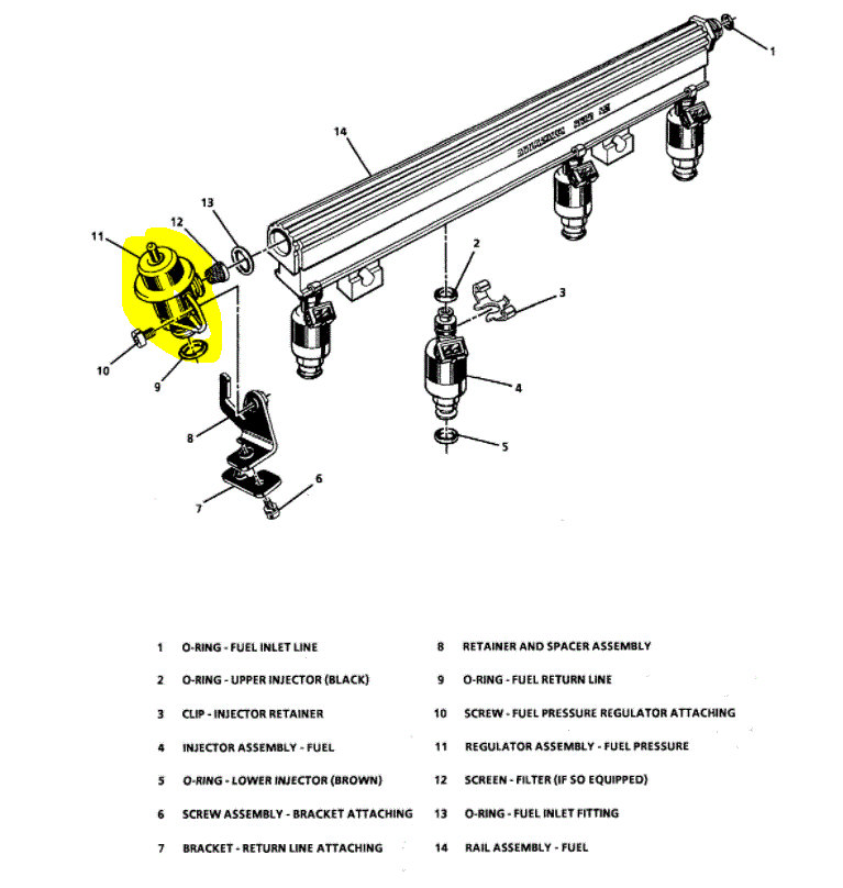

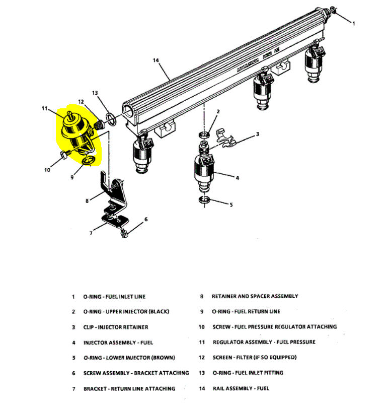

There is a fuel pressure regulator which is designed to maintain a specified pressure. It is actuated by engine vacuum. Make sure the hose is connected and there is vacuum to it.
If you look below at pic 1, I attached a picture of the fuel rail and highlighted the regulator.
Let me know what you find.
See pic below.

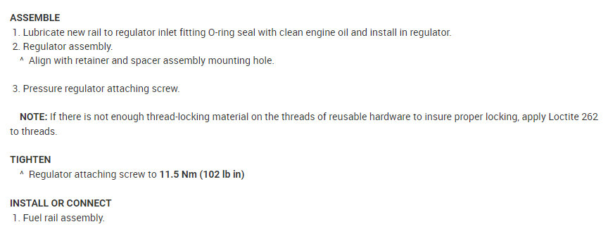

Hello again.

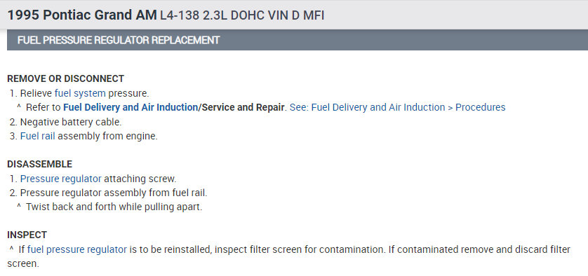

It definitely seems your fuel system is over pressurized. I've attached picture steps below on how to replace the fuel pressure regulator including its location circled in red on your Grand Am. Keep us updated. Hope this helps and thanks again for using 2CarPros.

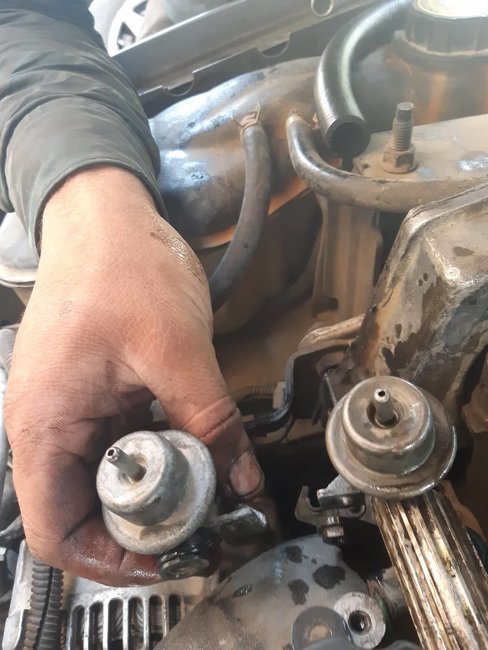

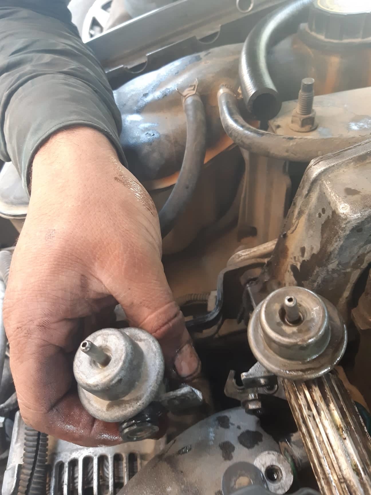

Danny my dear friend, one question please regarding the replacement of the fuel regulator valve. I managed to get one (second hand, as usual, there is no brand new one) but upon trying to replace it it turned out that it is a different layout with the base plate having an Allen bolt to the right rather than to the left as in my own engine. I am attaching an image to clarify things, could the replacement valve be taken from a 6-cylinder engine (for Pontiac Grand Am 6 cylinder)? I tried to loosen the big nut so that I can tilt the plate to the other side and ease its installation on the fuel rail but boy, it could never be turned.
Jun 3, 2021 at 6:35 AM
DANNY L
  • 5,648 POSTS
Hello again.
Yes, you acquired a fuel pressure regulator from the V6 engine Grand Am. Although they both supply the required 41-47 PSI pressure they both mount to the fuel rail differently as you are experiencing. You will need to find a 4 cylinder version fuel pressure regulator to mount correctly. Hope this helps and thanks again for using 2CarPros.

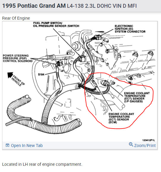

I replaced the 6-cylinder one for a 4-cylinder one. Nothing changed and I got depressed as in every unsuccessful attempt, the engine returned back to the hard starting and intermittent stalling but at a much less rate. A friend of mine suggested seeing an electrician that he trusts. i went there and he suggested that a temp switch that is responsible for cold starting is the prime suspect. That brass switch located right beneath the brake and ABS assembly ( hard to reach) had two wires of its harness worn out with their copper strands touching each other. He parted them a bit, a solution that can be further perfected tomorrow, I will replace the switch and isolate its wires from each other. Seems like rust never sleeps with me! yet it is a progress considering the vague diagnosis in absence of scanner and working OBD DLC. I drove it back home ( some 25 km) and it looked like healed but I have to avoid over-optimism this time and allow for some 2 weeks time to make sure it is over this time..
Jun 4, 2021 at 11:45 PM
DANNY L
  • 5,648 POSTS
Hello again.
I've attached a picture below of the coolant temperature switch location I believe you are talking about. One switch that sends a signal to the ECM-engine control module and the other switch is a sending unit to the warning light on the dashboard. I believe the switch sending single to the ECM is giving you trouble. I've attached pictures steps below for replacement including their location in red. Hope this helps and thanks again for using 2CarPros.

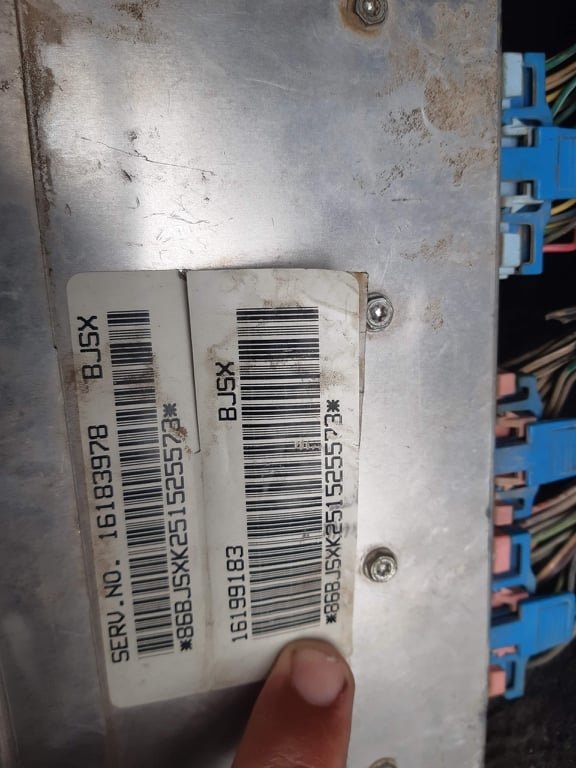

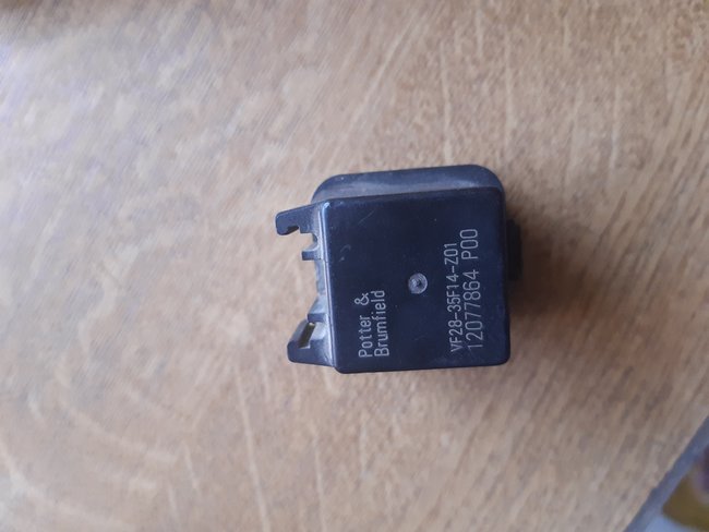

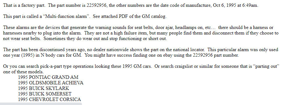

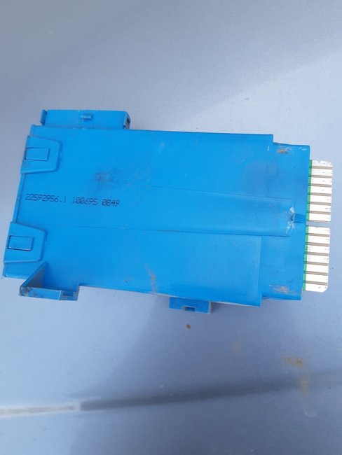

Hi dear Danny. Upon dismantling the whole dashboard block last week I came across this blue monster, any idea what it is and what does it control? It came right to the left side of the steering column.
Jun 5, 2021 at 5:55 PM
DANNY L
  • 5,648 POSTS
Hello again.
I tried running those numbers but nothing came up. Are there any other markings, numbers, or stickers on the other side? Look forward to hear back from you. Thanks again for using 2CarPros.
Danny-
Jun 5, 2021 at 11:33 PM
YASIRDAHHAM
  • 186 POSTS
No my dear, I took a pic for the side that carries some marking, the other side is blank. My electrician said it doesn't look like the cause of my problem, and to support his POV he extracted it out and operated the engine. In fact, nothing changed, the engine worked as usual and stalled as usual too. You can drop this thread as long as it had never been an issue for earlier customers/members. I thought that as long as I have gone as deep as dismantling the whole dashboard then I would better seize this opportunity and give an idea of what I had found therein.
Jun 6, 2021 at 5:13 AM

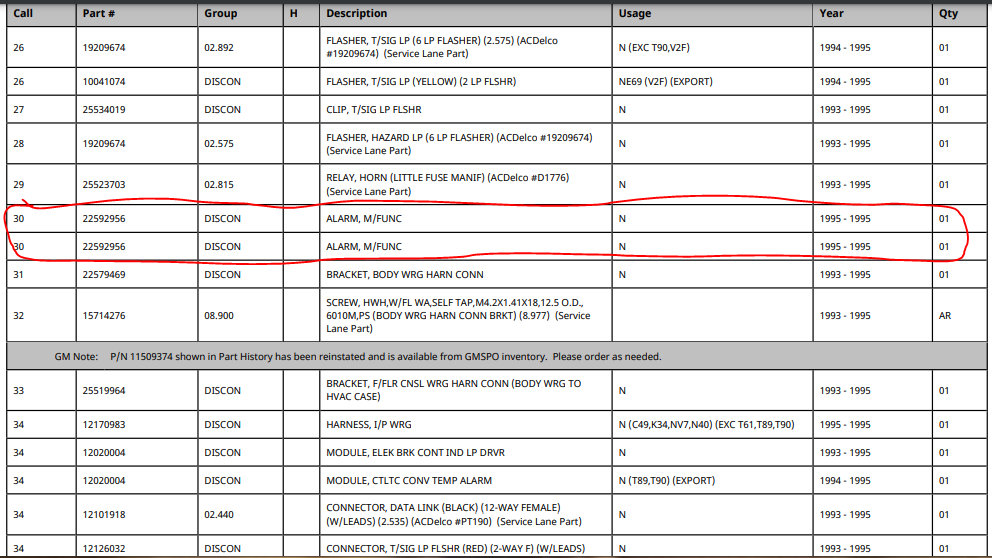

I found out what the blue cartridge is for. That is called the multi-function alarm. That is what makes the chime noises when the headlights are left on, doors left open, unbuckled seat belts, etc. That part is discontinued and will need to be found used if needed. I've attached a few pictures for you below. Hope this helps and thanks again for using 2CarPros.

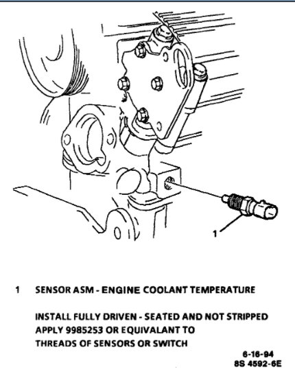

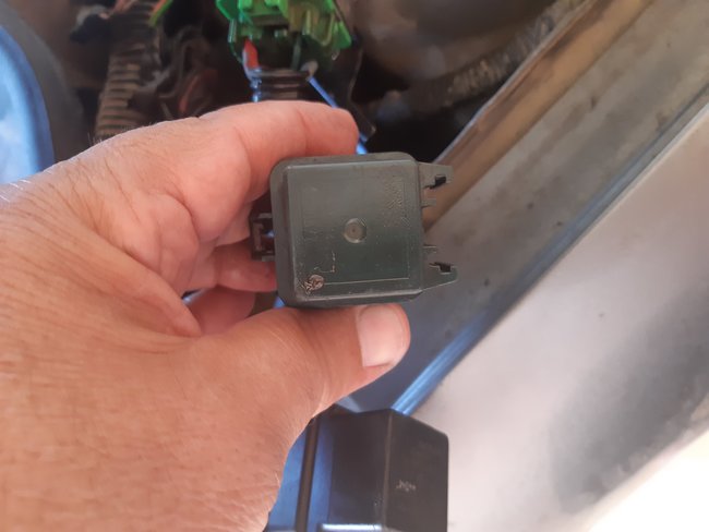

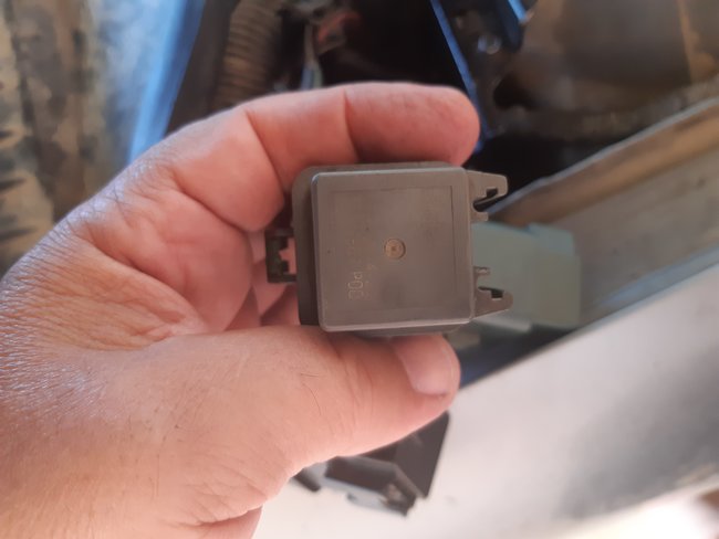

Great thing that you had sent regarding the coolant temperature sensor, especially the pic that states how it can affect the PCM signal to fuel system. I tried my best so far, but due to the chaos that had been made with the 4 relays that are located in a pocket like enclosure right above the front right mud guard, I need your help to let me know which task does every relay have and what is the original part number of each of them, can you please? They were once all (Potter & Brumfield) brand , one for the engine coolant radiator fan, another for the A/C system, one for the fuel pump, the fourth is vague to me. Now after several attempts from my car mechanic the engine is still experiencing those sudden blackouts (which i will try dealing with that coolant temperature sensor) but I need to retain the default pattern of the 4 relays, what are their part Number. I know of the attached ones only, the rest in my car had been replaced by Korean makes 2 years ago.
Jun 10, 2021 at 10:43 PM
YASIRDAHHAM
  • 186 POSTS

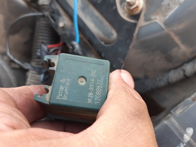

Another relay I had a choice of only one image to load, unlike with your answers to me with multiple pics attached .
Jun 10, 2021 at 10:44 PM
YASIRDAHHAM
  • 186 POSTS

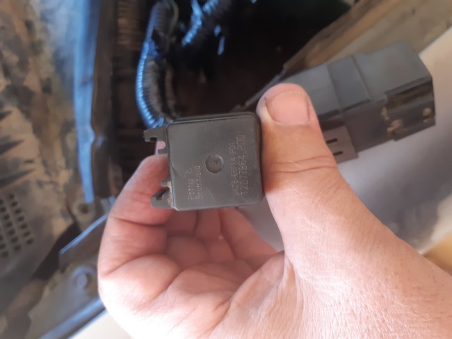

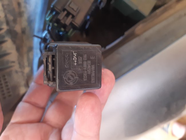

Those were the relays I have as spare parts: The forthcoming 4 images are for what I have right now, two of them are hard to read as you can see. I believe that my problems come from these relays (some of them).
Jun 10, 2021 at 10:56 PM
YASIRDAHHAM
  • 186 POSTS
Second image:
Jun 10, 2021 at 10:58 PM

Third Image:

Fourth Image:

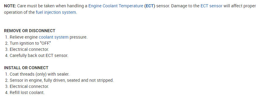

What is meant be "seated but not stripped"? Is it about the wire to never be stripped?
Jun 11, 2021 at 3:46 AM

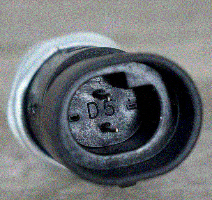

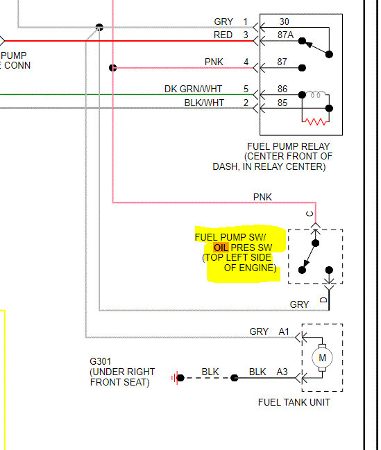

One more question please. regarding this diagram which rang an alternate bell. The illustrated (Fuel Pump Switch/Oil Pressure Sender/Switch) had been giving me a hard time once, the fuel pump would fail to operate but one electrician did cut off one of the three wires attached to the socket of this switch/sender unit, most probably he had an earlier experience with it in the Oldsmobile Cutlass Sierra that had been used in Iraq in lots 2 decades ago. Every time I be replacing the faulty unit there is no response as per the oil pressure gauge, it just shoots at full reading. Lately I bought a brand new one, a bit longer than the original but to my surprise, it still does not give a reading of oil pressure. The car spares dealer blamed it on the instrument panel but I believe that the pressure switch is for a different automobile (Chevrolet or else). Any idea of how to locate the proper switch before buying it? Should it have a marking for pressure or a code may be? Where should its 3 wires go? Anyone to the ECM as your description on the diagram suggests?
Jun 11, 2021 at 3:58 AM
  • 110,251 POSTS
Looking at the schematic, I'm seeing a pink wire and a gray wire to the oil pressure switch. Was one of those wires cut? The original part number for the oil pressure switch is 12635957. If you look up GM part number 12635957, you will find them.
I attached a pic of the connector below showing only two pins, same as schematic. I'm not sure which was cut.
Last, when they say seated and not stripped, they are referring to the sensor. It needs to be fully seated to prevent leakage. However, if you over-tighten it, the threads could strip and create a leak. It's not referring to the wiring.
Let me know if this helps.
Jun 11, 2021 at 2:23 PM
