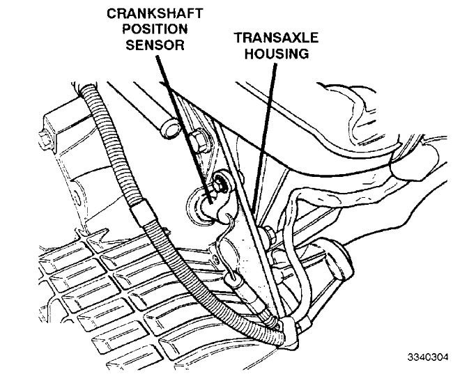

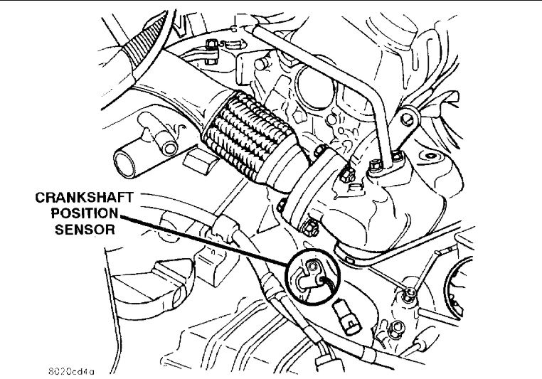

When you crank the engine, does the tachometer move up a little while cranking? It may be the crank sensor that is not sending a signal to the ECM.
REMOVAL
1. Raise and support vehicle.
2. Disconnect crankshaft position sensor electrical connector from the wiring harness connector (Fig. 4).
3. Remove crankshaft position sensor retaining bolt.
4. Pull crankshaft position sensor straight up out of the transaxle housing.

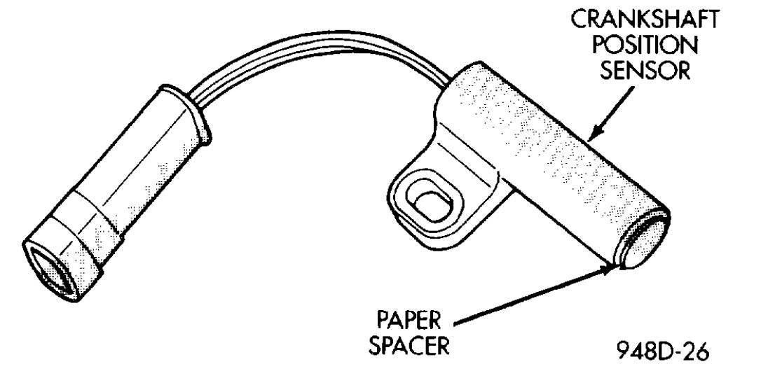

NOTE: If the removed sensor is to be reinstalled, clean off the old spacer on the sensor face. A NEW SPACER must be attached to the sensor face before installation. If the sensor is being replaced, confirm that the paper spacer is attached to the lace of the new sensor (Fig. 5).

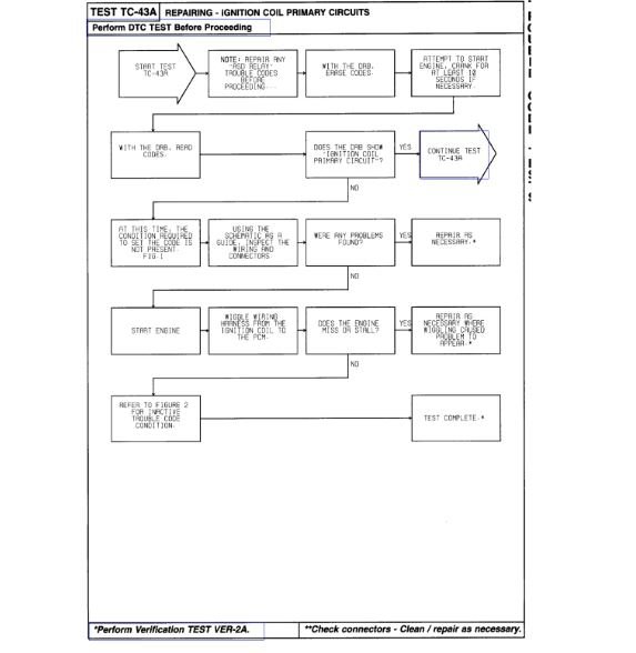

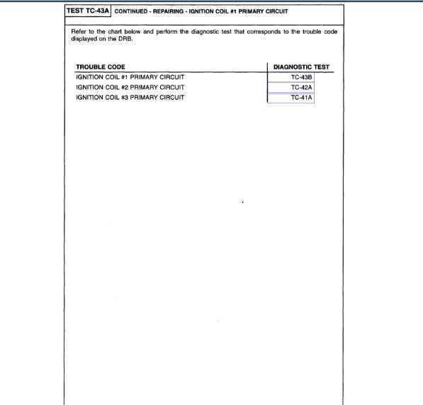

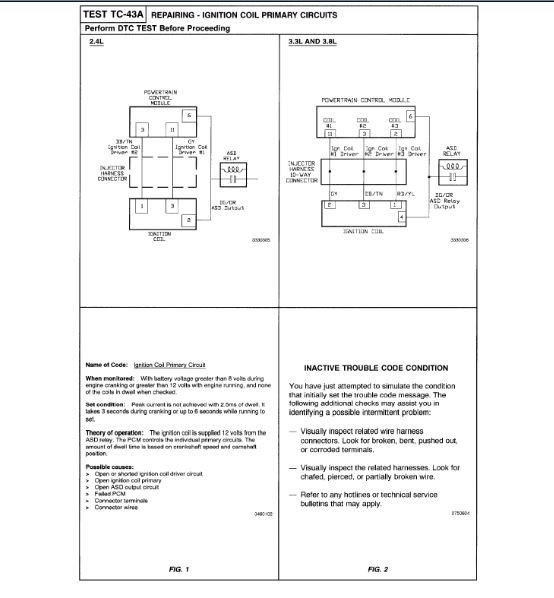

Crank sensor replaced by friend and problem as first time. I am thinking it might be the ECM. I had my scanner give codes P0351, P0352, and P0353. Could I be correct?
Wednesday, June 13th, 2018 AT 5:45 PM
  • 52,797 POSTS
Okay, all three codes are related to the primary circuits for the the coils. I have attached a description and flow chart to determine the failure.
Yes, the PCM is one of the possibilities but at this point is a guess. Guesses are usually wrong and expensive. You need to be sure before replacing.
