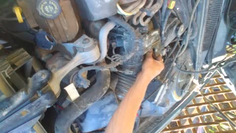

I will not be able to get a new battery for a while, I ran into a new issue just after that video was recorded. My starter is now not making any sounds when I try to turn it on. I took it back off and had it tested and they are saying it is good. I do not have any blown fuses. What could it be?
Thursday, October 4th, 2018 AT 3:45 PM
  • 52,797 POSTS
Low voltage. Jumper pack could be low not giving enough voltage for the starter to work.
Thursday, October 4th, 2018 AT 3:46 PM
MLONG98
  • 79 POSTS
I do not know if it makes a difference, but it is not a jumper pack it is to another vehicle.
Thursday, October 4th, 2018 AT 3:57 PM
  • 52,797 POSTS
Okay, you still need a new battery.

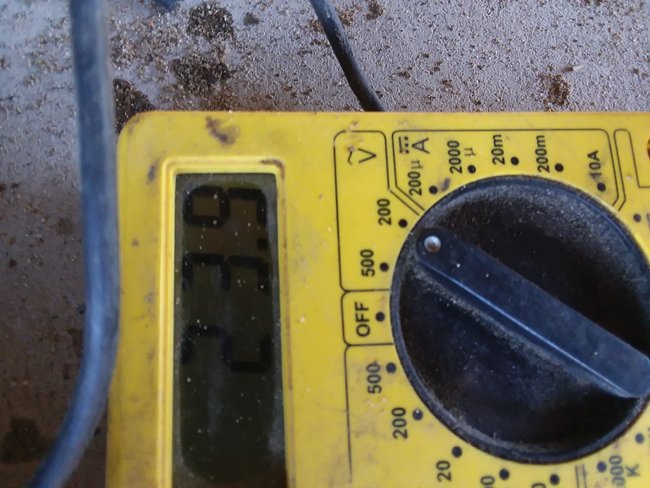

So if the voltage meter is actually working right that I have, there are 27 volts on the hot where the starter connects.
Friday, October 5th, 2018 AT 10:06 AM

You cannot have more than 12 volts in the system unless the alternator is working.
Friday, October 5th, 2018 AT 10:16 AM
MLONG98
  • 79 POSTS
23.9 with the second rig off but still connected to the car.
Friday, October 5th, 2018 AT 10:21 AM
MLONG98
  • 79 POSTS
The car's battery straight off of each post reads 11.9, yet everything on the car is about dead.
Friday, October 5th, 2018 AT 10:24 AM
  • 52,797 POSTS
You are on AC scale. Switch it to DC.
MLONG98
  • 79 POSTS
I have confirmed my voltage meter does not work.
Friday, October 5th, 2018 AT 10:26 AM
