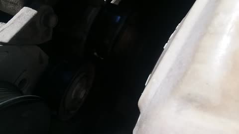

So I think I had an issue with bearings in my harmonic balancer and or my AC pulley from driving through a flood. A few days later my car randomly stalled while in park, when I went to start it acted like a dead battery. I hooked cables up and checked the starter both were fine, but it seems as if the very main bottom crankshaft pulley or whatever is seized. Could that stop my engine from turning over?

Good morning.
To be sure, remove the serpentine belt and see if it will turn. If it does, it is an external issue.
If it does not, then I would remove the spark plugs and check again to see if it will turn. If it does, then the cylinders may have water in them. That may be from the upper intake manifold.
If it does not, then it is locked internally from a bearing. That may be progressive damage from the high water issue.
Did you change the oil/filter after the high water?

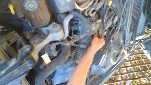

No, I have not changed the oil since, still looks nice and dark. I took the belt off and I noticed that the crankshaft pulley only budges about half an inch every time I try to turn it over. I do not think water could have got into my intake, I went nice and slow. Besides it was like weeks after that it shut off.

If you removed the plugs and the belt and it still will not turn, the engine has seized from a failure in the lower end.
The oil pan will have to be removed and the inspected for the failure.

I would recommend replacing the engine. Even if you found a bad bearing, it needs the crankshaft replaced.

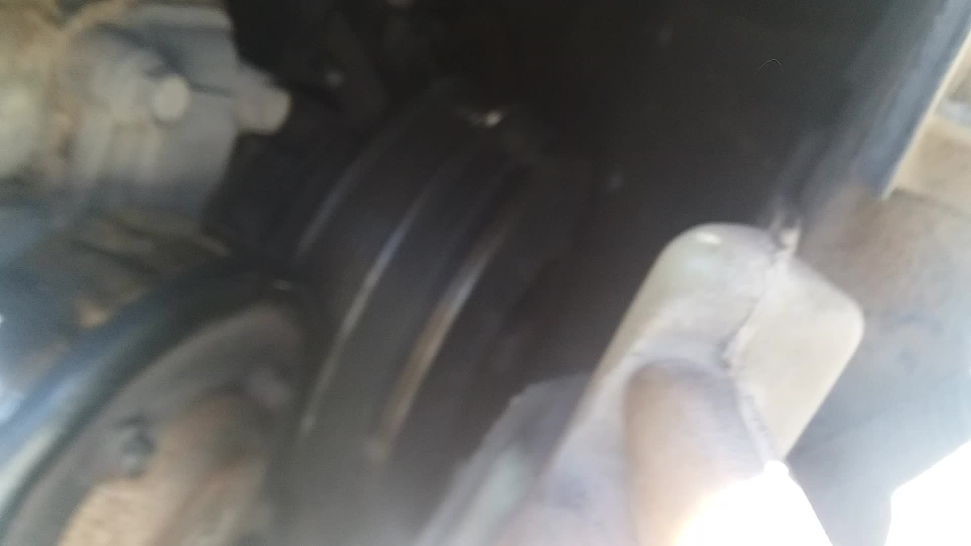

I was reading online and saw that if the crankshaft pulley can move, it is not seized. By hand it is tough but do able, does this change anything?
Oct 4, 2018 at 10:42 AM
Nope, the starter motor has enough power to move the engine over.
You can try a socket and breaker bar and see if you can turn it.

I can turn that sucker round and round by hand, there is like a quarter of the rotation is very hard though.
Oct 4, 2018 at 11:02 AM
Does the starter turn it?
Do you still have the plugs out? It should turn easily if the plugs are out.

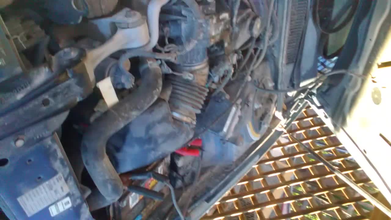

The car does not have a battery, so it is running off jumper cables.
Oct 4, 2018 at 3:21 PM
I would start with a new battery and put the plugs back in. See if it starts.

I will not be able to get a new battery for a while, I ran into a new issue just after that video was recorded. My starter is now not making any sounds when I try to turn it on. I took it back off and had it tested and they are saying it is good. I do not have any blown fuses. What could it be?
Oct 4, 2018 at 3:45 PM
Low voltage. Jumper pack could be low not giving enough voltage for the starter to work.

I do not know if it makes a difference, but it is not a jumper pack it is to another vehicle.
Oct 4, 2018 at 3:57 PM
Okay, you still need a new battery.

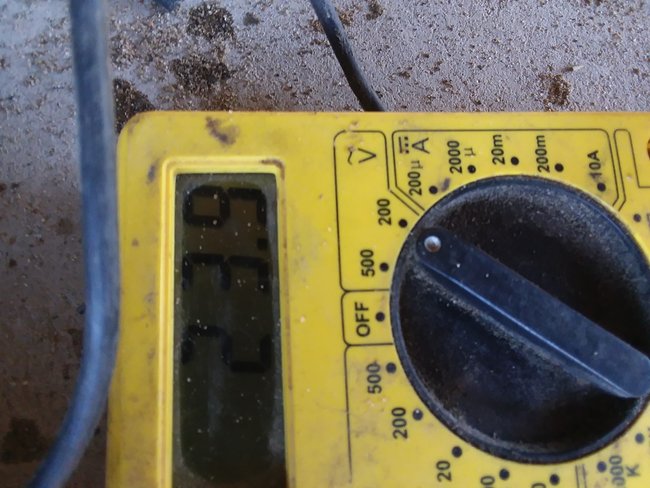

So if the voltage meter is actually working right that I have, there are 27 volts on the hot where the starter connects.

You cannot have more than 12 volts in the system unless the alternator is working.
Oct 5, 2018 at 10:16 AM
MLONG98
  • 79 POSTS
23.9 with the second rig off but still connected to the car.

The car's battery straight off of each post reads 11.9, yet everything on the car is about dead.
Oct 5, 2018 at 10:24 AM
You are on AC scale. Switch it to DC.

I have confirmed my voltage meter does not work.
Oct 5, 2018 at 10:26 AM
Okay, see if you can get one that works.
