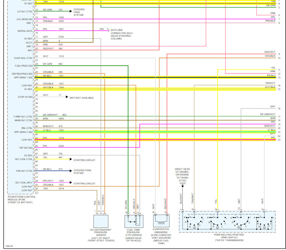

  • 52,797 POSTS
Good morning,

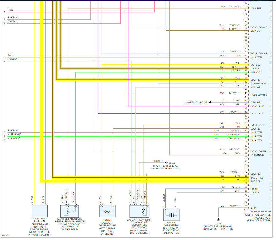

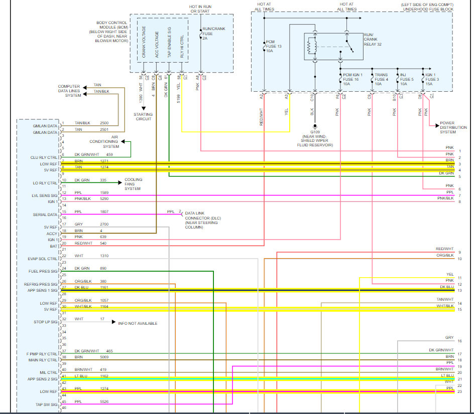

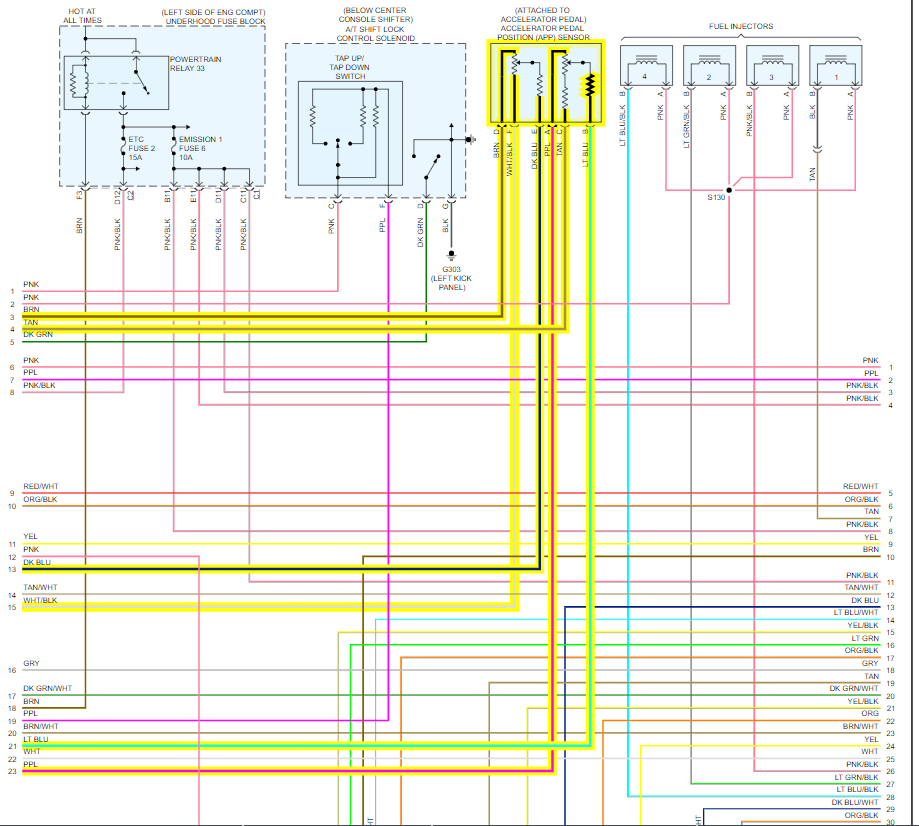

This code be the throttle body or the accelerator pedal sensor that has failed and given you the low power indication.
https://www.2carpros.com/articles/engine-has-low-power-output
I would have the codes checked as it will narrow the area of failure for you.
ACCELERATOR PEDAL POSITION (APP) SENSOR
The accelerator pedal contains 2 individual APP sensors within the assembly. The APP sensors 1 and 2 are potentiometer type sensors each with 3 circuits:
- A 5-volt reference circuit
- A low reference circuit
- A signal circuit
The APP sensors are used to determine the pedal angle. The ECM provides each APP sensor a 5-volt reference circuit and a low reference circuit. The APP sensors provide the ECM with signal voltage proportional to the pedal movement. The APP sensor 1 signal voltage at rest position is near the low reference and increases as the pedal is actuated. The APP sensor 2 signal voltage at rest position is near the 5-volt reference and decreases as the pedal is actuated.
Friday, February 12th, 2021 AT 1:28 PM (Merged)

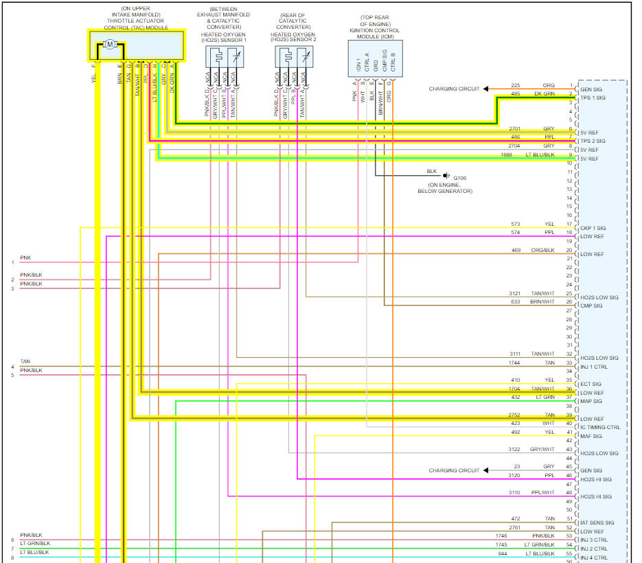

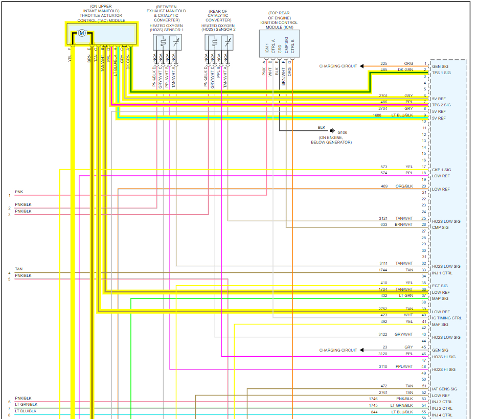

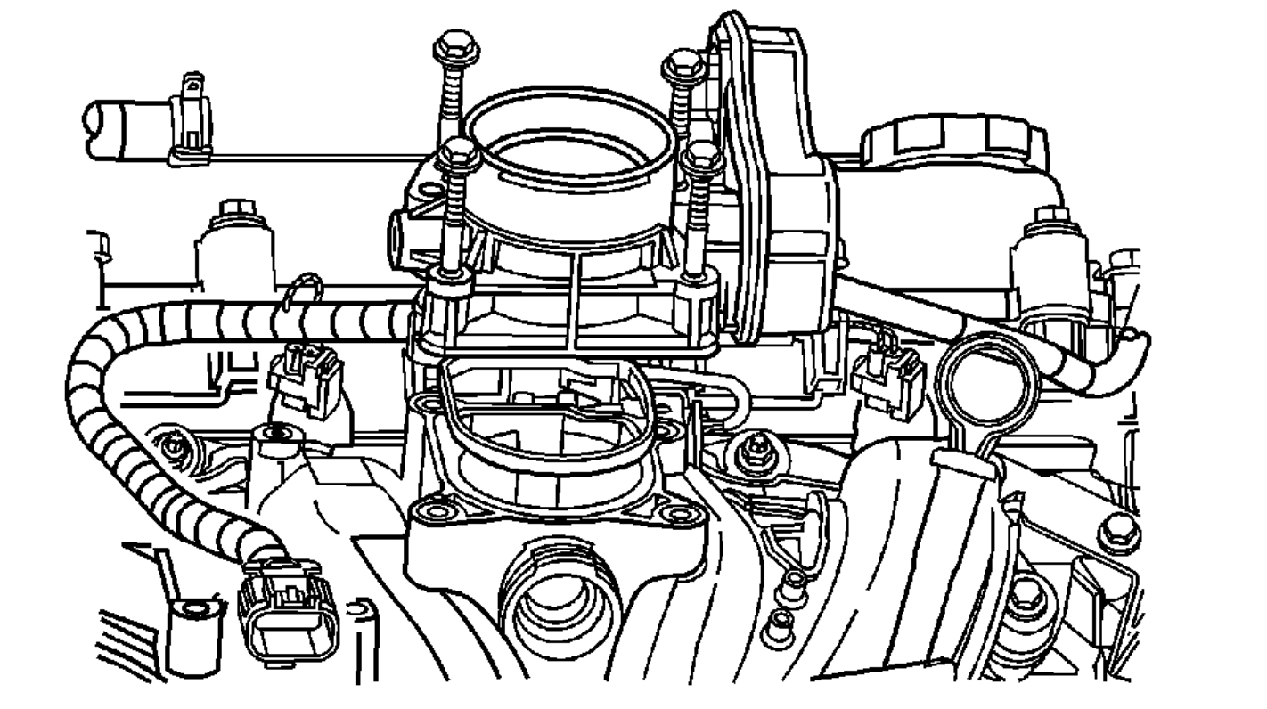

I went to another place to check code again. I did get another code this time along with the P0171 second code is P0068 throttle body.
SATURNTECH9
  • 30,869 POSTS
The p0068 that is your reduced performance mode kicking in. How often does the reduced performance mode kick in? Because the p0068 code has to be active to follow the trouble for P0068 plus you would need a scan tool that can read live engine data as well. I would start by diagnosis that code first and go from there.
CINDY_746
  • 10 POSTS
It just started when I started inquiring about the P0171, but it happened anytime I would try to accelerate like in passing or starting from a stop at a light. We did a cleaning using sea foam then cleaned throttle body with throttle body cleaner and used the air flow cleaner it seems to have worked so far. I took it out on the freeway and it did not loose power after running it for awhile. Seems to accelerate well we did clear codes and did a scan every thing seems to be good. No codes present so far after a good hour drive and excessive acceleration. Hopefully that is all it needed. I would like to say thank you for all your help.
