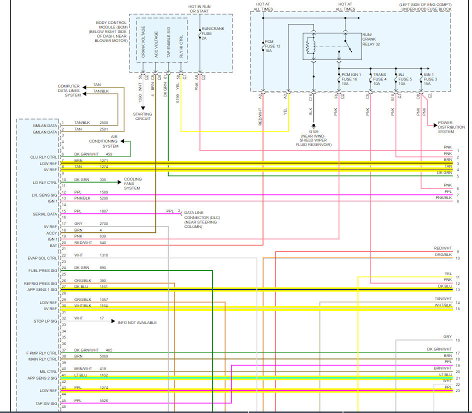

LPRUITT
My car constantly engine power reduces, and on my dashboard it displays ESC off, traction off and engine power reduced. I just replaced my throttle position sensor on my car yesterday, but that did not help. What do I need to do to fix my car? In the winter, lights will flash and then it shut off. One time my car would not even start when it was cold outside.
Feb 12, 2021 at 1:26 PM (Merged)
Good evening,
The reduced power could be caused by the throttle position sensor, the connector, or the pedal sensor.
There is usually a code set for this in the PCM. If I can get this code it will narrow the area of failure.
You can get it checked for free at a parts store.
LPRUITT
I just replaced the throttle position sensor as well as the pedal.
Okay, the next step is to check the voltages at both the throttle position sensor as well as the pedal sensor.
Do you have a voltmeter to do some checks?

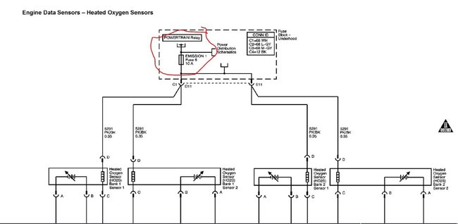

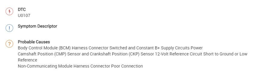

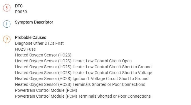

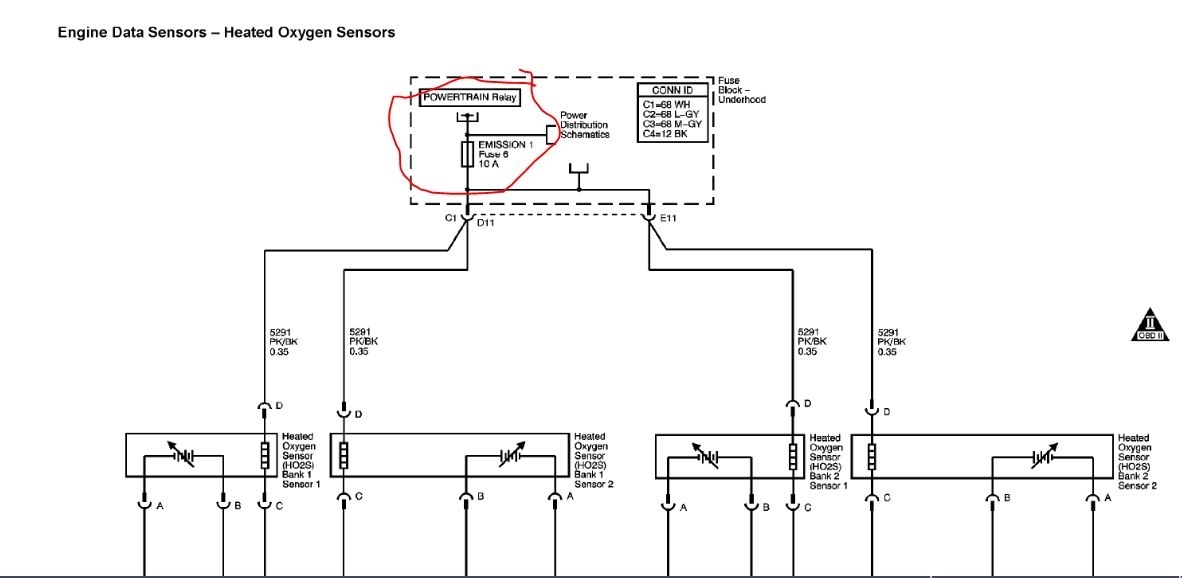

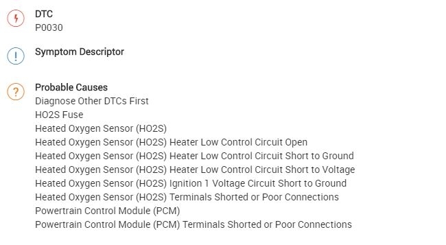

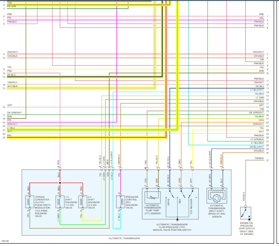

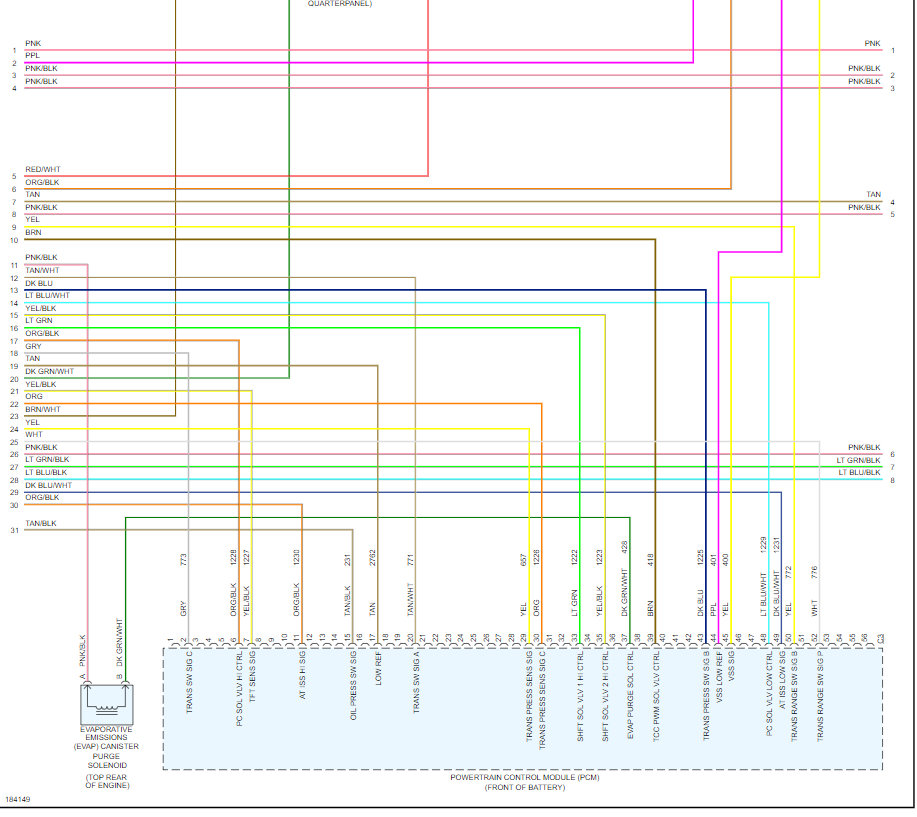

DAVID SEBASTIAN KILGORE
Went into limp mode. Codes poo3o, poo36. Code poo5o, poo56, Po 443, uo 1o7, and traction control is on.
Good morning,
I attached a guide for the limp mode for you to view.
https://www.2carpros.com/articles/reduced-power-limp-mode

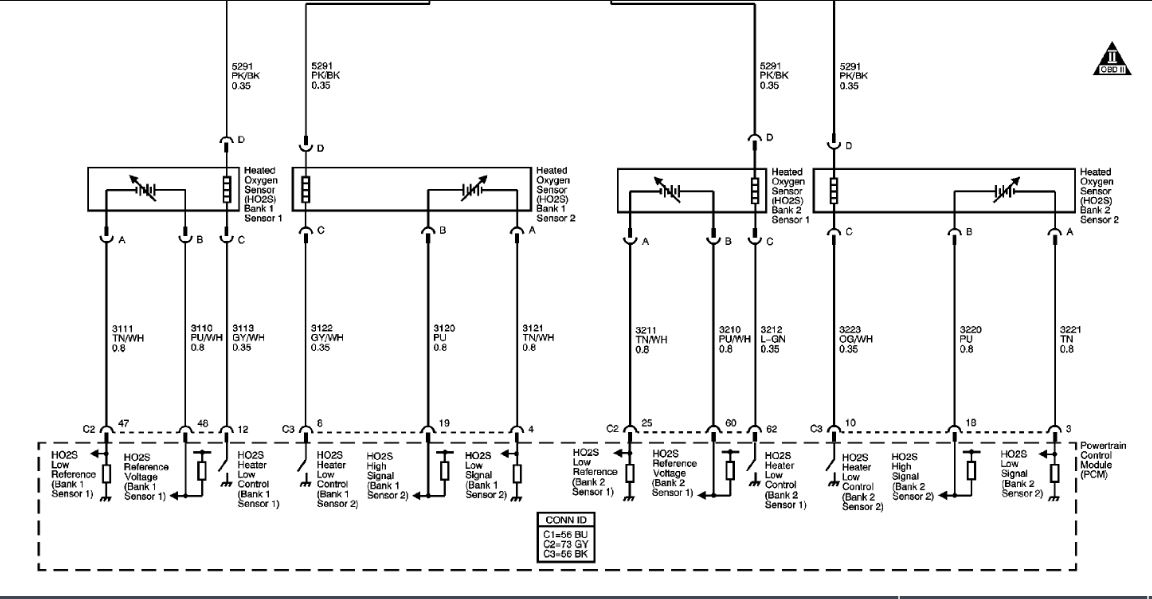

The 30,36,50 and 56 are the same for no voltage to the O2 sensor heaters.
There is a power issue to the O2 sensors and we need to do some voltage testing.
Let me know when you can do the testing so we can find the issues.

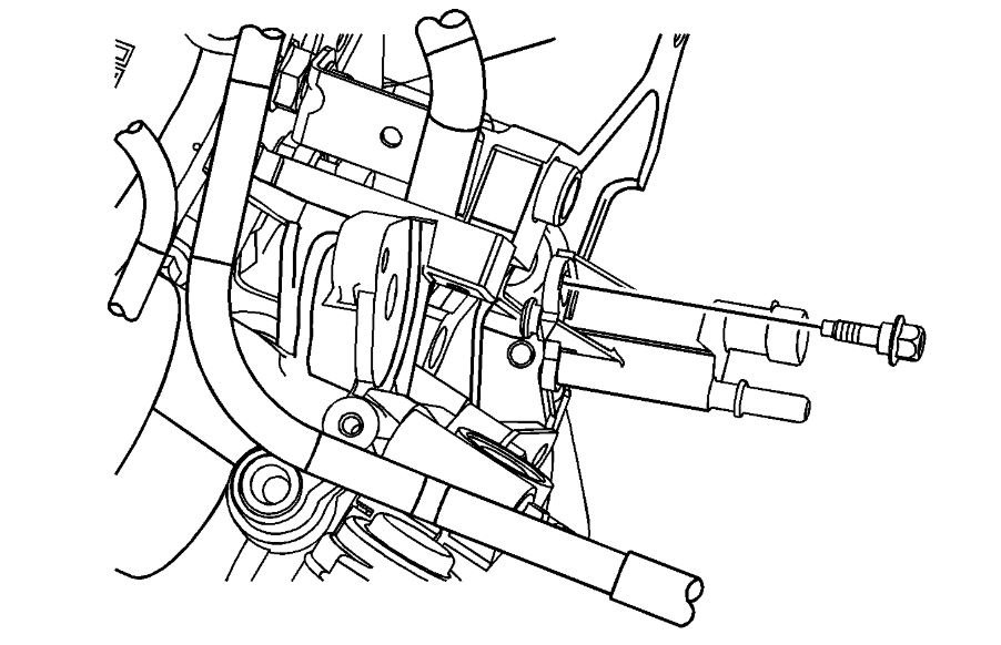

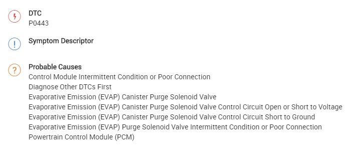

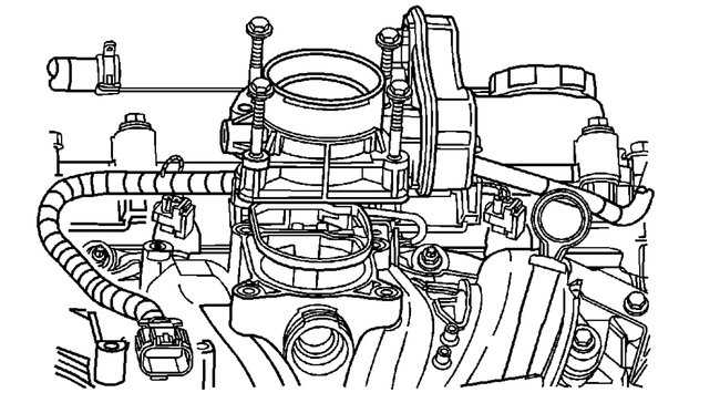

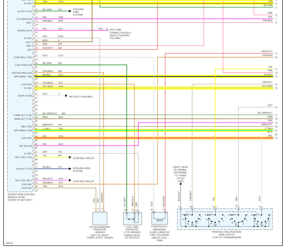

The 107 is for the purge valve for the evaporative system. I attached the procedure and a picture for you.
EVAPORATIVE EMISSION (EVAP) CANISTER PURGE SOLENOID VALVE REPLACEMENT
REMOVAL PROCEDURE
1. Disconnect the evaporative emission (EVAP) canister purge valve electrical connector.
2. Disconnect the EVAP canister purge pipe from the EVAP canister purge valve.
3. Remove the EVAP canister purge valve bolt.
4. Remove the EVAP canister purge valve from the intake manifold.
INSTALLATION PROCEDURE
1. Position the EVAP canister purge valve to the intake manifold.
2. Install the EVAP canister purge valve bolt.
NOTE: Refer to Fastener Notice in Service Precautions.
Tighten the bolt to 10 N.m (89 lb in).
3. Connect the EVAP canister purge pipe to the EVAP canister purge valve.
4. Connect the EVAP canister purge valve electrical connector.
Cleaned the throttle body, was nasty, but didn't help. Replaced the power train relay. Problem gone for now.

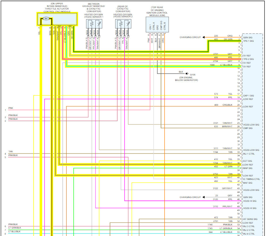

DRBOYD68
I had the message "Engine power reduced" and the car started vibrating. I tried to start it the next day but it won't start. Please tell me what is wrong with my car. I can't really afford a costly repair.
Feb 12, 2021 at 1:28 PM (Merged)
CINDY_746
  • 10 POSTS
Thank you for clearing that up for me. I was going by the print out they gave me with the code and symptoms.

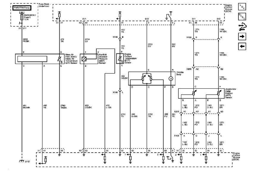

Good morning,
This code be the throttle body or the accelerator pedal sensor that has failed and given you the low power indication.
https://www.2carpros.com/articles/engine-has-low-power-output
I would have the codes checked as it will narrow the area of failure for you.

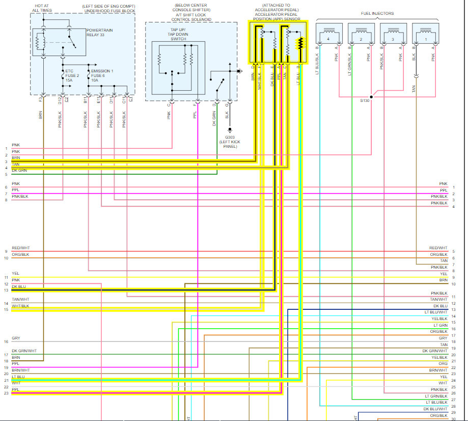

ACCELERATOR PEDAL POSITION (APP) SENSOR
The accelerator pedal contains 2 individual APP sensors within the assembly. The APP sensors 1 and 2 are potentiometer type sensors each with 3 circuits:
- A 5-volt reference circuit
- A low reference circuit
- A signal circuit
The APP sensors are used to determine the pedal angle. The ECM provides each APP sensor a 5-volt reference circuit and a low reference circuit. The APP sensors provide the ECM with signal voltage proportional to the pedal movement. The APP sensor 1 signal voltage at rest position is near the low reference and increases as the pedal is actuated. The APP sensor 2 signal voltage at rest position is near the 5-volt reference and decreases as the pedal is actuated.
