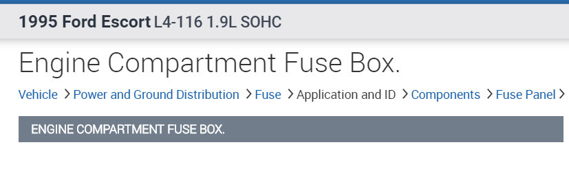

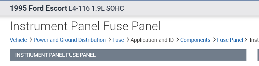

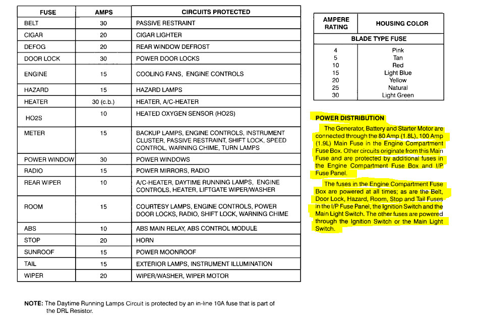

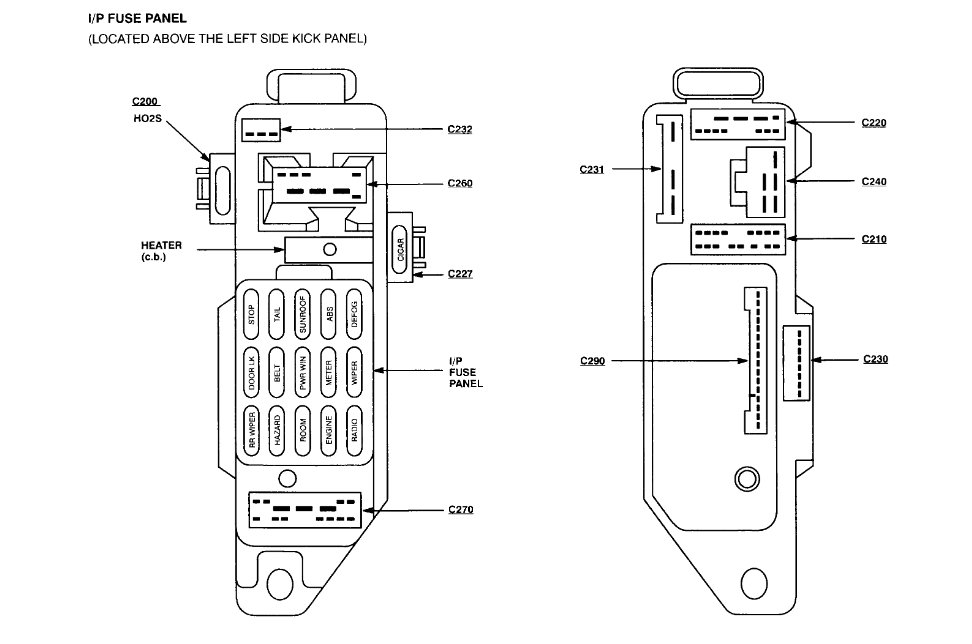

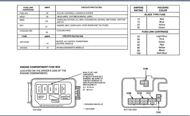

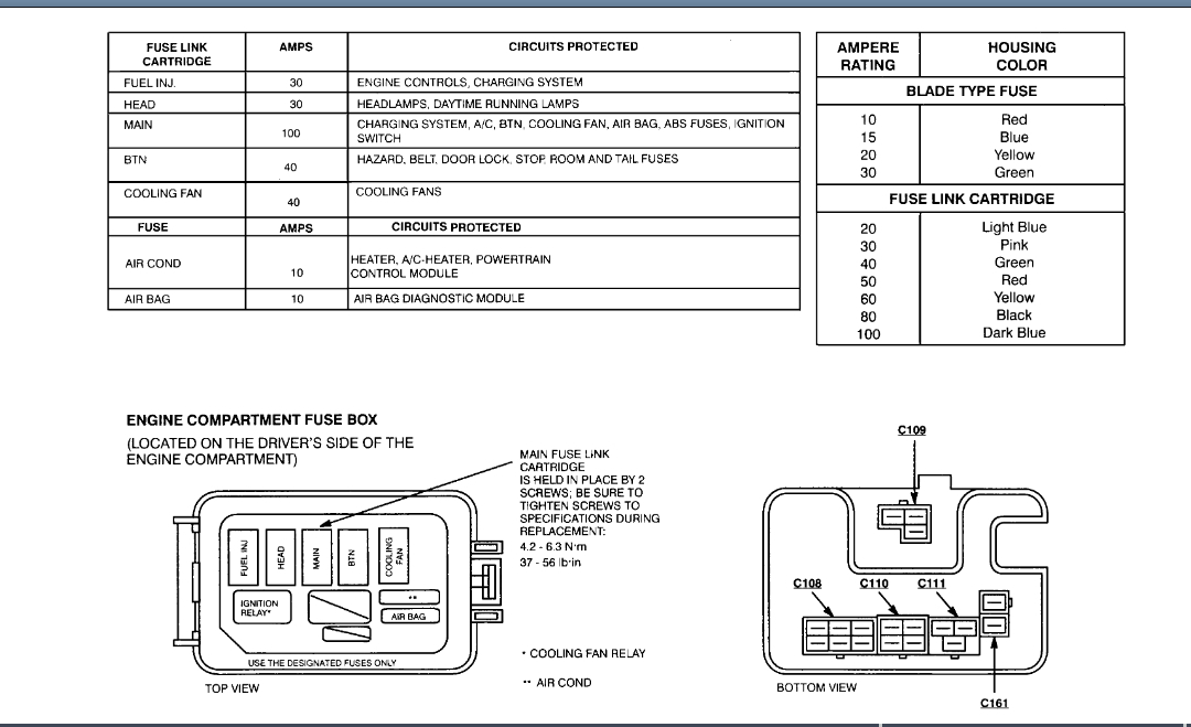

I would check the Main Fuse [100A] in the Engine Compartment Fuse Box. This is the fuse that protects the charging circuit from a short to ground, which is what happened when you hooked up the jumper wires backwards. In the diagrams down below I have included diagrams with the layout and callout of the Engine Compartment Fuse Box and the Instrument Panel Fuse Panel for your vehicle. Here is a link explaining how to check a fuse below, if needed:
Please go through these guides and get back to us with what you are able to find out.

I want to start off by saying thank you for replying to my problem. It is my daughter's first car and she is in a hurry, lol. I am sorry, I did leave that part out the main fuse did blow was a 100 amper after that still nothing.
