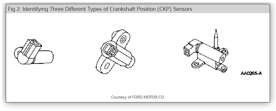

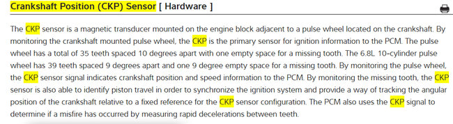

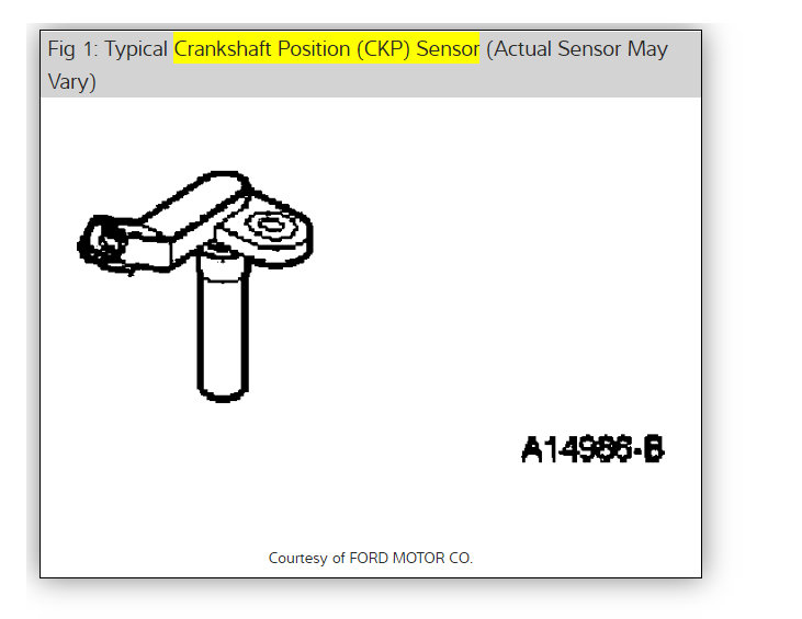

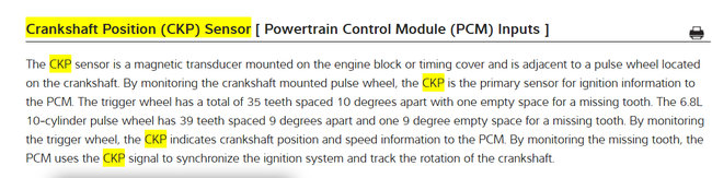

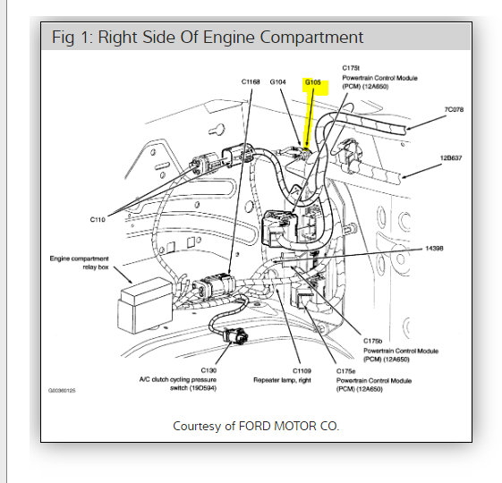

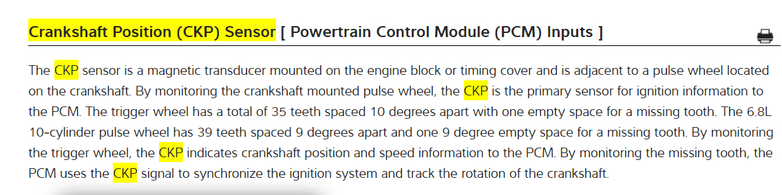

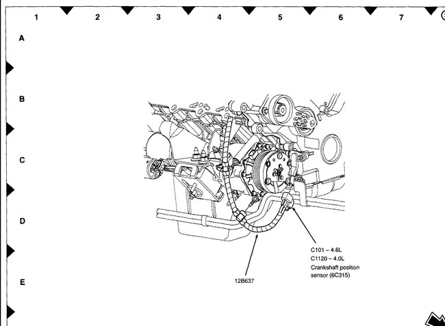

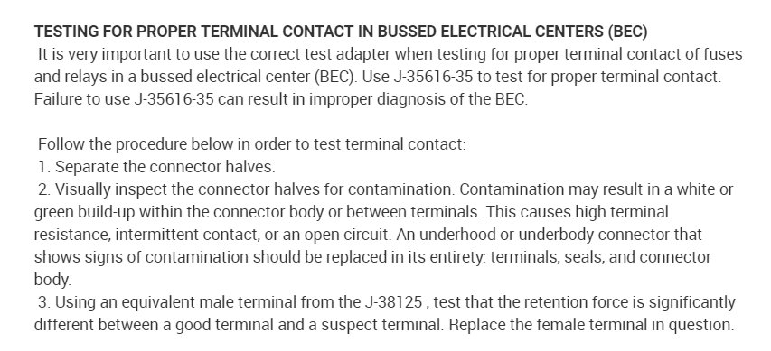

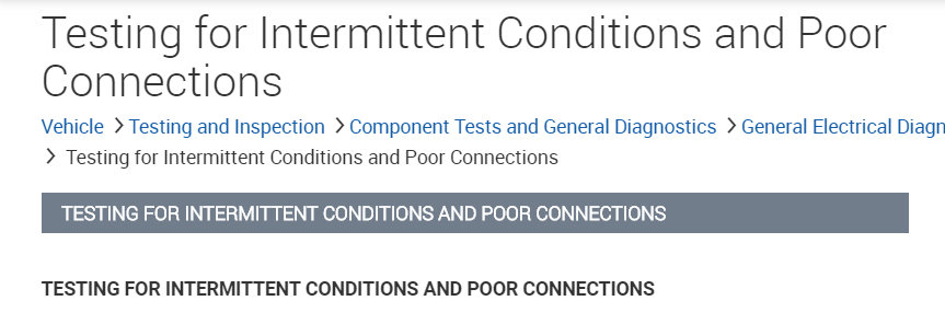

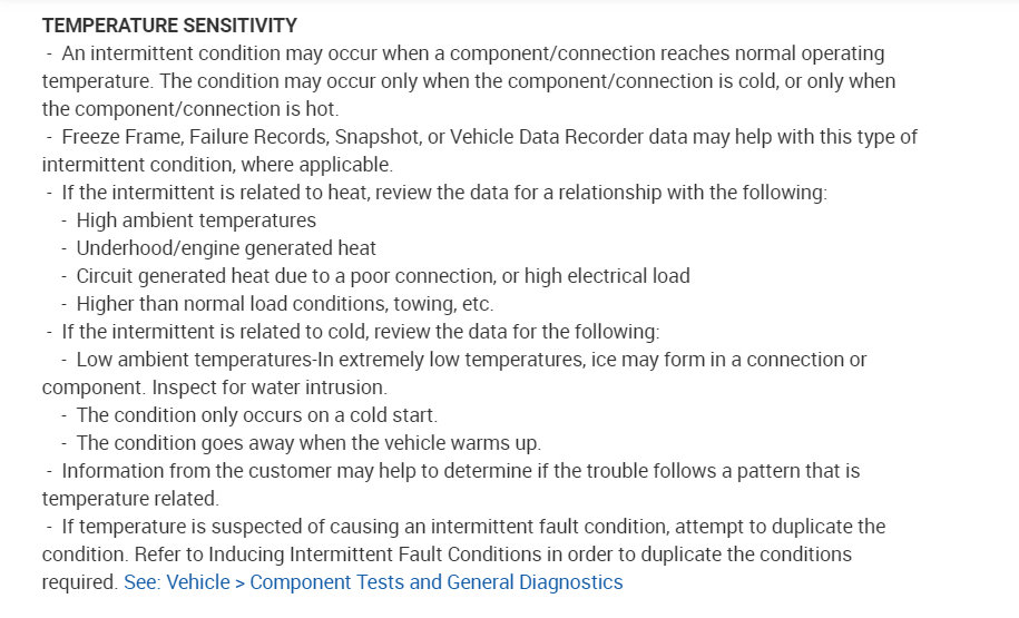

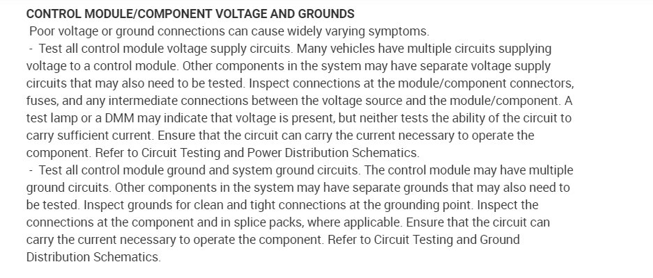

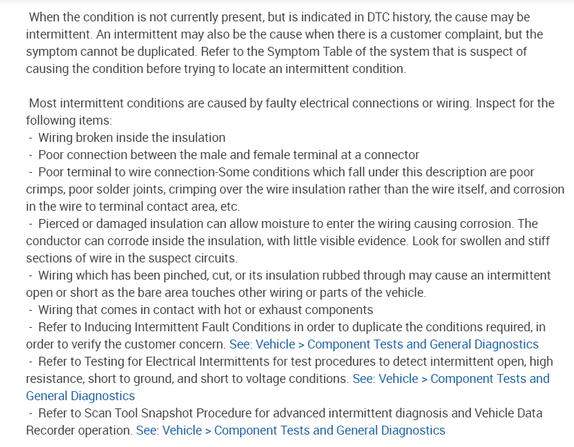

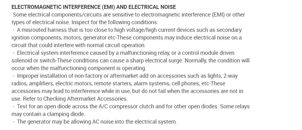

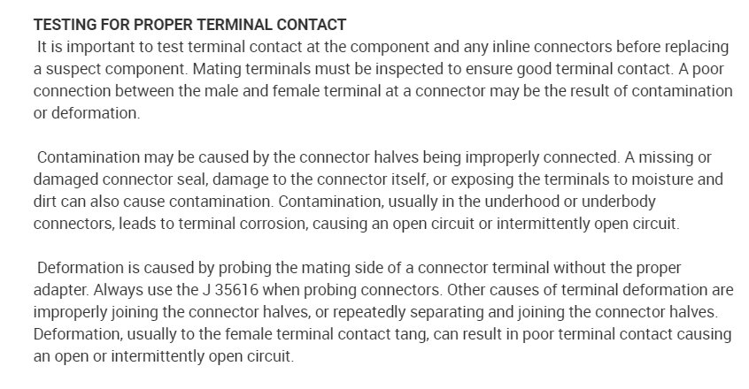

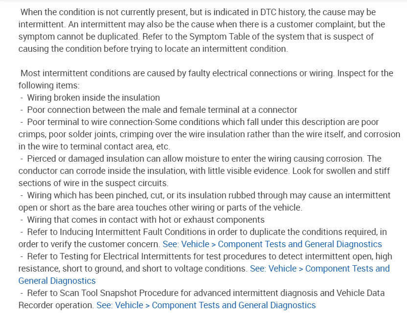

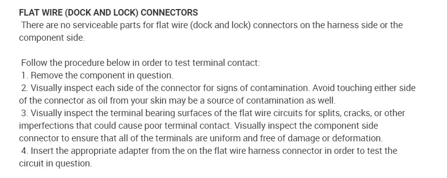

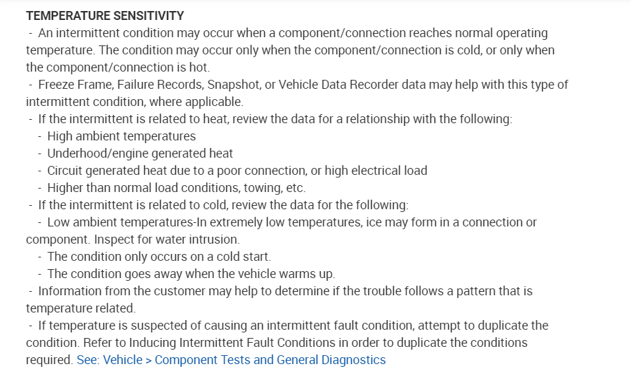

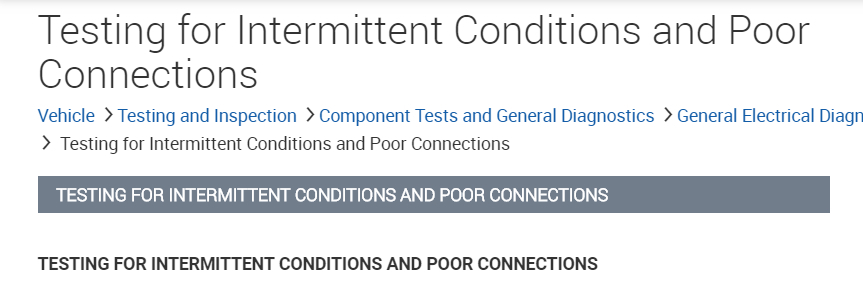

I have checked for any recalls or Technical Service Bulletins for anything regarding this problem and didn't find anything. A problem like this could be caused by a wide variety of things, so all I can really do here is attempt to point you in the right direction and go from there. So this could be an intermittent problem with the Crankshaft Position Sensor(CKP) or the electrical connector or loose wires from the CKP to the Power-train Control Module(PCM) or "computer". In the diagrams down below I have included a description of the CKP sensor, a wiring diagram of the CKP circuit, the location of the ground wire for the RF shielding, and a guide for tracking down poor electrical connectors and intermittent problems in an automotive electrical circuit for you to go through. Please go through these guides and check the CKP circuit for an intermittent problem and get back to us with what you are able to find out. We can go from there.
Thanks,
Alex

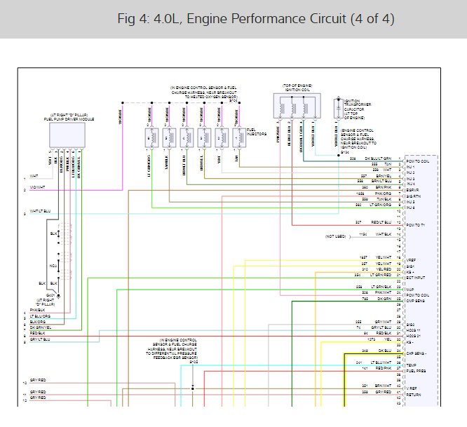

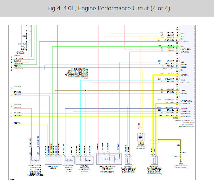

Alex, I started looking at the schematic images you posted (I have electrical experience), I went to zoom on them so I could read the writing but the resolution is kind of bad. Any chance the wiring images could be of higher resolution?
Thanks- Tom

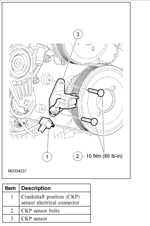

Okay, I located the CKP. The harmonic balancer was repaired a few years ago if that matters. The sensor is very greasy since there is a slow oil seepage from one of the bearings on the engine front. I could not easily get to the wires of the sensor, it is harder to access than expected (no lift, ramps, etc). Would the failure that caused the engine to stop show in the error codes? I think I can read them or I would get a parts store to do that.

This type of failure should throw a Direct rouble Code(DTC), but not always. If you have a code reader it should be fairly straight forward on pulling the codes. Here is a link explaining how to do that:

Thanks Alex, I guess I`m back to square one. I`m going to examine again getting at the CKP but it seems in a tight spot, it will be hard to determine an intermittent electrical connection with little room to work. If I knew the CKP was the problem I`d really go after it.

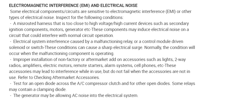

Bad alternator diodes can induce noise in the system and corrupt the crank sensor signal. Have replaced tons of alternators for this at my dealership,most of the time with no codes present or a code in continuous memory with no light on.

Thanks BMDOUBLE... I replaced the alternator last fall, got a cheap one from China through ebay. Is the source of significant concern? Does it really make much difference?
Sep 14, 2019 at 5:24 PM
SCGRANTURISMO
  • 4,897 POSTS
Actually, yes it does. hat old adage you get what you pay for. It is as true today is it has ever been. I would stick to Motorcraft (Ford), Delco, Denso, Bosch, or manufacturers of this caliber for replacement parts. There is a reason that vehicle manufacturers sub contract to companies like these for parts such as OEM fuel injectors, O2 sensors, and others. BM Double is very knowledgeable when it comes to the Ford Brand so you might want to check into this and get back to us with what you find out, please.

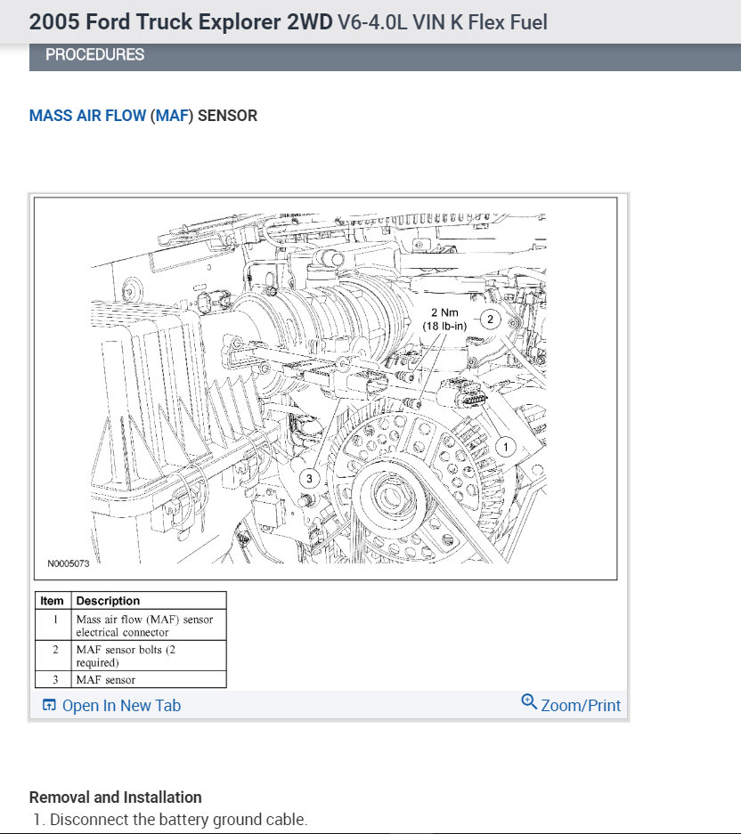

We just had this problem on the site with a similar car the person ended up replacing the MAF sensor which fixed the problem. The sensor can short intermittently causing the problem which makes sense it was okay for a while once the alternator was replaced. Here is the sensor location. Check out the diagrams (below). Please let us know what happens.

Thanks for the suggestion to replace the MAF. It looks like an easy part replacement so I have ordered an exact replacement part that should arrive in a few days. The issue with the car has been frustrating and if the part fixes the problem it will take a while to know and some apprehensive driving wondering if the car is going to suddenly stop. I will definitely update with what happens.

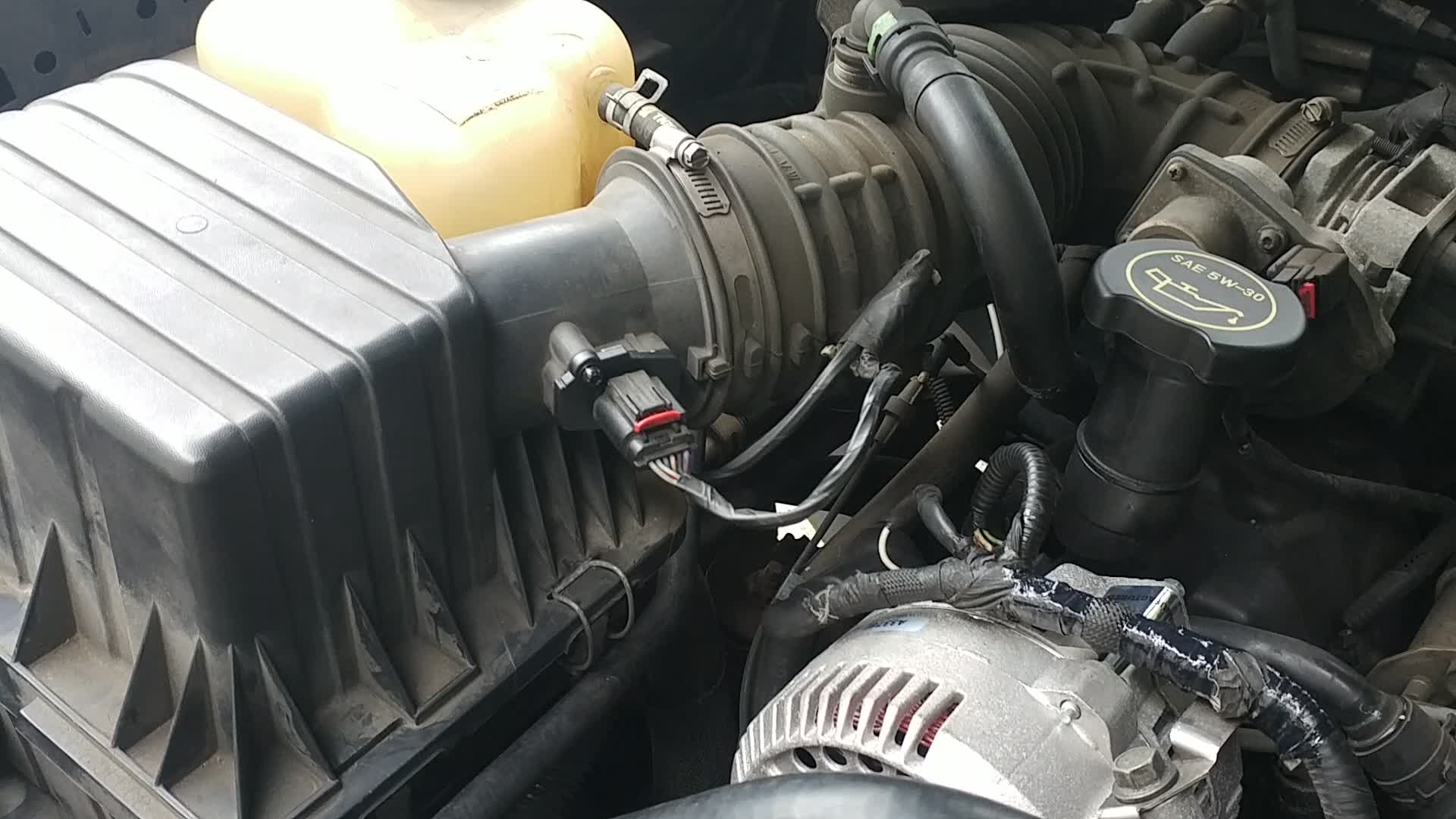

TECH2020
  • 41 POSTS
Okay..
I`ve replaced the MAF sensor and I will report back on how the car does regarding sudden stopping.

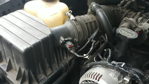

One question, I noticed that someone left the air intake box top section out of place, and one of the clamps is missing a piece. I placed the air intake box top section back into place over the bottom (holds the air filter) and I`m using the one clamp. Could having the air intake being (partially) unfiltered caused an issue with the MAF sensor? I will look to replace/repair the bad clamp.
Tom
Jun 29, 2020 at 4:03 AM
  • 55,387 POSTS
That will cause the sensor to go bad yes because of too many contaminates. Can you please shoot a quick video with your phone so we can see what's going on? that would be great. You can upload it here with your response.
Jun 30, 2020 at 4:25 AM
TECH2020
  • 41 POSTS
Okay, here is a video of my car and air box. I guess I should always look the car over after a repair. It starts fine and all seems Okay, should I get the air box clamp before driving it any? It still closes fairly well with just the one clamp. Seems I will need to find this part online or in a salvage yard.
Jun 30, 2020 at 7:49 AM
BMDOUBLE
  • 1,139 POSTS
Go to your local salvage yard, preferably a pick-n-pull because it's cheaper, and get you an air-box. I've actually had several explorers with a stalls at idle concern be cause by a loose air-box because the air from the fan will blow into the box and passed the sensor causing an incorrect voltage reading and thus overestimation of what is actually going on. But I don't think that is what is causing your original concern, and don't buy another MAF sensor, my opinion but it should be fine. I would retest the charging system on the vehicle with a good charging system tester like a vat-45 or equivalent, so you can get a reading for the diode test pass/fail. Also a very thorough wiggle test of the wire harness near the power-train control module and also around the battery cables, have had issues there as well. Just a few picks from my mental Rolodex for ya, hope it helps!
Jul 1, 2020 at 1:32 AM
