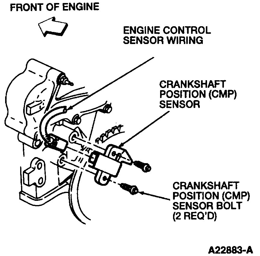

My engine cuts off while slowing down after the car is accelerating. When I pump the gas there is no response. The car acts as if it is not getting any gas. But when the car is in idle the car runs without any missing or any signs of fuel pump problems. What could cause the car to cut off or lose gas when slowing down?
Apr 11, 2010 at 12:42 PM
  • 110,248 POSTS
This sounds like a classic crankshaft angle sensor. Here is a guide to help you see what you are in for when doing the job and diagrams below to help you find the sensor location on your car:
Cheers, Joe
Apr 11, 2010 at 10:35 PM
ED0540
Perfect it worked great! I found the sensor on Amazon for $46.00 and replaced it all good. I love this site. Thank you so very much.

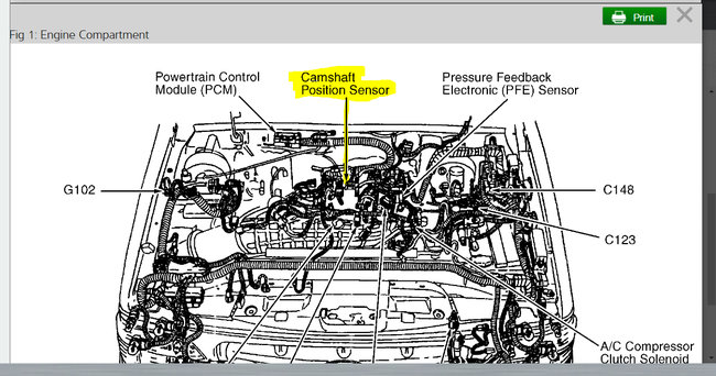

It sounds like you have a couple different things happen. When you say it stalls when driving and then won't restart for some time, I suspect a crankshaft position sensor is going bad. Take a look through these links and let me know if the symptoms mentioned mirror what you are experiencing.
https://www.2carpros.com/articles/how-a-crank-shaft-angle-sensor-works.
If you feel this is the issue, I attached a picture of the sensor on your vehicle. It is located front center of the engine.

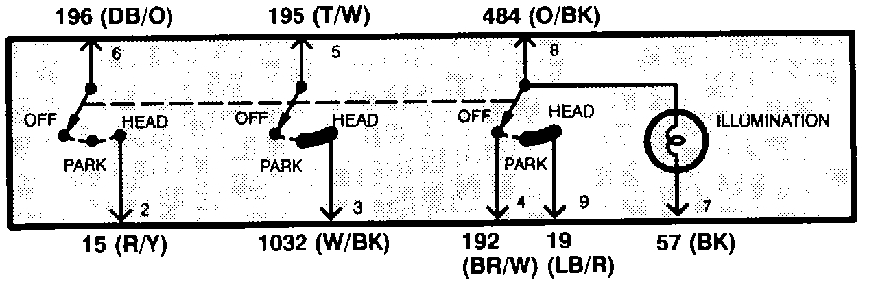

MIKE DUFRESNE

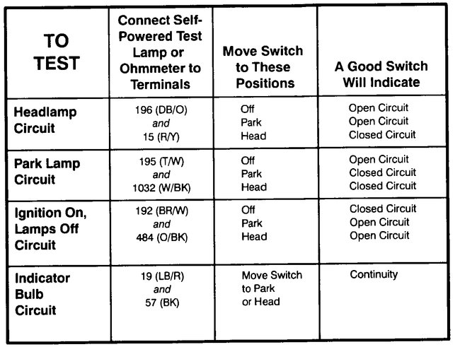

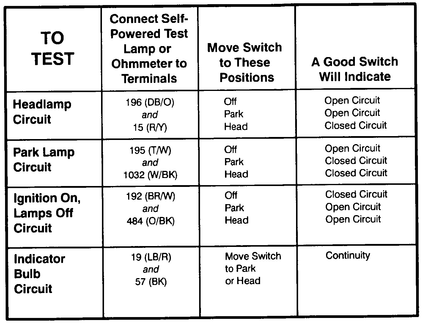

The electrical issue is I turned the lights on one morning and the dashboard lights went out. I thought it might be a fuse, but it's not. All the other lights are working, dome, radio, glove box, interior lights and head lights just no dash board lights and no running lights in front or back. No fuses are blown. Have changed light bulbs in rear and still no running lights.
Oct 9, 2020 at 4:33 AM (Merged)

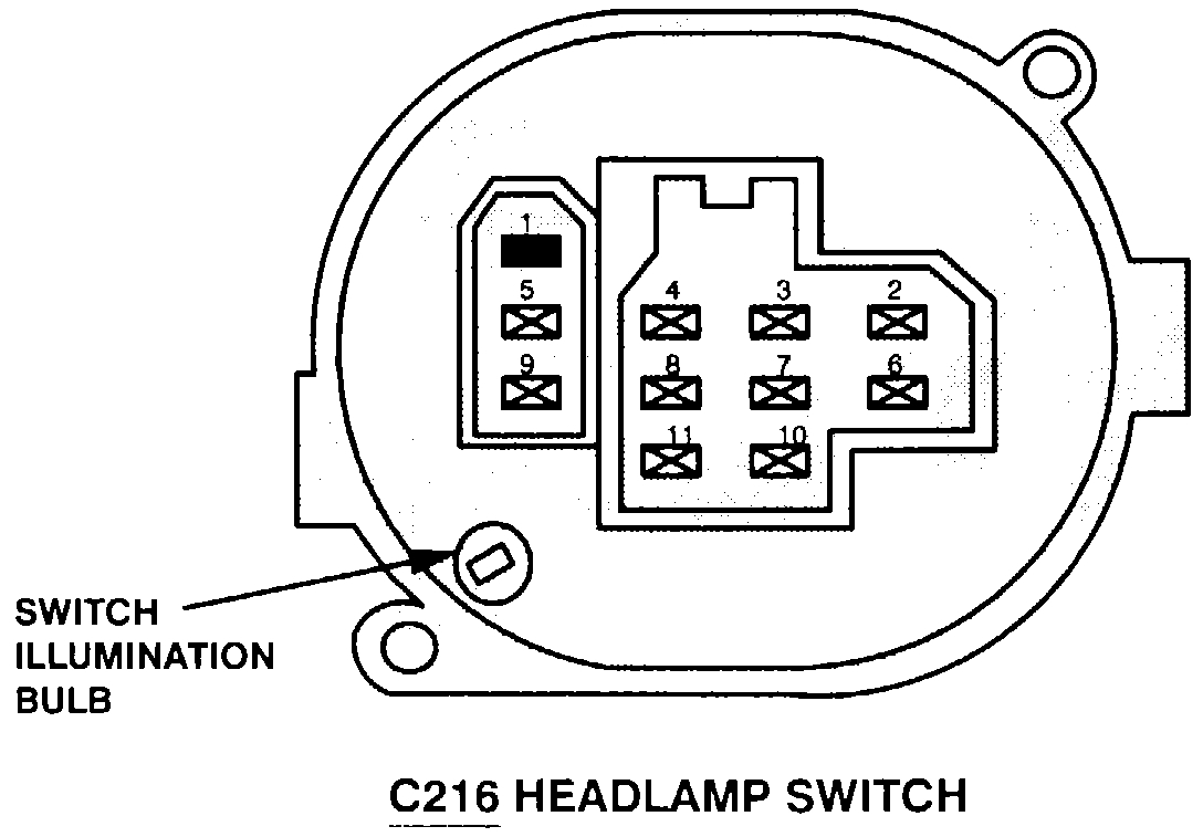

  • 110,248 POSTS
Welcome back:

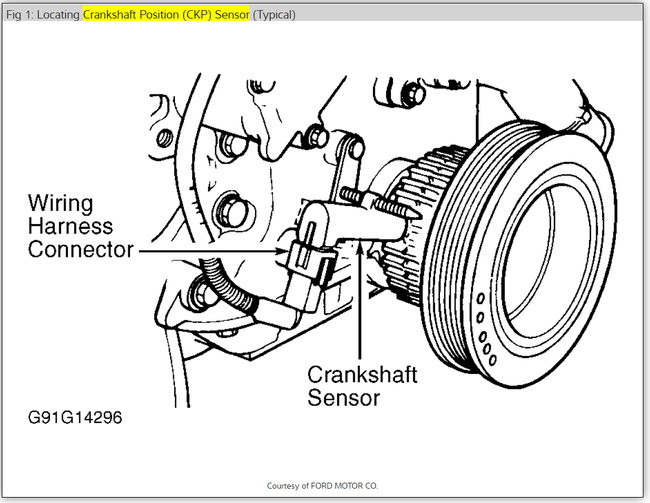

That sounds like the switch itself has failed. Take a look through the attached pics. They show how to test the switch. You will need to remove the switch to check and have use of a multi meter.
Here are a couple links you may find helpful:
If you look through the first three pics below, they provide the test procedures for the switch. If you are not sure about something, feel free to let me know.
_________________________

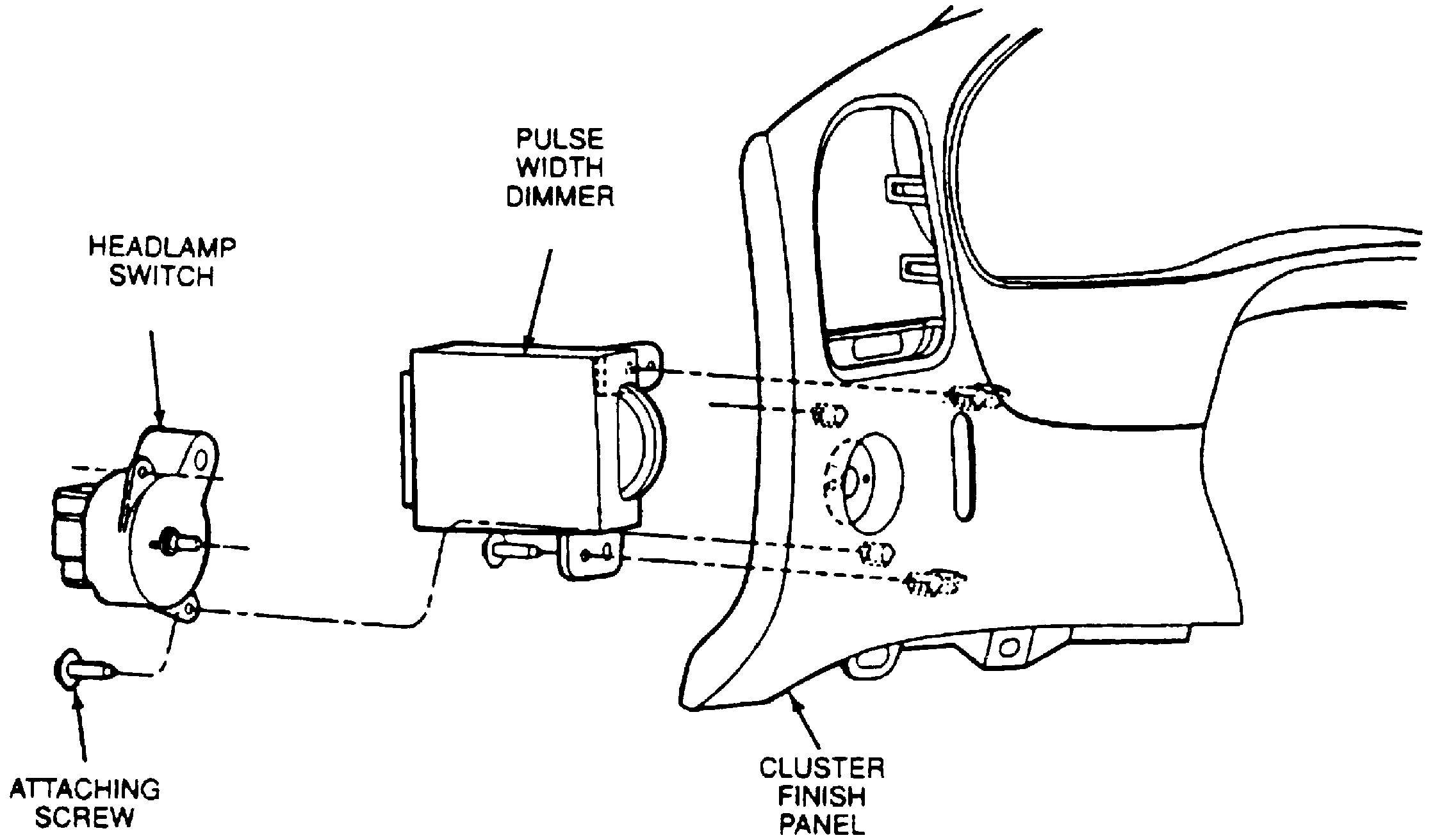

Here are the directions for removal of the switch:
1996 Ford Truck Explorer 4WD V6-245 4.0L
Procedures
Vehicle Sensors and Switches Sensors and Switches - Lighting and Horns Headlamp Switch Service and Repair Procedures
PROCEDURES
1. Disconnect battery ground cable.
2. Remove instrument cluster finish panel.
Fig. 8 Headlamp Switch Replacement
See pic 4
3. Remove attaching screws and switch from cluster finish panel, Fig. 8.
4. Reverse procedure to install.
__________________________
Let me know what you find, if you have questions, or need help.

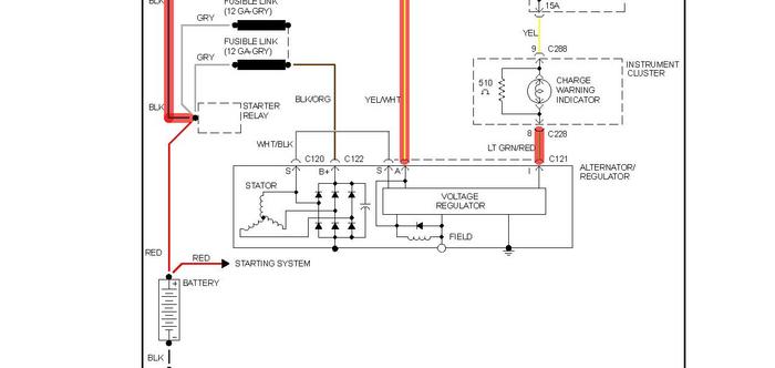

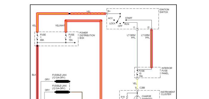

  • 75,988 POSTS
You started a big war I was going to cut it short due to circumstances-But No-you choose to send it to the grave-lol
Here's your Charge System-EWD now you can test it
