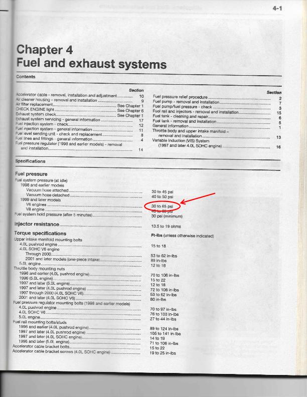

While driving, when I press down on gas, sometimes it doesn't respond.. It goes dead for a sec, then will catch and run fine for 5-15min at a time. Sometimes it seems to stall out more often on a hill. I'm leaning towards something in the fuel system, or a vacuum leak???
I had a used motor put in last year after I left water as coolant through the winter time. Ran fine for a while, now it hesitates and stalls out intermittently. I have no OBD codes. I have replaced EGR valve, IAC valve, Intake Manifold gaskets, TPS, MAF sensor, power steering pump. Alternator and battery are good.

check fuel pressure with a gauge should be 57-63 psi key on only. These guides can help us fix it

I appreciate your response, I currently have the engine taken apart, but I seem to remember checking my fuel pressure with key on around 30 psi. According to my Haynes Manual, it should be in the range 30-65 psi.
I will test again and get back to you when I get it all back together again.

I don't think Haynes is correct it's 57-73 I made an error first time. key on only

Thanks! the guides really helped me figure out the fuel pump has bad, got a new one running great!
